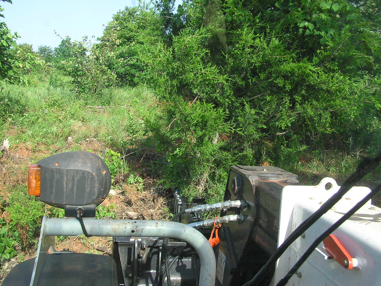

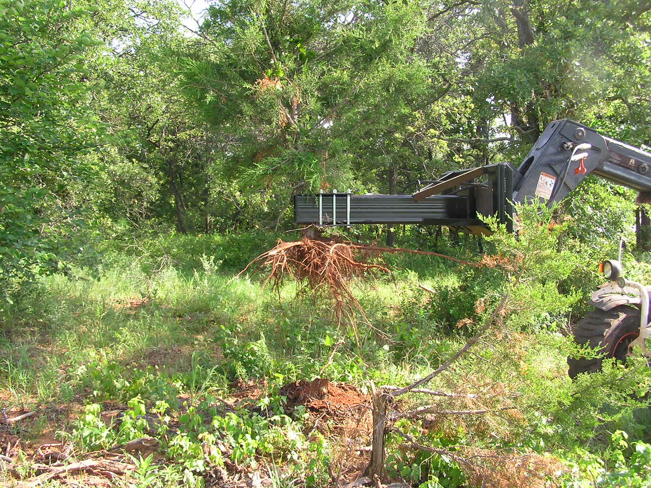

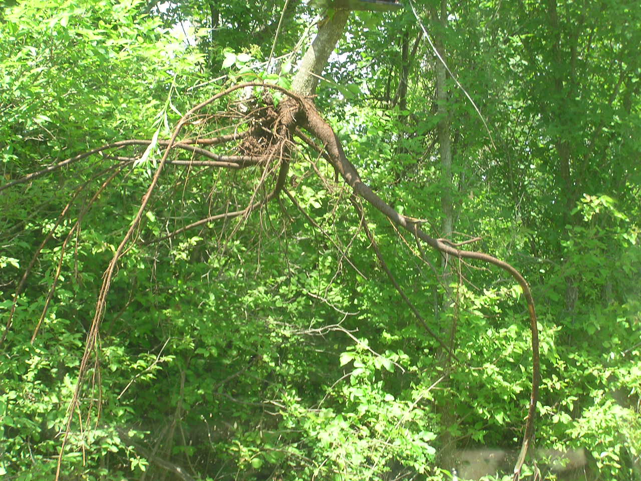

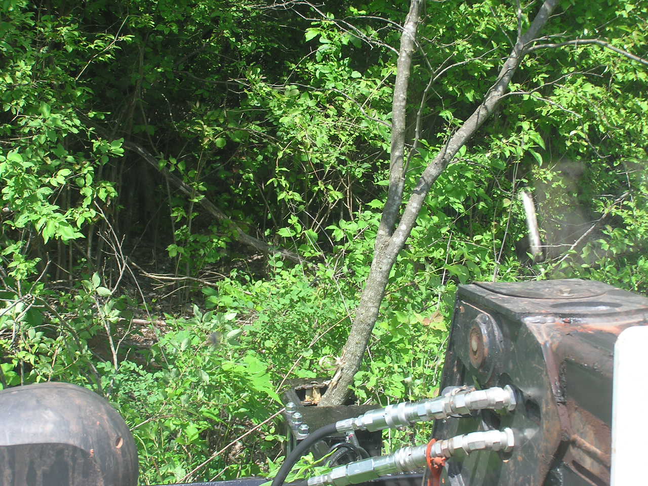

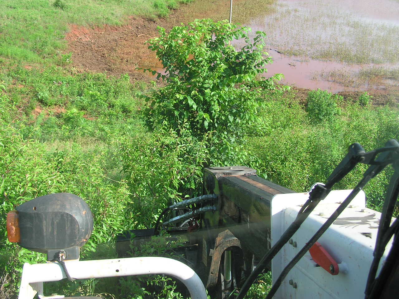

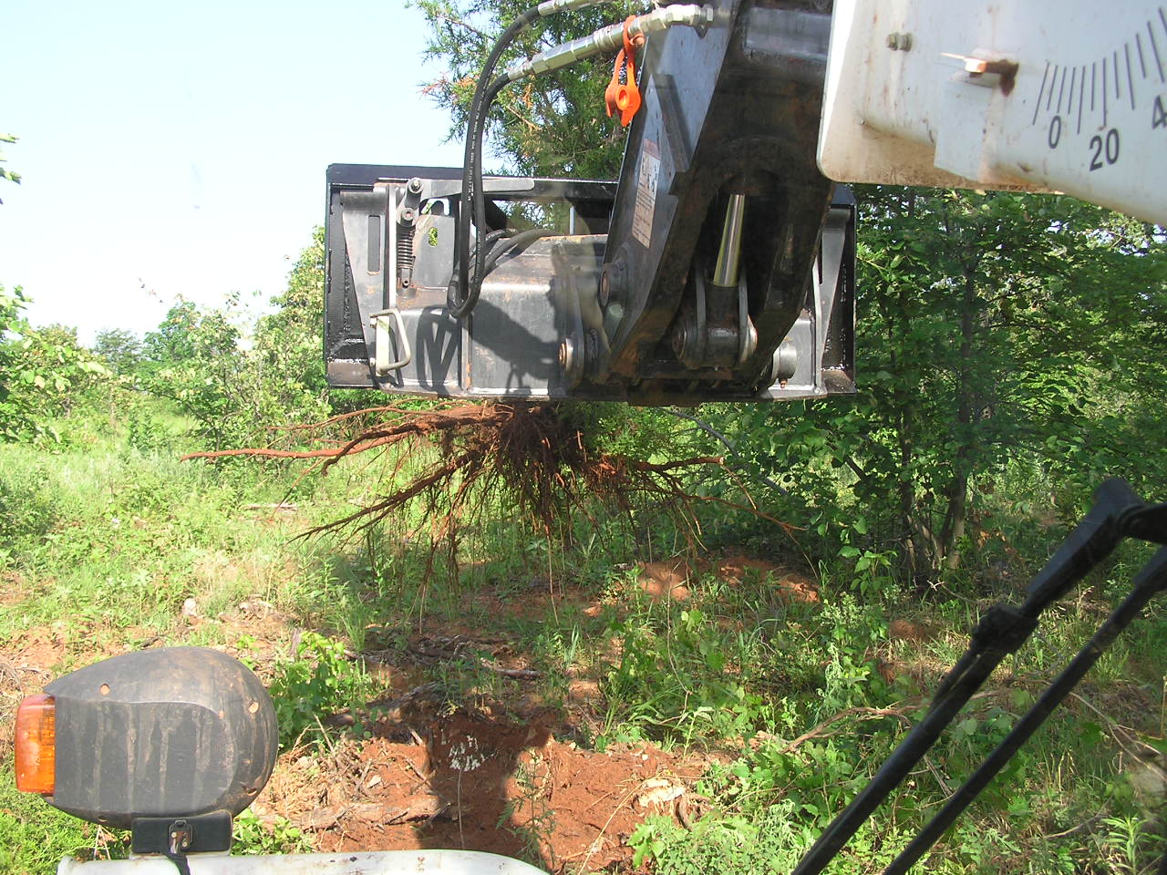

I think your biggest problem with that style puller would be being able to see the jaws.

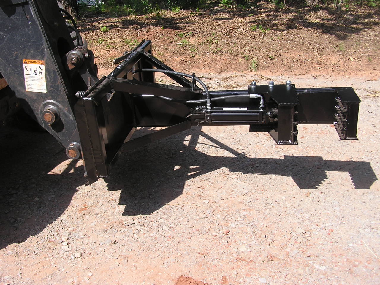

Since you have a high capacity loader, you might want to look at this one that I have.
P6140015.JPG Buckthorn Puller - Custom built Skid Steer attachments to fit almost any need you may have.
View from the seat pulling a small tree.
A small bush.
A cedar tree.

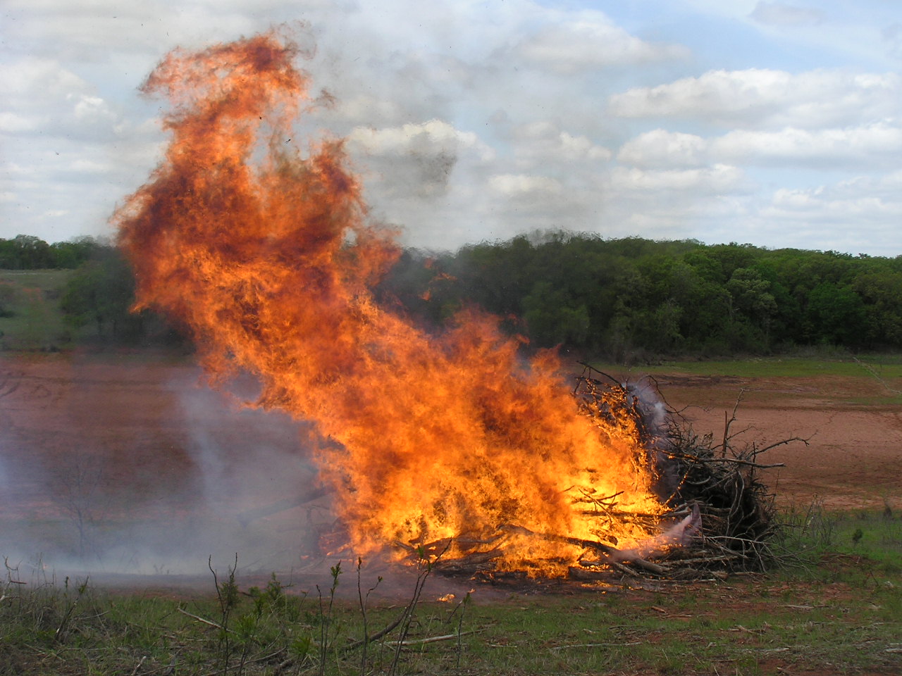

The fifth picture shows dragging one of the plants backwards to the burn pile by gripping it with one of the thumbs on the grapple. http://i823.photobucket.com/albums/...etDraggingBack_P1000822_1000w_zps1f283c5a.jpg There is actually another smaller plant not shown held in the other thumb.
Finally, the sixth picture shows pushing the plant onto the burn pile, along with the smaller plant that was held by the other thumb. http://i823.photobucket.com/albums/...ftingToBurnPileP1000823_1000W_zps7c812968.jpg
Altogether the operation took about an hour and a half to remove about ten pretty large plants plus pull down some of the overhead vines. So far I have converted about three acres to native warm season grasses. I have about ten acres to go, and figure at this rate I should be done by the time I'm 100. With a good tree puller maybe I could reduce that to 98 or so. :)

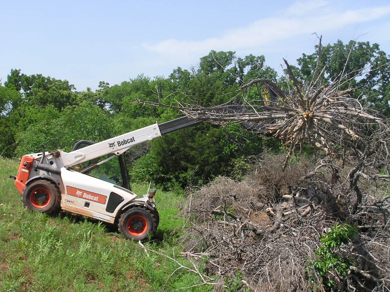

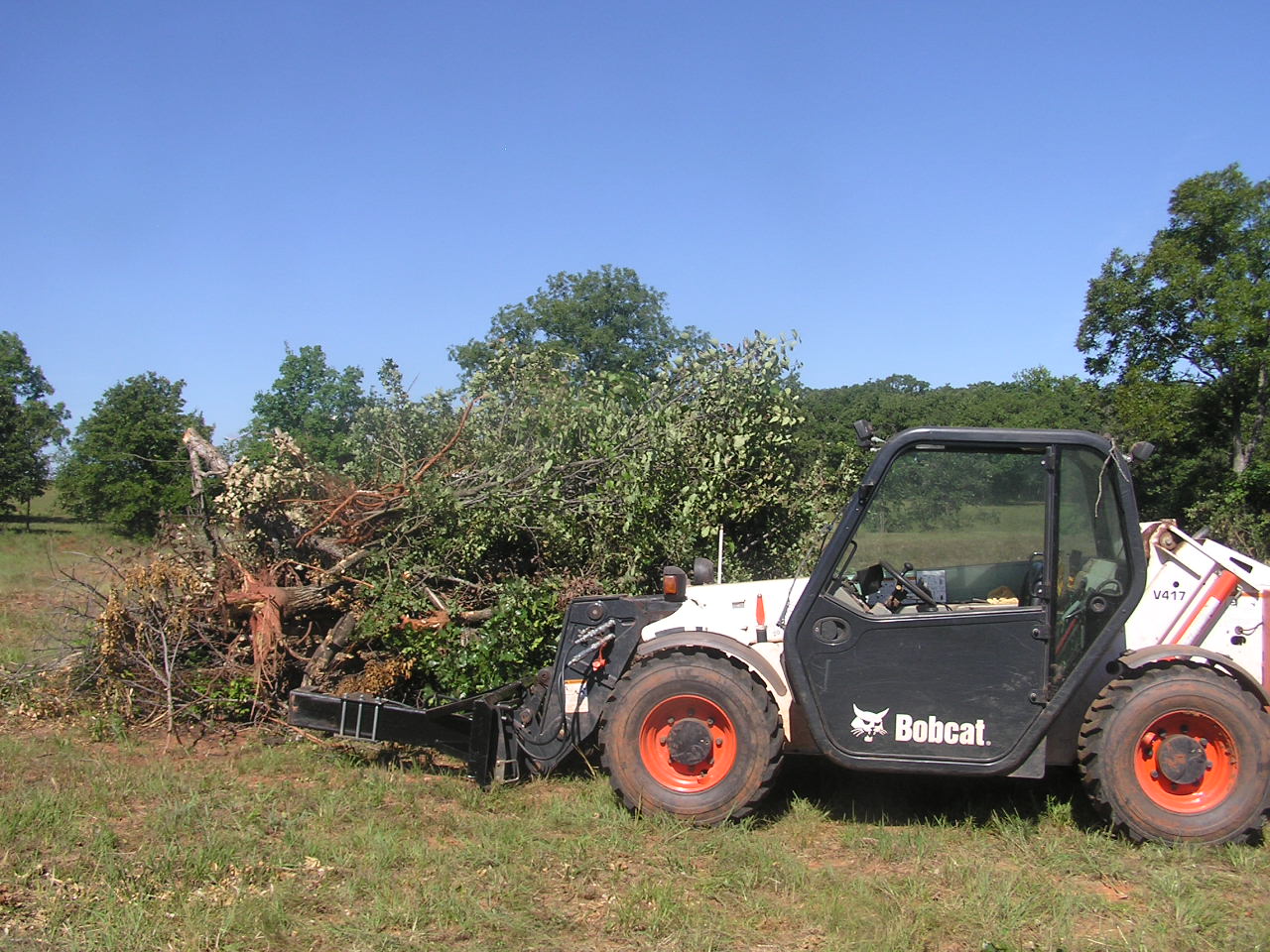

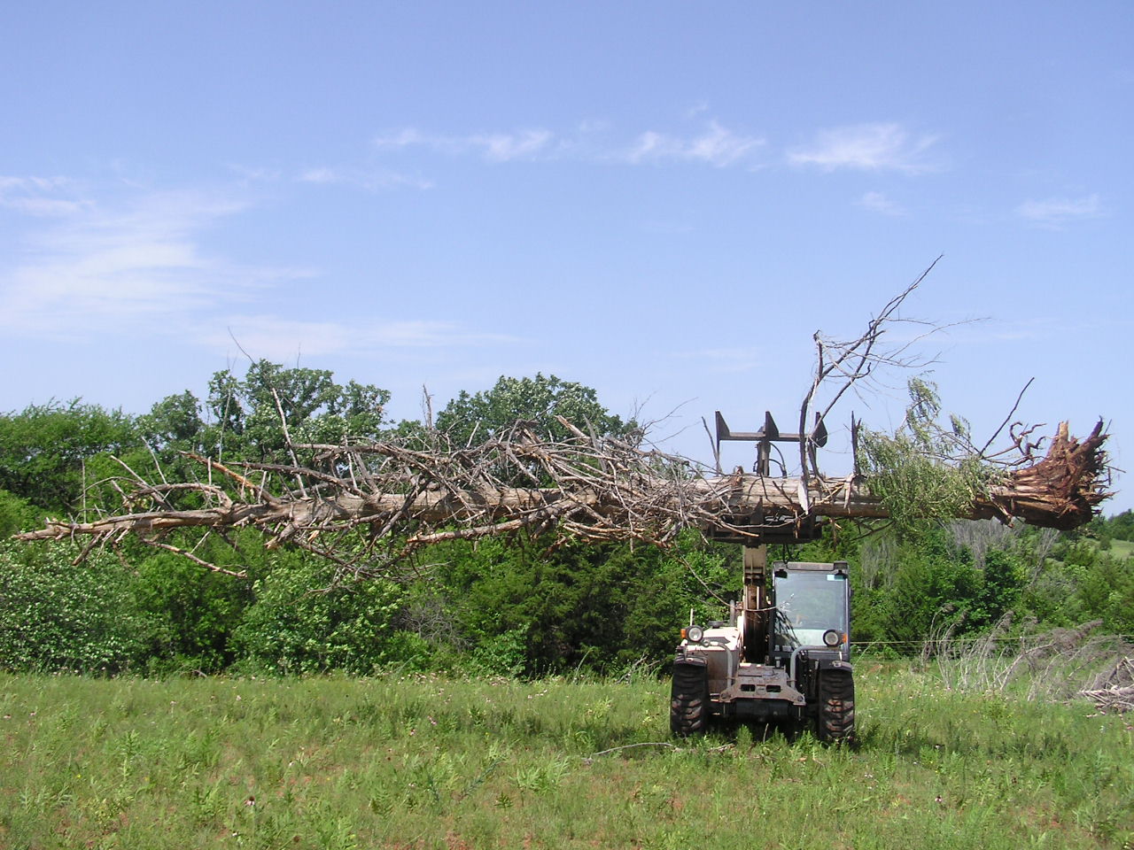

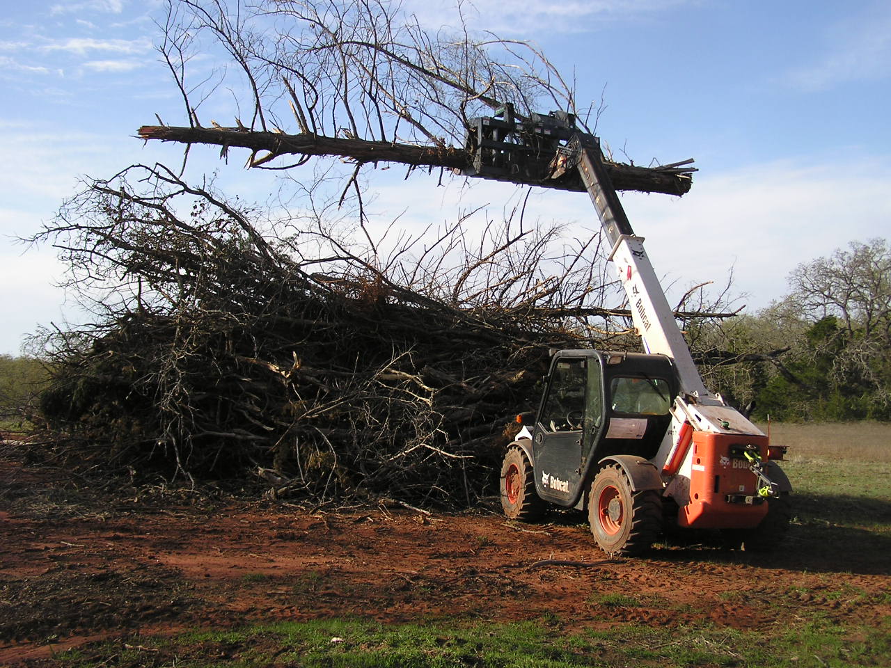

If it's handling your grapple, I don't think the puller would hurt it and the puller just weighs 284 pounds.
One advantage of the long arm puller is you can clamp on the trunk and curl down as you drive forward, breaking the roots out just like your pictures. Then just pull them up and put them on the pile.

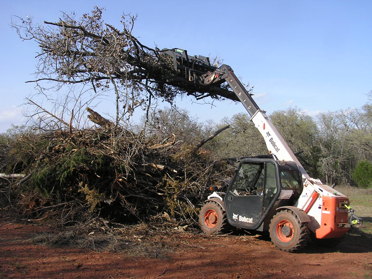

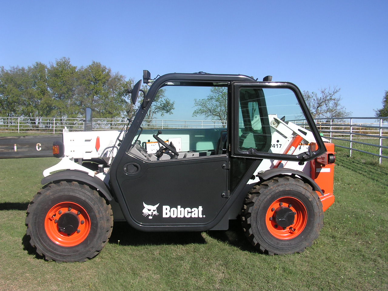

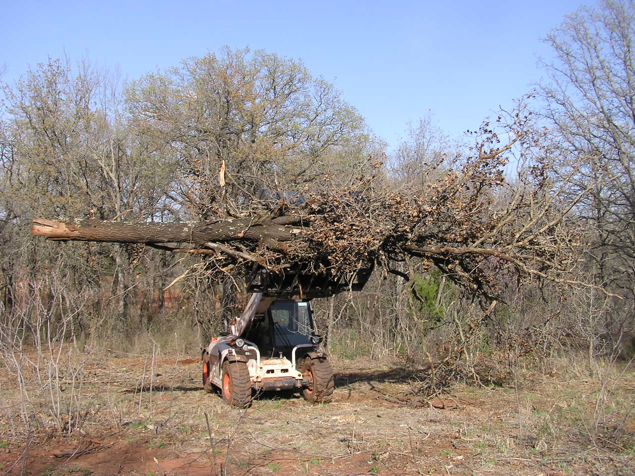

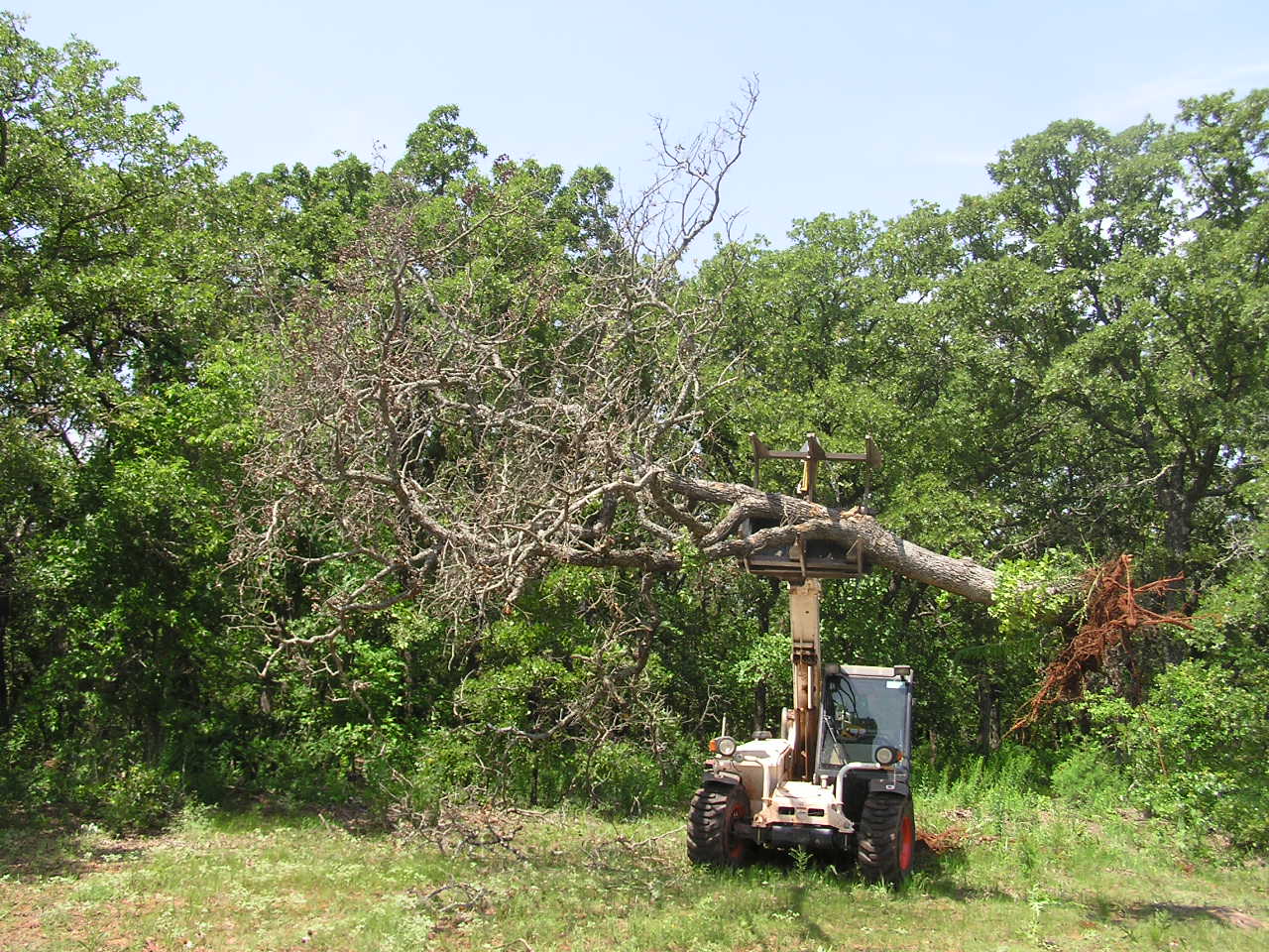

My machine is a Bobcat V417. Here is a link to the biggest cedar tree that it has pulled: http://www.tractorbynet.com/forums/attachments/277824-tree-puller.html#post3444397
