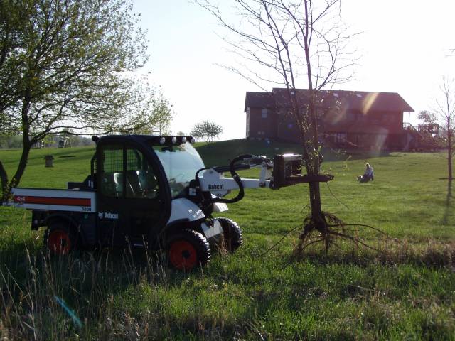

I have numerous thorny honey locust coming up in CRP ground and some multiflora rose in the pasture areas. I've tried cutting the honey locust off at the ground only to find out it grows back, sometimes multiple trees from the same root. So I fabricated a puller to remove them, roots and all. I've also used it to pull some fence posts. Works pretty good.
Have about $300 invested in the quick tach plate, cylinder and hoses. The rest of the steel I chopped up from various pieces laying around.
I use the puller on a Bobcat Toolcat but it could be used on any later model skidsteer.

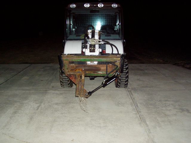

When I first tried it out I had not finished all the bracing, wanted to see if everything functioned how I planned before I welded too much. That was a mistake. It worked so well on the small trees that I quickly graduated to large fence posts and bent the stationary arm. Now you can see a gusset added to that arm. Moral of the story is don't under estimate the power of a hydraulic cylinder I guess.
I put up a post a while back on 'steel teeth' looking to get ideas for the grip on the arms. It dawned on me one day to use sections of steel 'T' fence post. I staggered the pieces on opposite sides so the nubs fit together almost like teeth. Works good on all but the very small stuff. It will grip tight enough that I've slid the back end of the Toolcat around when pulling on an incline, quite a bit of pull considering this unit can pickup a round bale of hay and put it in the feeder.
I have another support arm cut for the stationary arm and am planning on welding a piece of chain to add support to the pivot arm. Also considering adding a 2" receiver to the end of the stationary arm so I can move a trailer around when I am in the field without getting out to hook it up to the back.

Finally got back to pulling trees.... Attached is a pic of a thorny honey locust I pulled. There are a number of these on the property that I will get too.
dsb

Here is a closer view of the pincher....

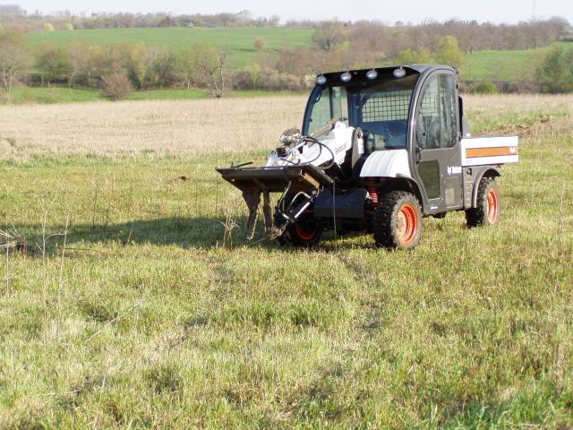

Unfortunately, the tree in the pic is not my main use. Over the years we have mowed off the trees growing in the CRP. Little did I know that mowing them off does not does not stop the root from growing and each year new sprouts come up. Instead of having one or two main trunks to grip and pull there are many small sprouts growing from a 4 or 5" root and the sprouts are not strong enough to pull the root out. So I end up having to point the puller down and drive it into the ground to get hold of the root to pull it. Many of the roots are big enough that when I closed the puller it slides the front end of the toolcat. If I do not get a clean pull on the root I often have to re-position to get the puller to straddle the root again.
Attached is a pic of the puller ready to go in after a root.
