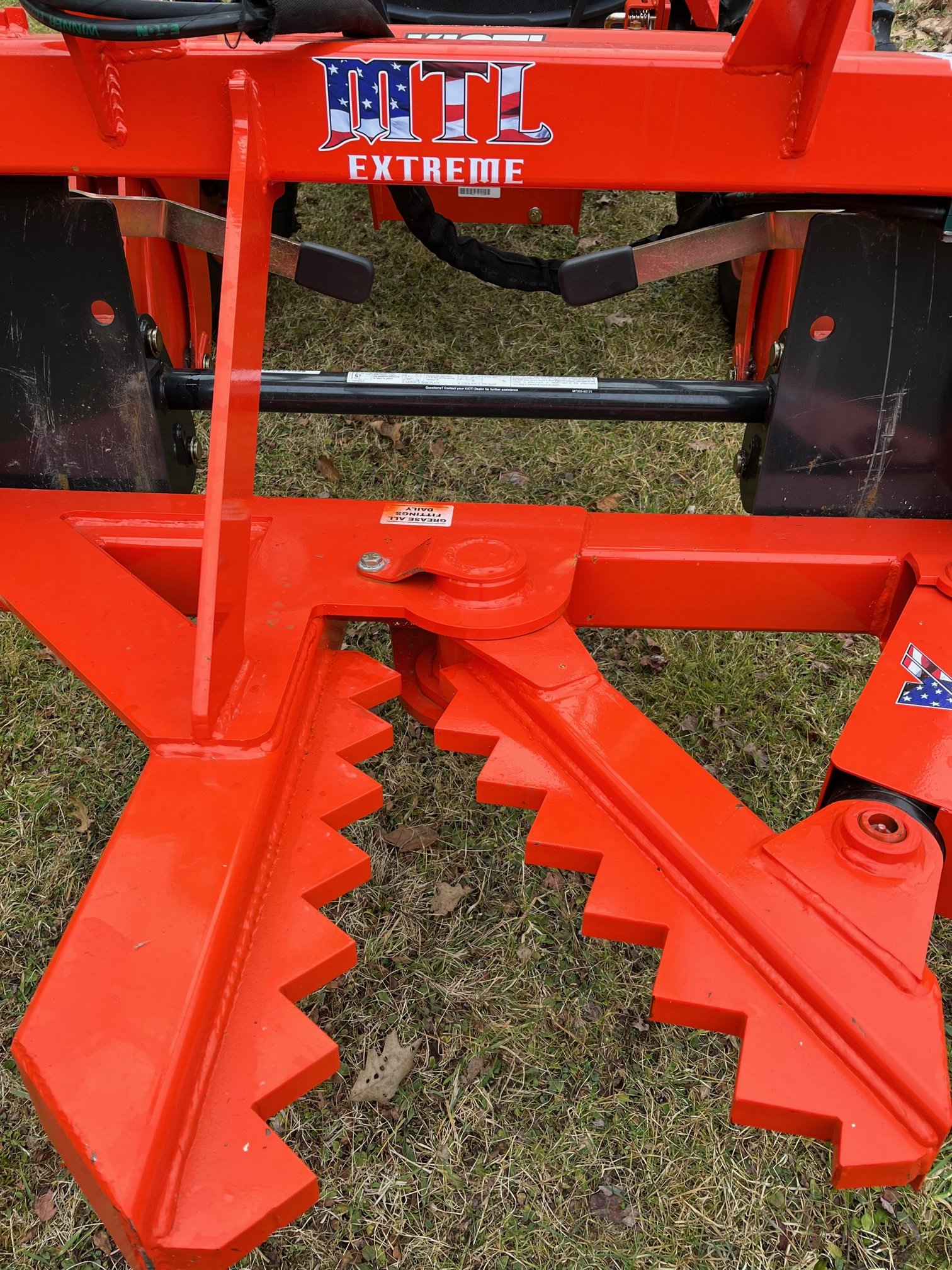

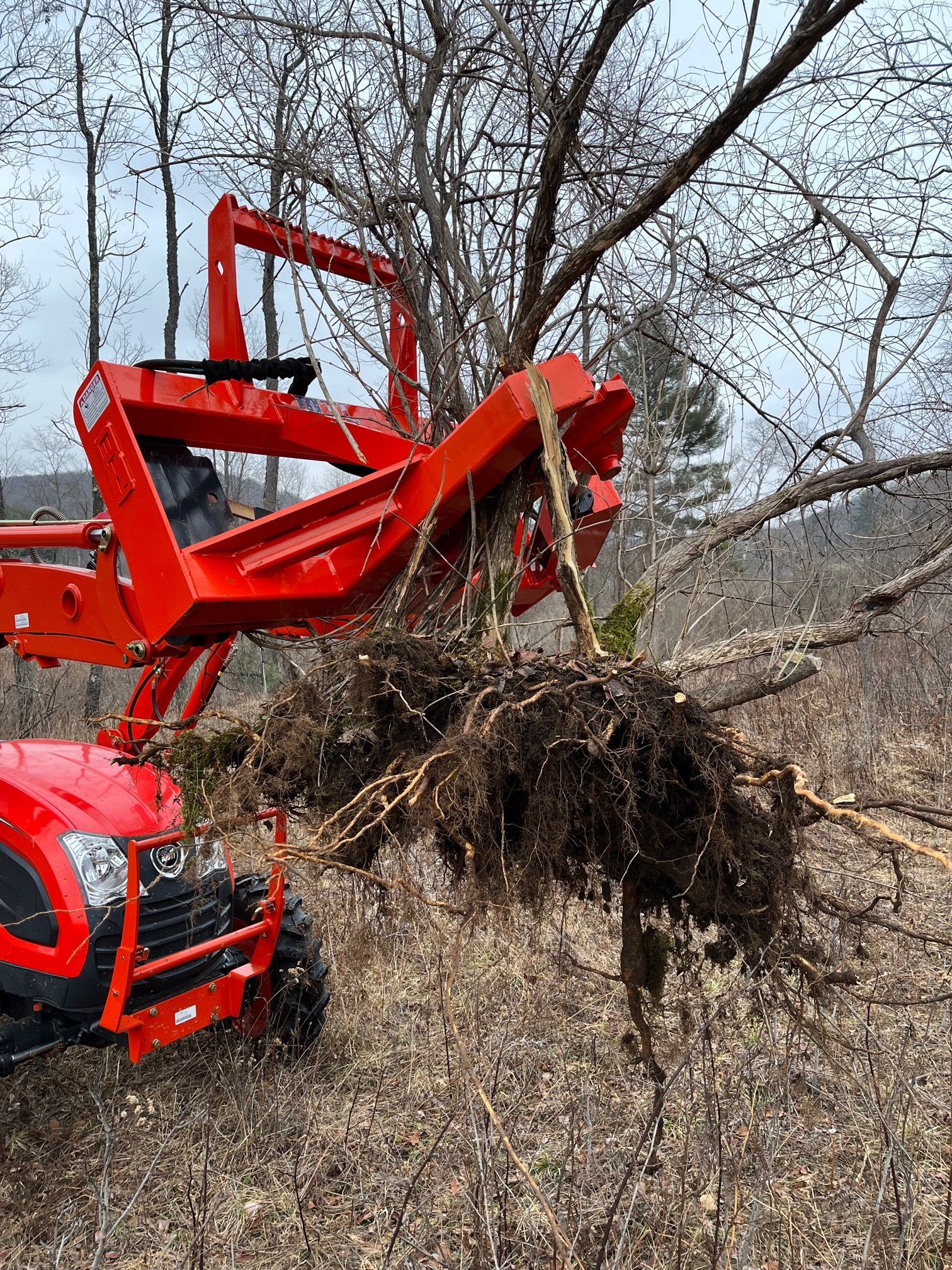

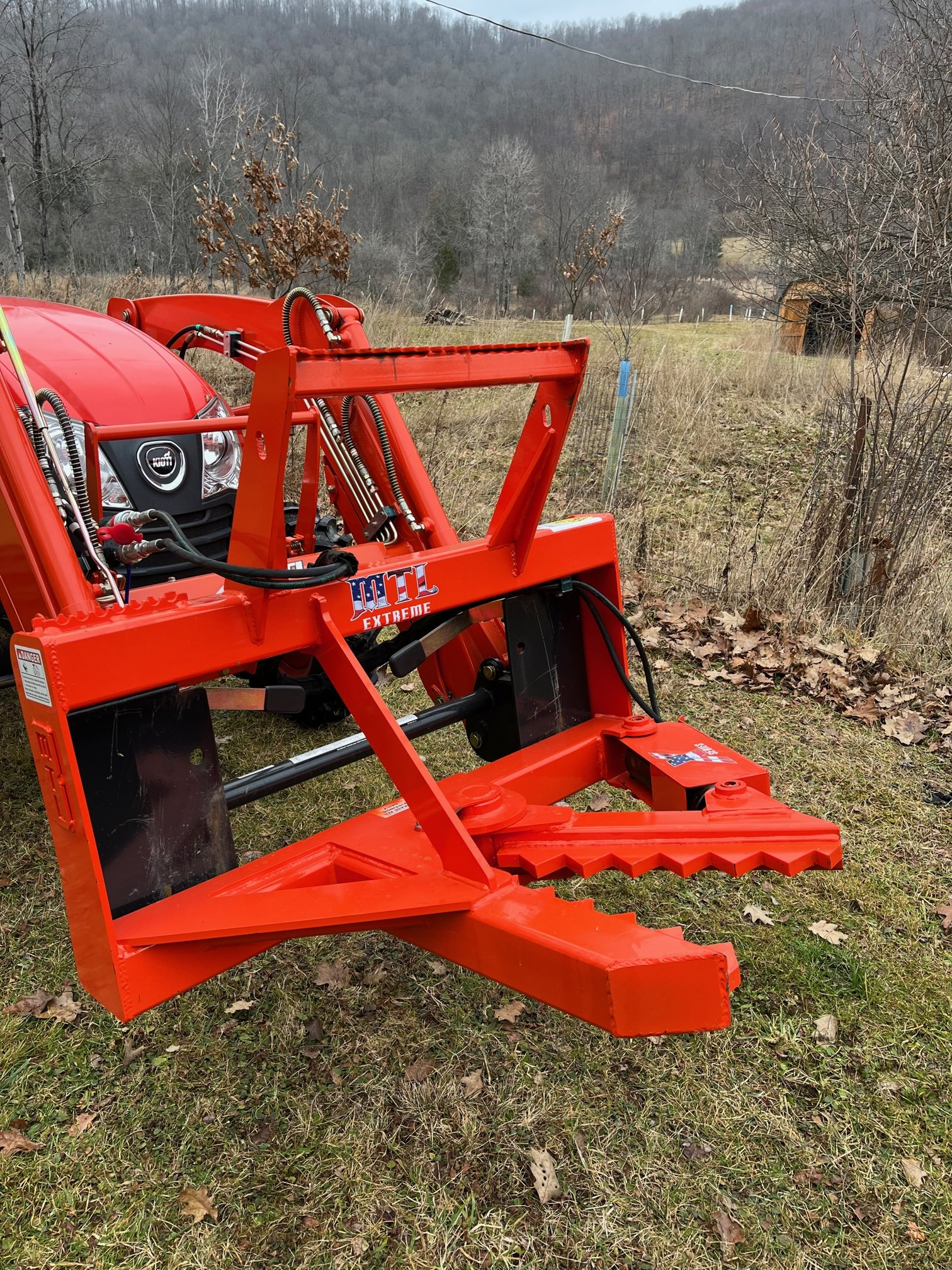

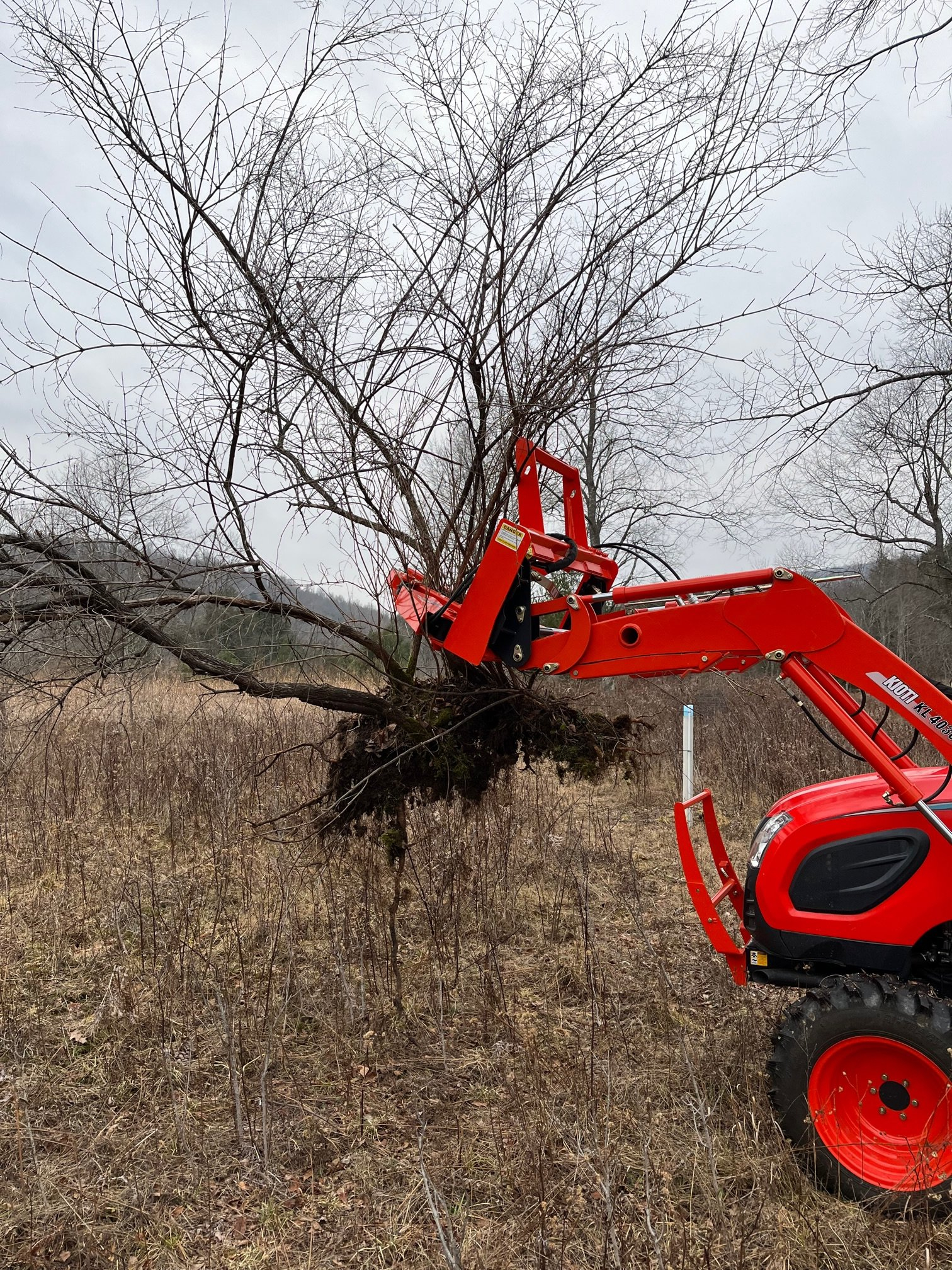

I have ACRES of invasive honeysuckle and autumn olive. I am eligible for various habitat restoration grants. Some of those grants request removal of invasive species and replacement with pollinators, native species, etc. etc.
To remove invasive honeysuckle in the past, I would wrap a chain around its base and pull it out with a small tractor. This worked well except on the large bushes. This also was alot of crawling to attach the chain, then loading/lifting the carcass onto bucket to move to the brush pile, placing my head down under bush with more exposure to ticks, etc. Don't mind the effort but when you have ACRES to do, then 6 hours of crawling/moving the chain/etc. wears you out fast.
Was going to purchase a grapple but came across this MTL tree/post puller and went in this direction instead. Just tried it out on a couple bushes and gosh if you have alot of large invasive honeysuckle to remove then this works great! Should reduce my removal time by 75% and much less effort. Can move the carcass to the brush pile while staying on tractor and so much simpler.
My initial thoughts:
Attachment via SSQA - 10/10
Durability/Heavy duty - 10/10
clamping force - 11/10 - may be too much clamping force since it crushes small trunks
length of tooth bar - 7/10 - could be longer
design of teeth - 9/10
protection of operator from limbs - 10/10
For $1200 I feel it will be well worth it! (y) My $0.02.
I have a couple vids but I believe I need to host them before I can attach. maybe post vids later...

Have ballast & filled tires, rocking back & forth can lift rear axle off the ground. Slowly pull forward - can envision breaking tractor when I get too aggressive. Clamping a little higher up and curling down while driving forward applies twisting forces on roots. Sometimes pull again at different angles help. After pulling up several piles, need grapple to move them.

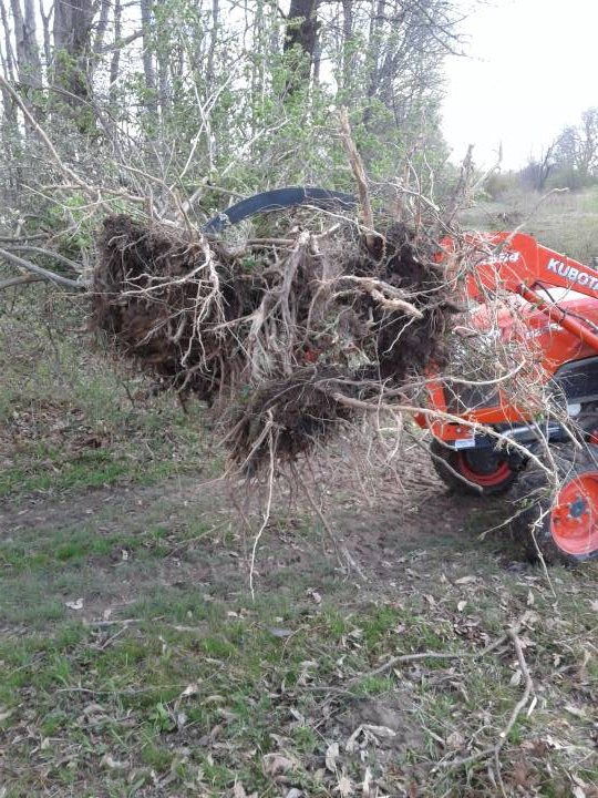

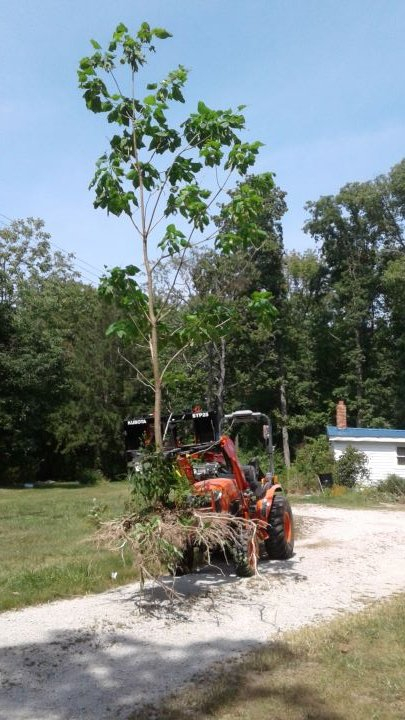

The best time to use the puller is in the Spring when the frost first goes out. The ground is heaved from frost and the roots haven't reattached themselves to the dirt yet. If you get lucky and be in a dry time you can shake most of the dirt off the root ball at the pull site. Helps fill the hole left in the ground
Be careful about the forces you are applying to the curl cylinders. If you have the puller tilted forward and you reverse the tractor you can easily apply more forces to those cylinders than they are designed to stand. This can result in a bent cylinder ram. :rolleyes:

If most of the stuff being pulled up is like your pictures, I'm not sure that a grapple would add much usefulness because it looks like you already have a pretty full load to manage with your puller, especially with the dirt rootball attached.
