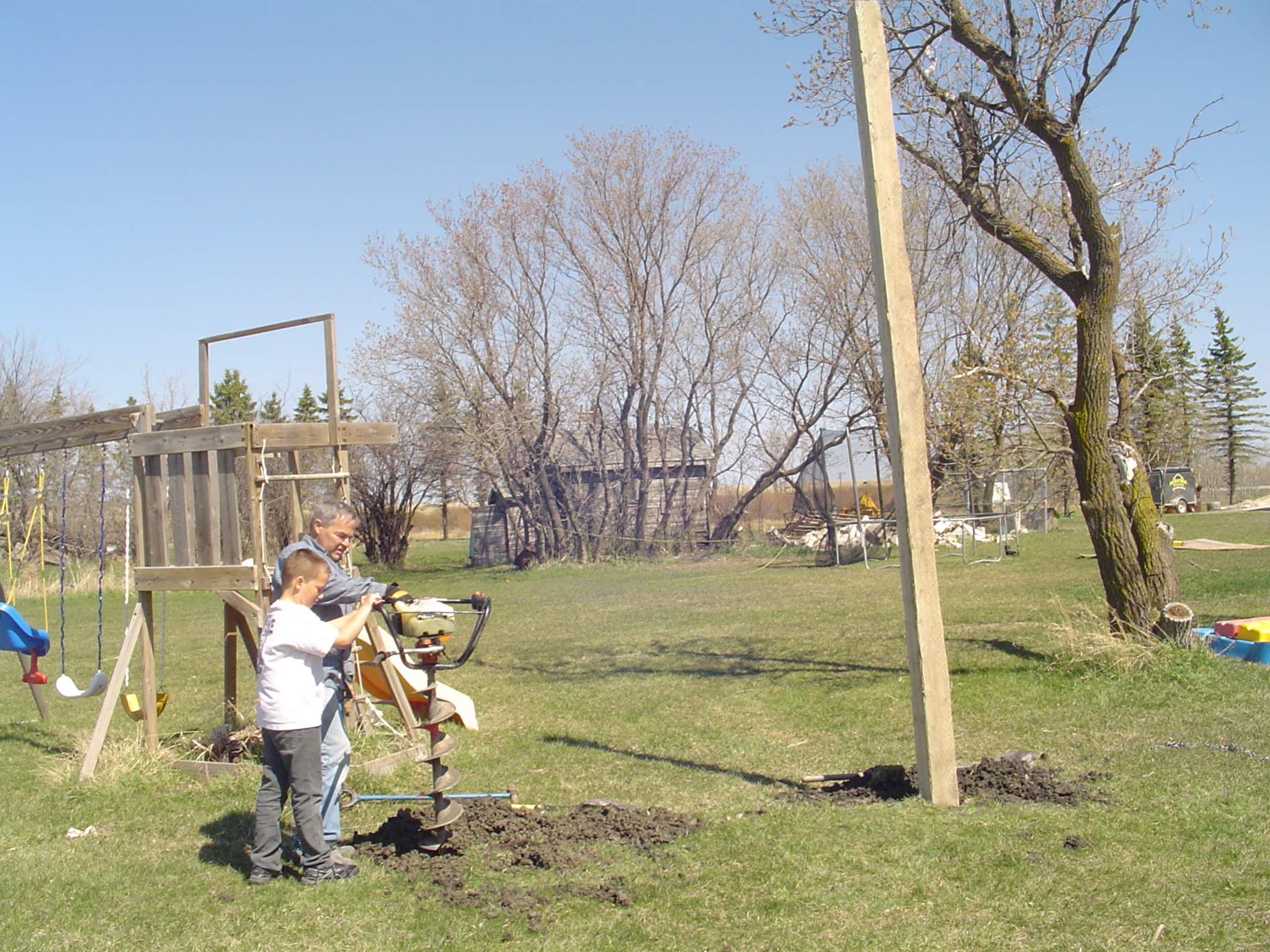

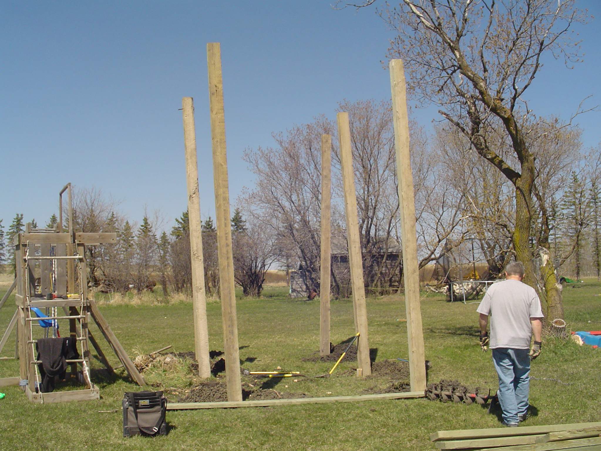

Well I started the tree house for those who want pictures here are the first ones.
