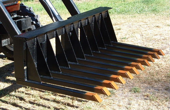

Well here is the first project for the big tractor. The regular FEL bucket is great for loosening and ripping out many of the stumps on my property but most of them are too big to fit in the bucket once they are out of the ground. I also have a bunch of debris and a few existing brush piles that I need to reform and burn(don't want to light off a pile of tires under an existing brush pile by mistake). After looking at what was available and the price, I decided this would be a project to build myself. The bucket is 60" wide with 11 tines spaced on 5 13/16" centers. The tines are 2"X 1/4" box tube 30" long. They have 20" of reach forward of the gussets and have 3 13/16" gap between. The rest of the frame is made from 4"X 1/4" angle with 6" strap for the gussets and 4" strap for the side and top reenforcement plate. I have been playing with it for about a week since I finished it and it works great at straining the big rocks and wood trash from the dirt and making piles. I finally got around to cleaning it off and painting it today so I thought I would post a picture. Tools Used: Lincoln weld pack 100, 14" metal chopsaw, jigsaw and metal blade, 4" angle grinder and a die grinder with wire wheel to clean off the weld slag.

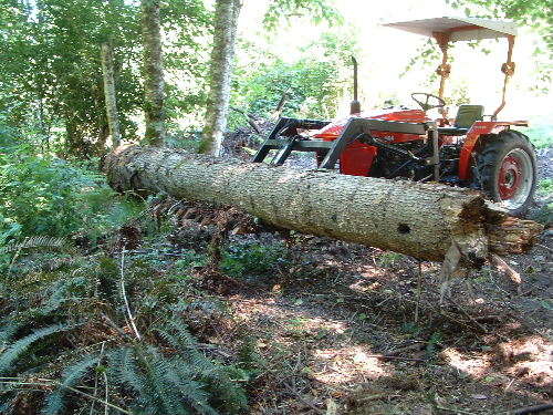

   / TRASH/ROCK BUCKET
Logs are no problem.

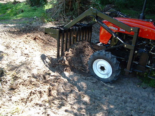

   / TRASH/ROCK BUCKET
Back raking, not back breaking.
   / TRASH/ROCK BUCKET
Once raked, scoop forward in a low gear, lifting a little if she bogs down.

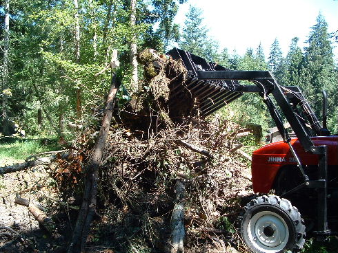

   / TRASH/ROCK BUCKET
#9
Lift, seperate and repeat untill the bucket is full, then dump. That area where I was rakeing was a wild rose bush thicket that was about 10' X 20' with a bunch of downed logs/branches in it. The rake made quick work of it and it is now piled in the background for burning.
