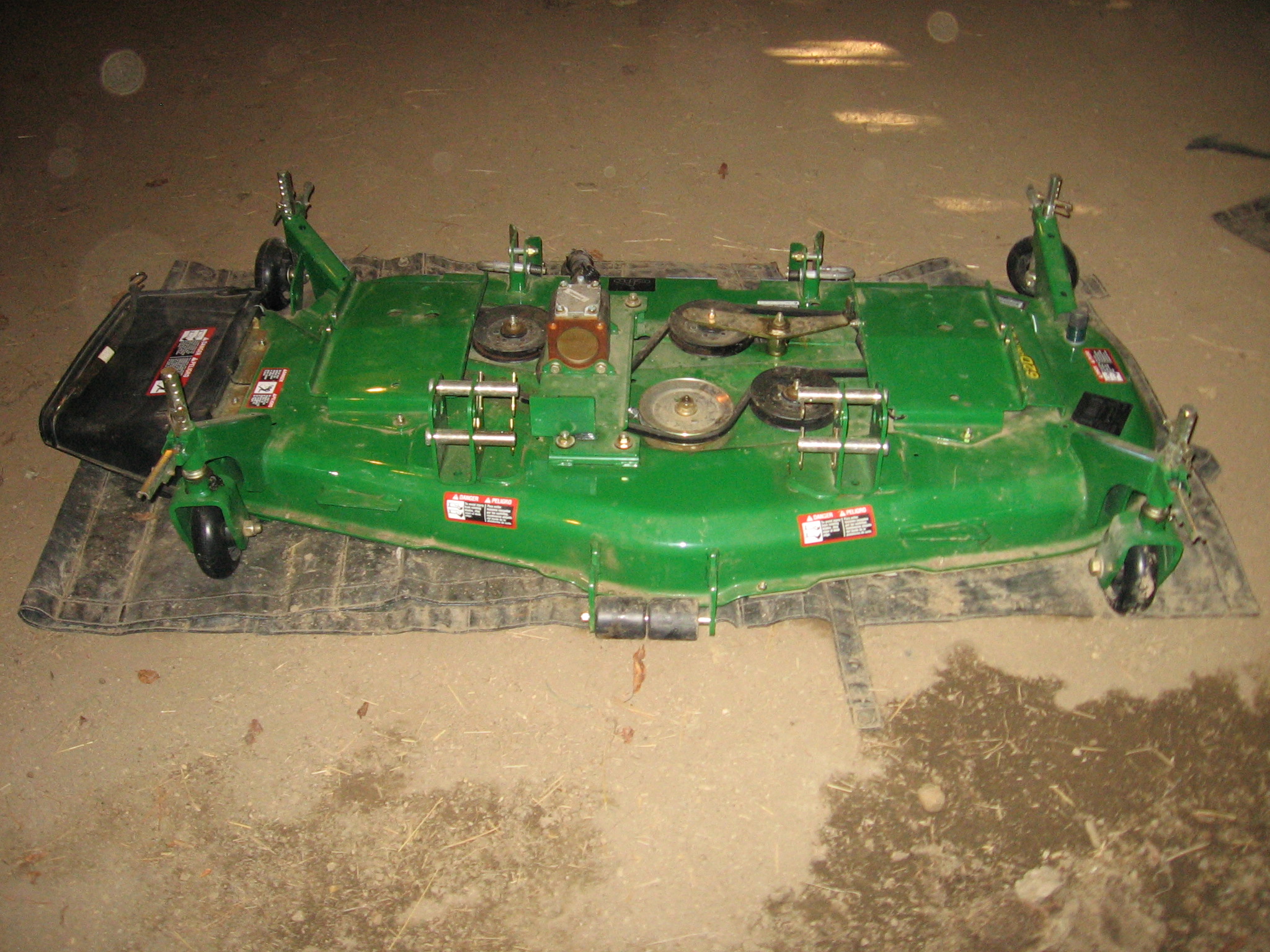

Are you guys talking about these four pins? If used with the I-Match it is a snap to pick up the deck. I never have to touch the pins,they stay in this position.
Joe hello and welcome to TBN:)
How new are the decks your dealer told you about? Mine isn't even a year old.
Greg

Yes Greg they are the pins. My dealer said Deere got rid of them. My deck is 1 wk old. They would be nice to lift the deck so I could get under to clean it.

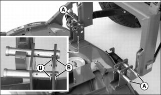

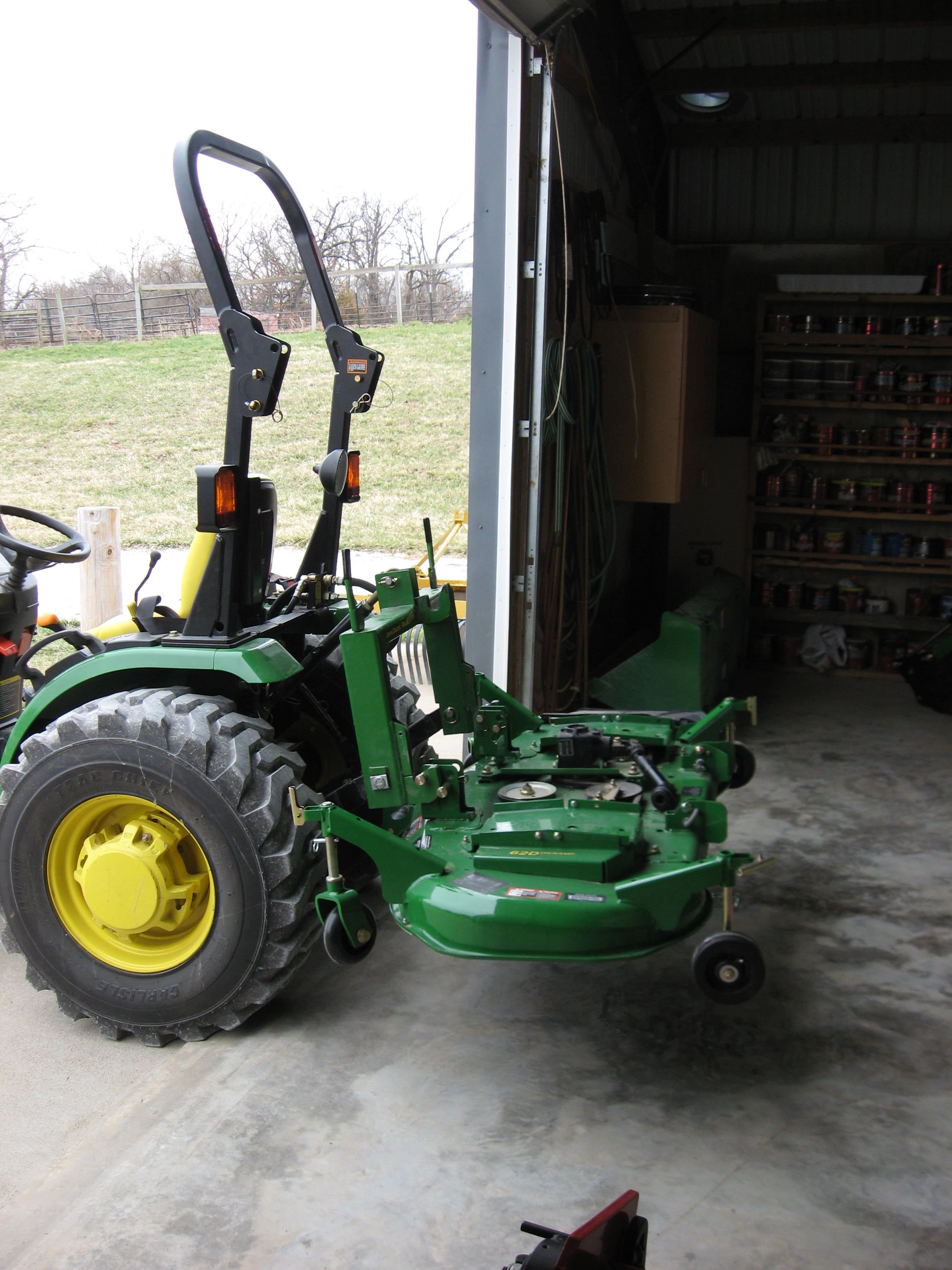

I don't see how you can pick the mower up with the pins in that position with an iMatch because the spacing is too narrow? At least on mine, they have to be moved to the "wide" position (as shown in the photo from the owner's manual) to lift, and if I leave them there, they interfere with the brackets under the machine when I put it back on.

Runner,I'm sorry I wasn't more specific. I just meant the pins stayed in those holes,but,yes,they have to be moved outward.

I only use the top pins and a chain to the rear of the deck
