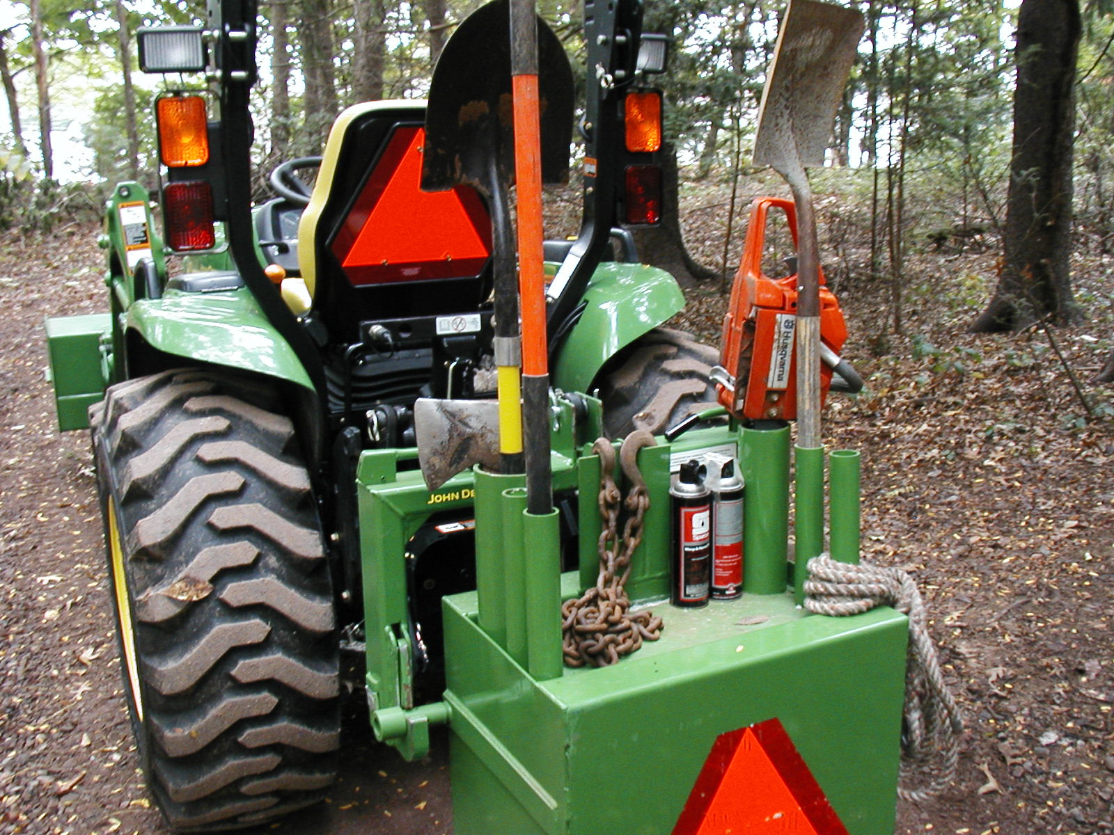

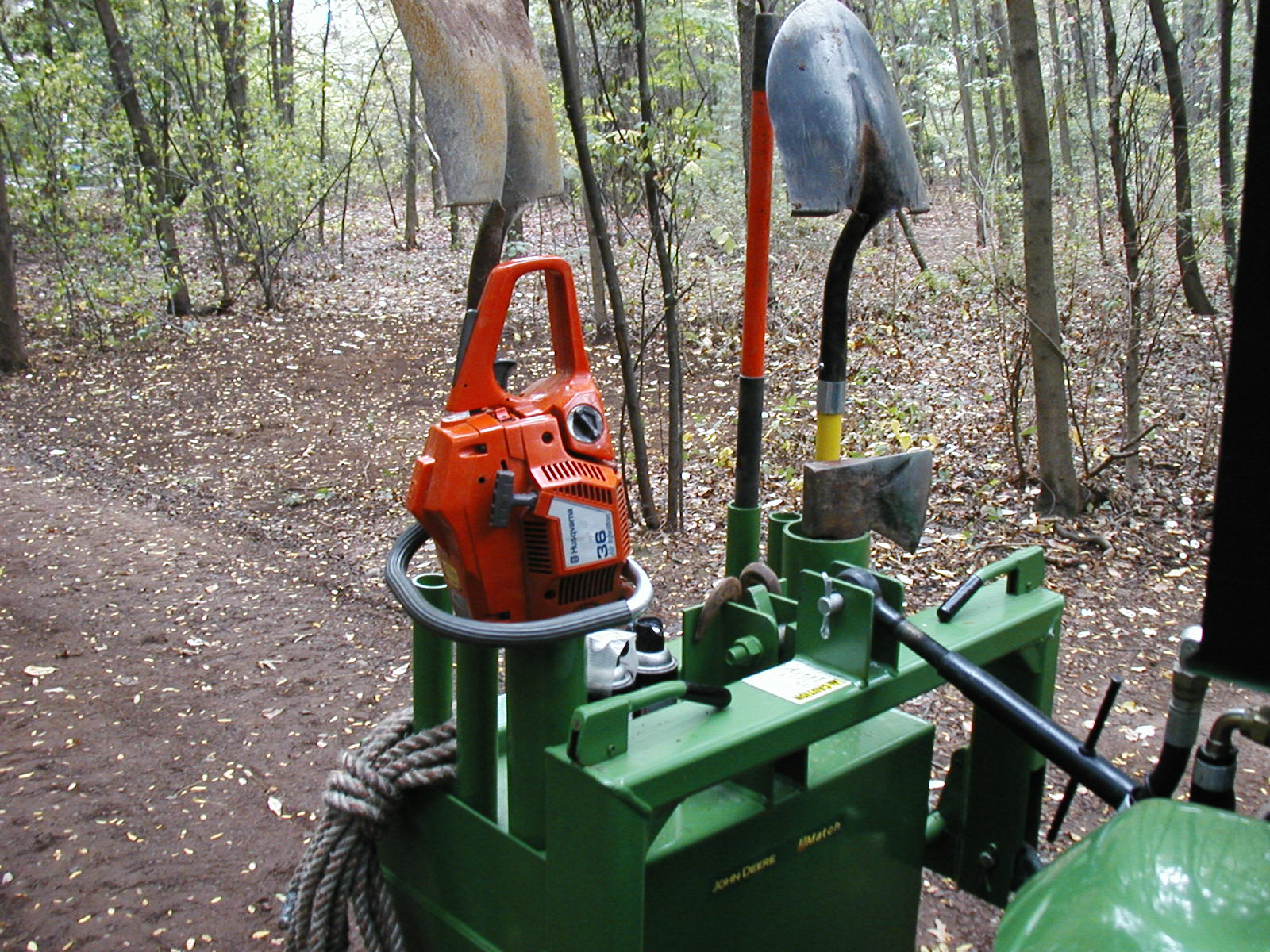

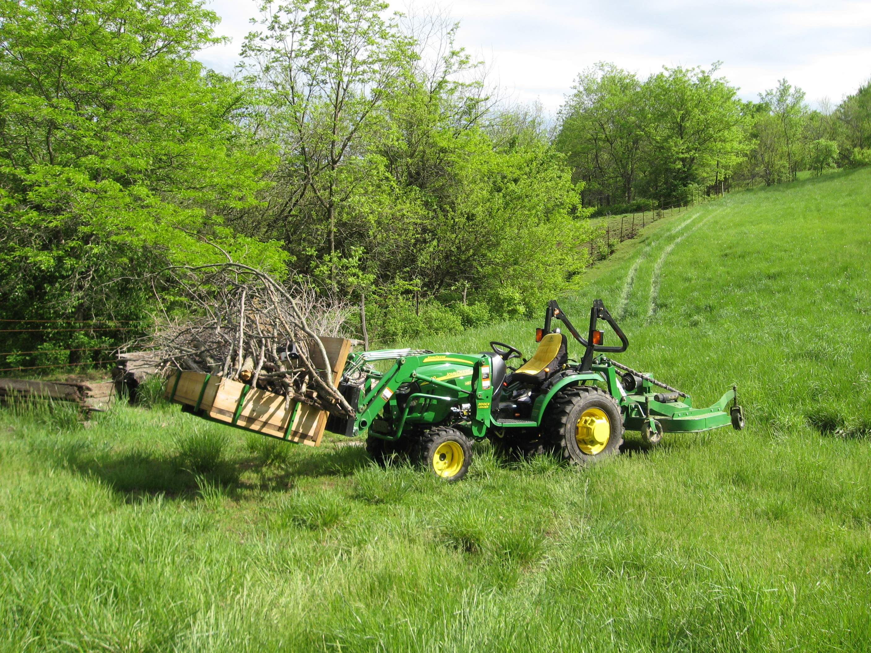

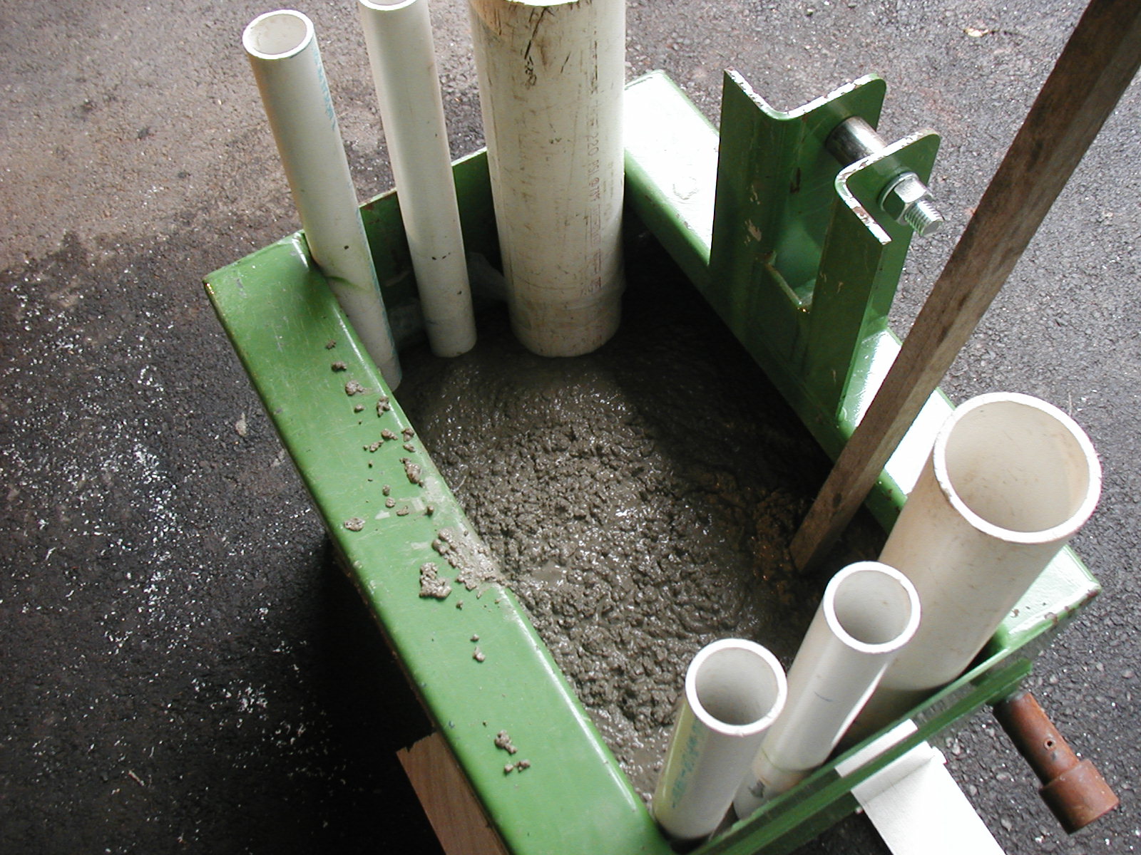

Well sounds like you will be doing this on a regular/long term basis, so IMO you will definitely need forks (oops, I see you have a grapple, That Works :thumbsup:) and you need a ballast box or other heavy implement on the 3pt.
I Would go with a customized (for your needs) ballast box. With tool holders etc. I don't need to carry a saw that often or else I would of made a dedicated saw scabbard like some of the excellent examples shown already.
Done right, you could carry all you need on the 3pt with the ballast you need.
My small saw fits a 3 inch pvc pipe, but I would go with steel if I did it again, so there would be no chance of breaking the plastic from catching a long handle tool on something. Steel would not be good for the saw though.

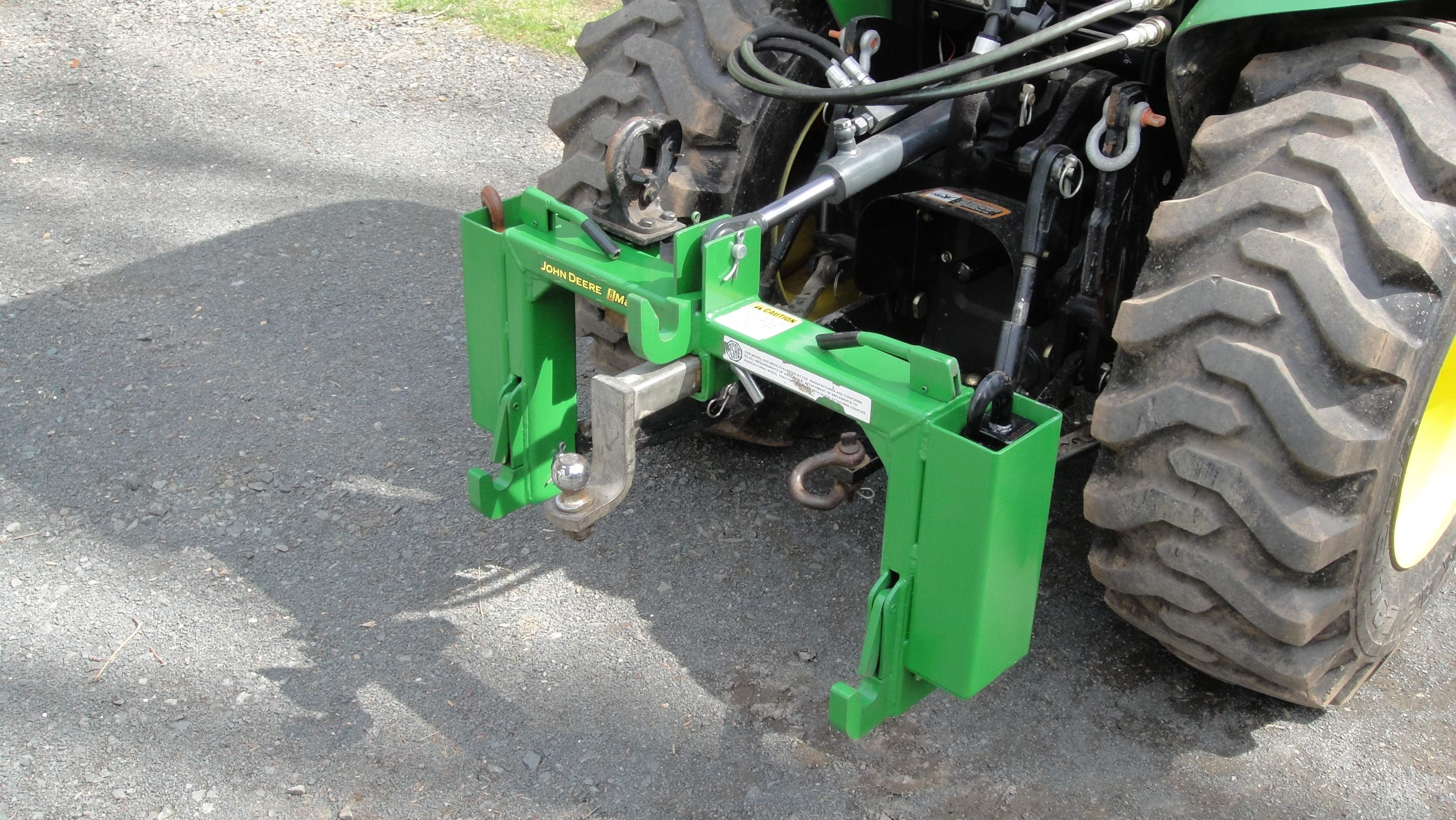

If you are going to have a quick hitch, you can add some mods to that as well.

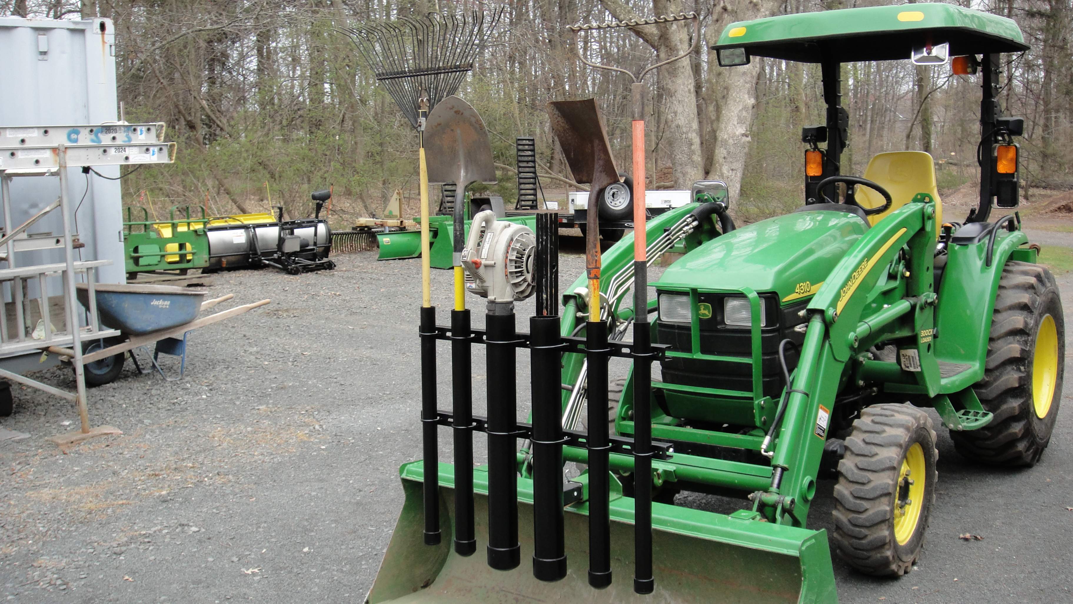

2 inch receivers tubes are so handy, you can add and remove special accessories/ tool holders as you need them. You can put them just about anywhere you can think of, buckets or any 3pt implement etc.
JB

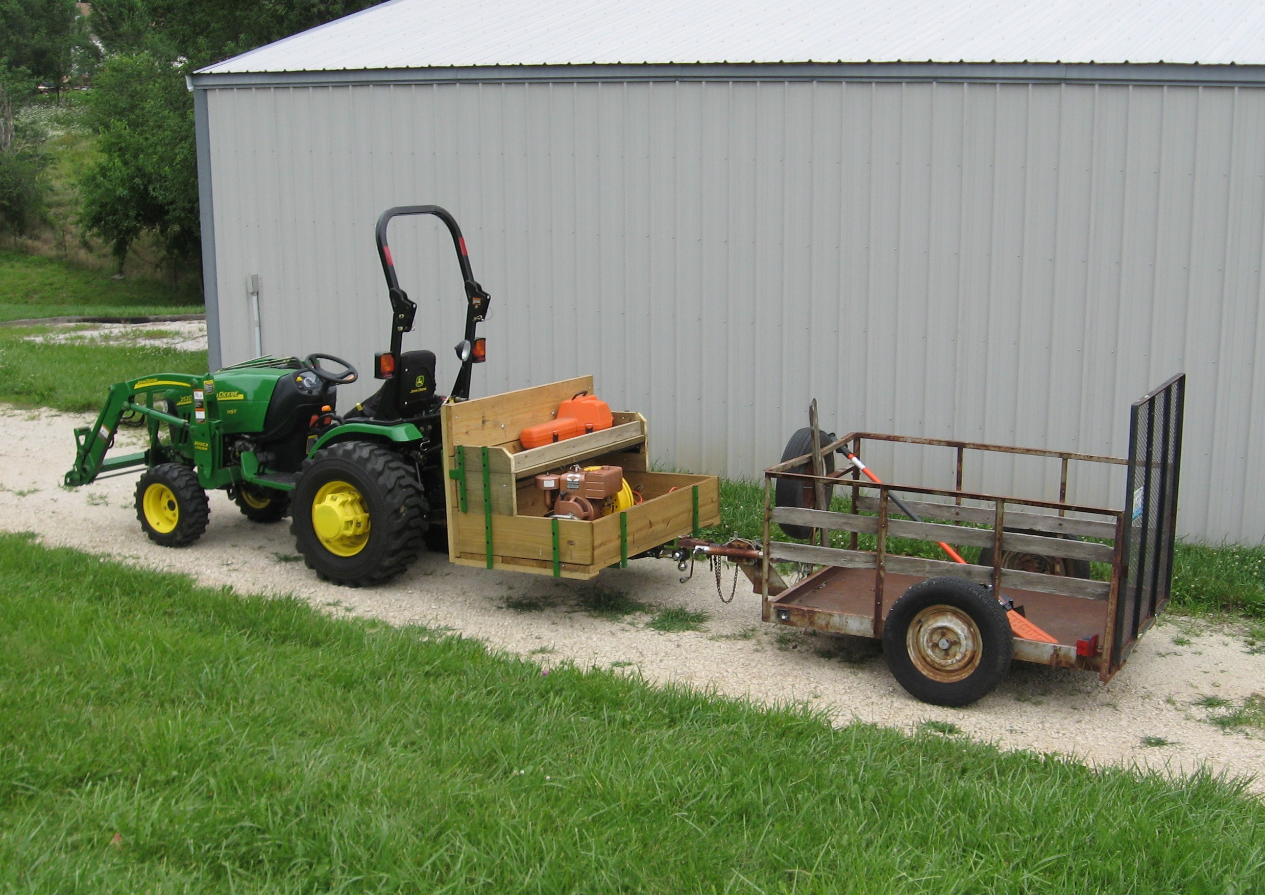

Posted earlier to perhaps help Mossflower Woods{1}Homemade trailer made from full size dodge pickup bed {2} receiver hitch with 2 inch ball {3} large toolbox on front frame of trailer--used to store chainsaw, logging chains, oil, gasoline, files,various other necessities;etc {4} and some tractors already have a FEL. Not expensive at all--pretty simple and everything is there for your convenience and mostly kept in a manner that is easy to unload. All of us members are here for the sole purpose to help each other. We are related in a way with regards to our association with tractors and farming.Happy Tractoring.
JB
I really like your bucket mods with the 2" reciever and the rack ful of tools!
David
