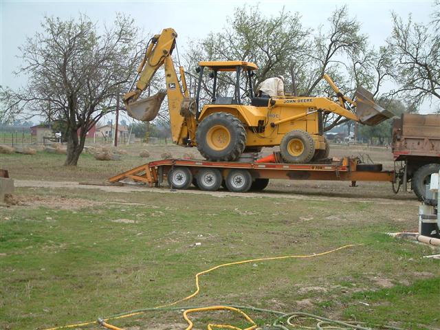

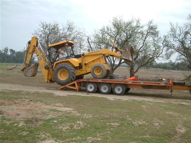

   / Transporting a 15k tractor #4
My contractor has a 410C and hauls it like this:
The triple axle flatbed may be overkill, don't know.
You won't break any speed records with a dump truck like this one and it's probably a gas hog.
Good luck
   / Transporting a 15k tractor #5
Flusher, that trailer looks like a 9 ton. Hardly overkill. It's so short neither bucket can touch the deck. Not meaning to sound like a d--k, it might be fine around town. Really not suitable to cross state lines.
   / Transporting a 15k tractor #6
Yep, you're right--that rig is for in-town and backroad travel, not for the interstate.
