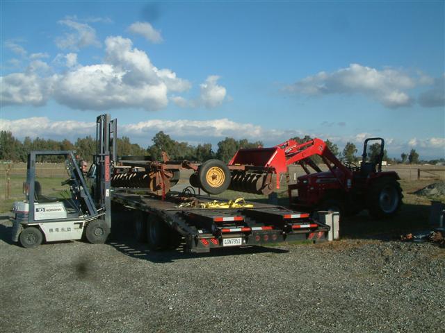

Here's how my 13-ft wheel disc was delivered. Hitch was removed, placed sideways on the trailer--the only way to do it legally.
Good luck.

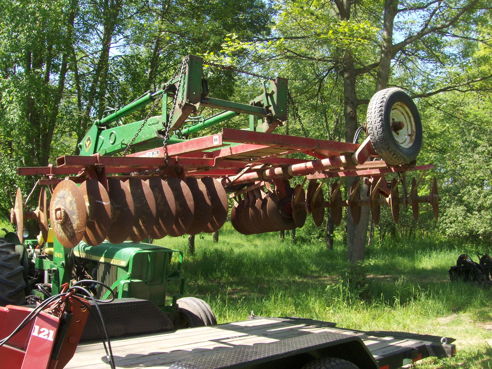

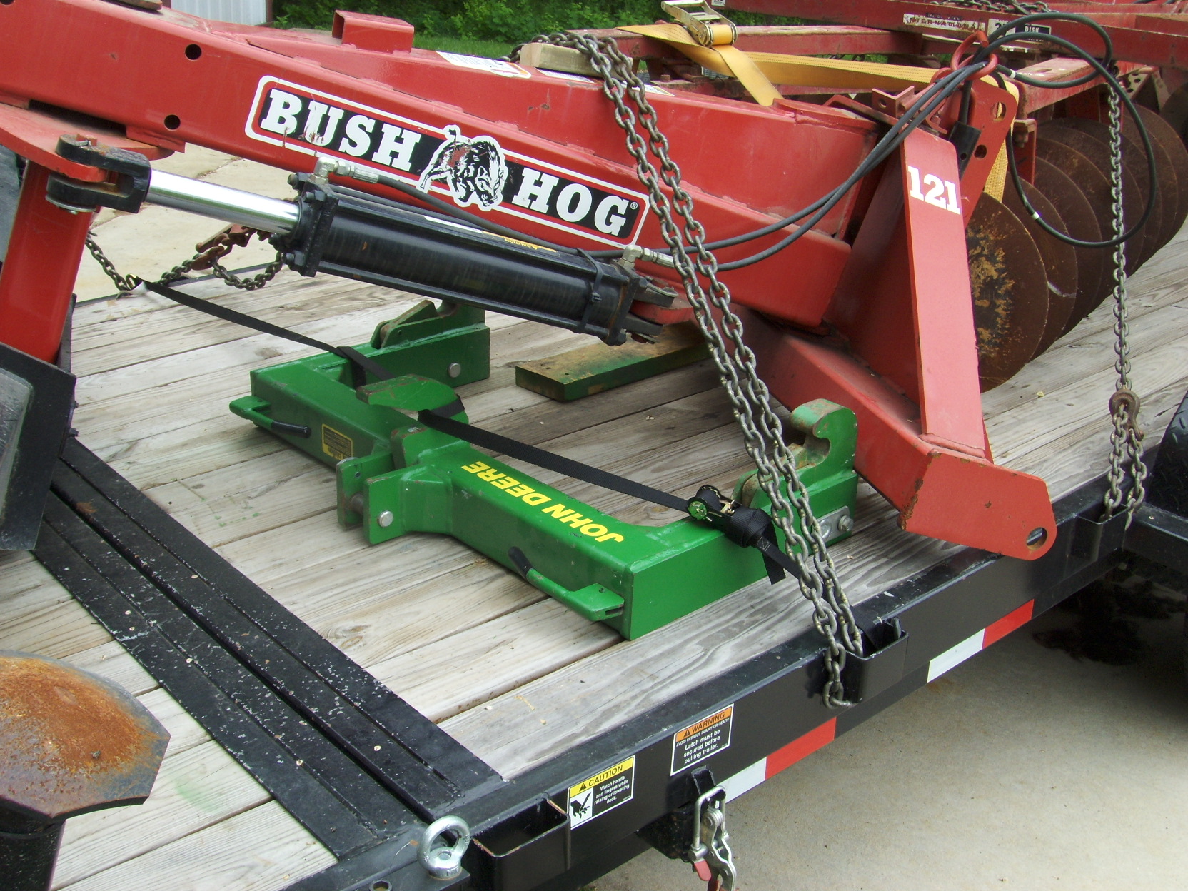

Traveled 500 miles picked up the Bush Hog rear blade, a JD CAT 2 QH and the 10'disc. Ended up unbolting the guides at the outside edge of each disc gang and swinging the rear pair toward the back and the front pair forward. Unhooked the lift cylinder and flipped the transport wheels up out of the way. This was less work than taking off the tongue. I can see that would be the only way with a 13' disc.
I was legal width. Not sure if the tongue hanging off the rear was legal ;)

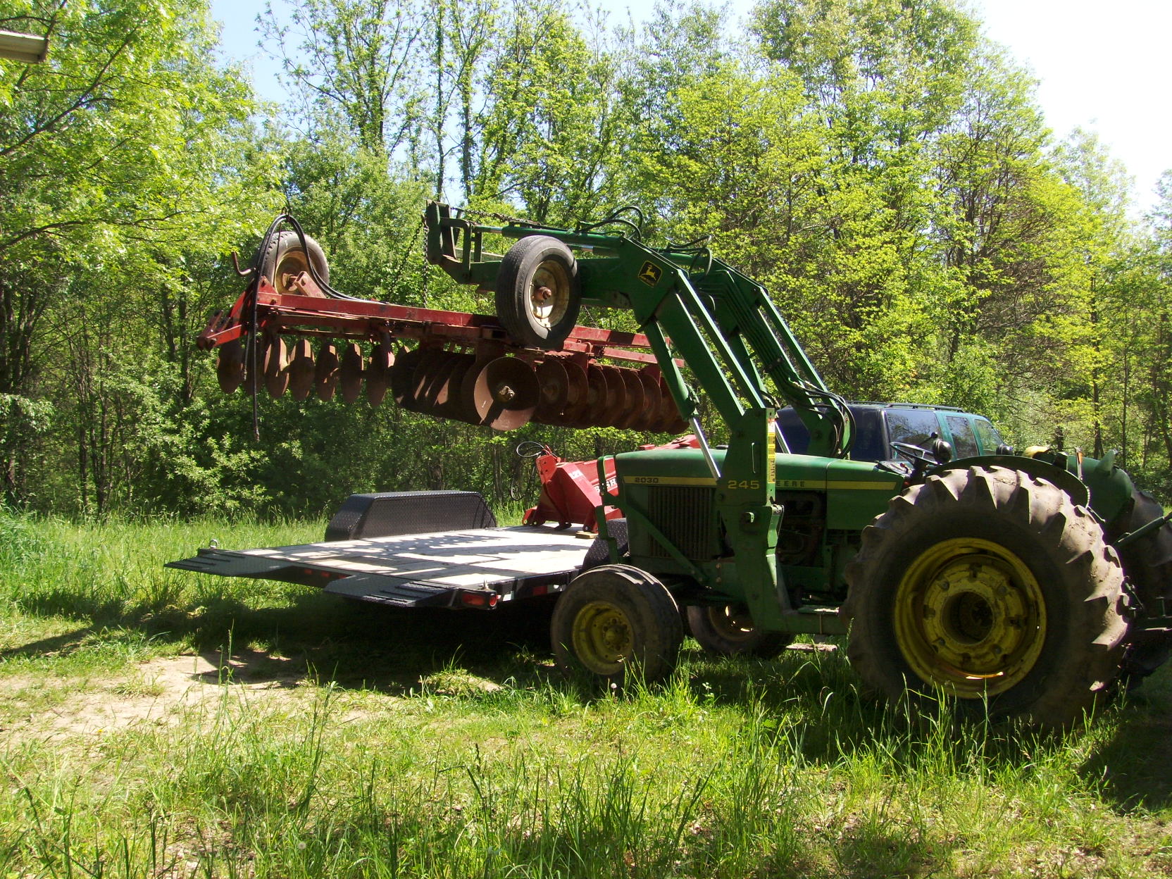

The 2030 had no truble lifting the disc off!
