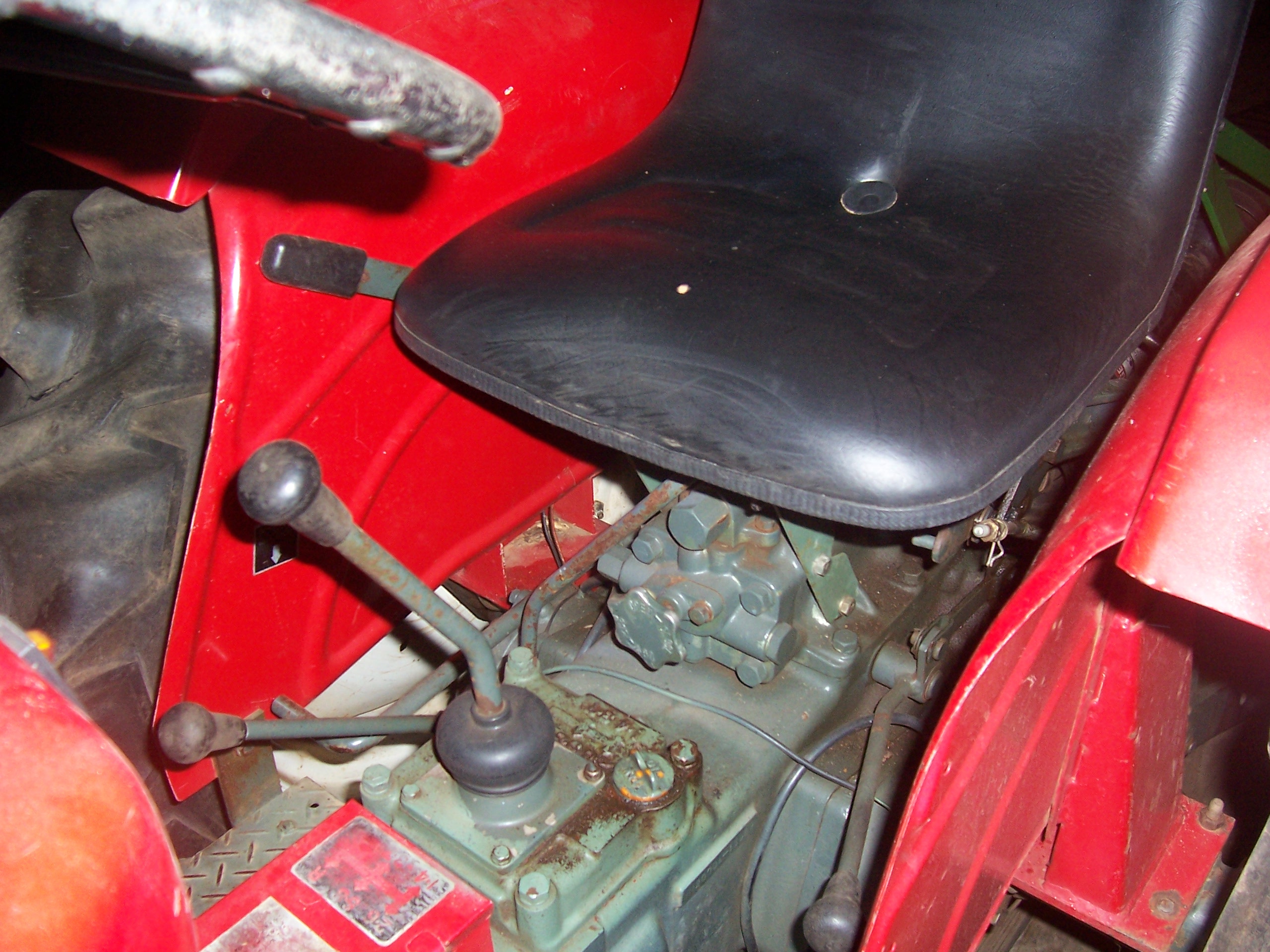

Can someone please send me information and or pics on the location of transmission dipstick on yanmar 2000. Thanks.
   / Transmission #2

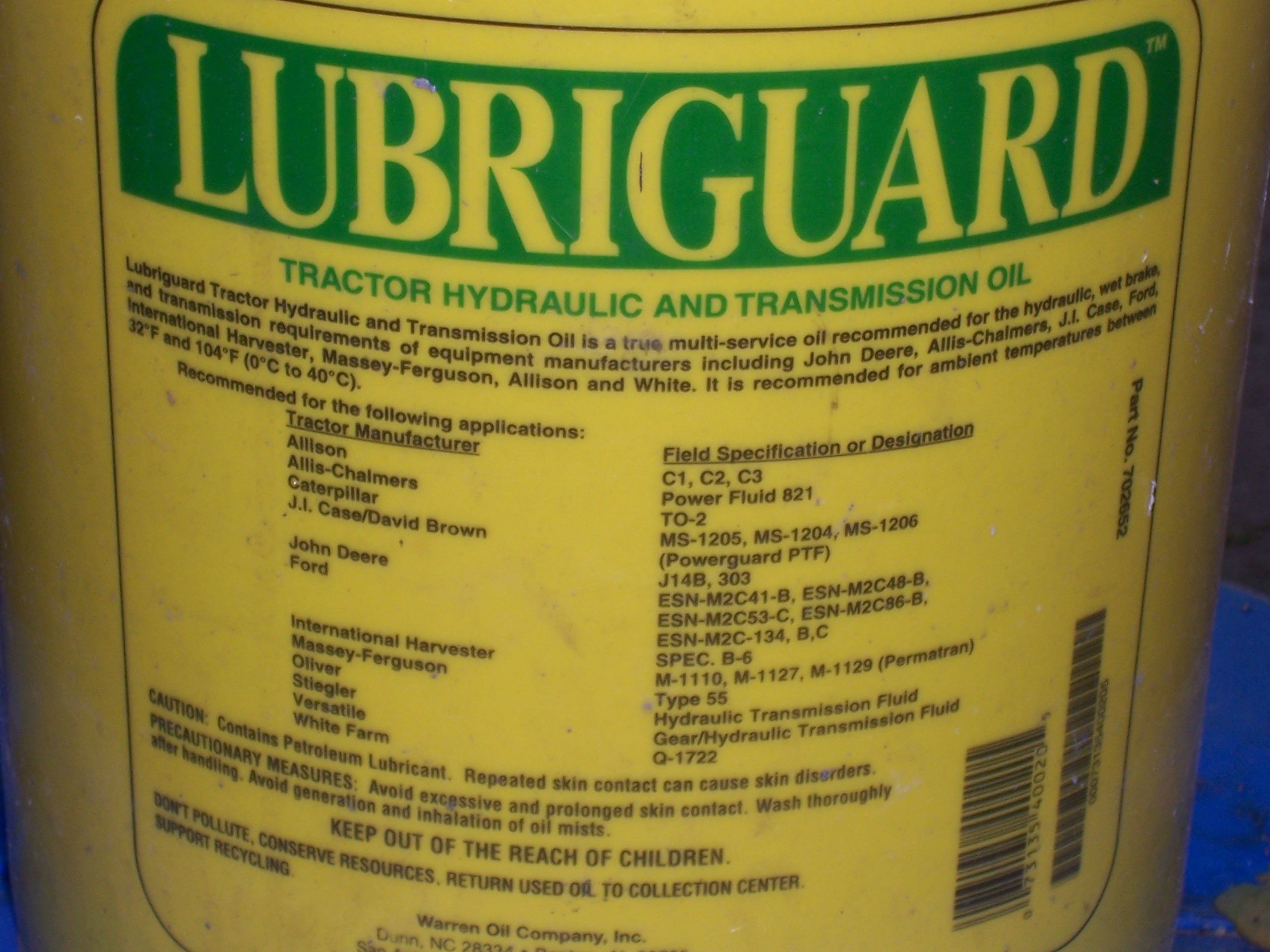

Next to the Shifter. JD 303 or equivalent around 4.5 gal. I just picked this up at Walmart.

Thanks a lot. I thought that was it but I thought that maybe for the PTO?
