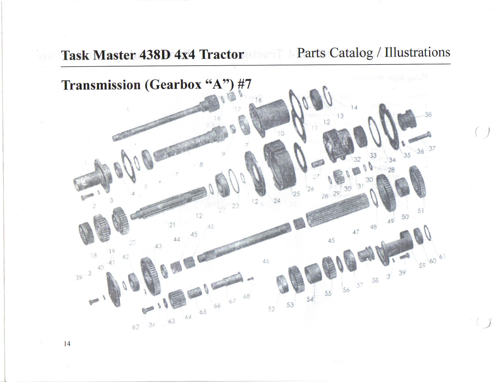

Hi i have a taskmaster 438 made buy dfam i have the tractor split and have got the out side seal out does anybody have any idea how to get the center seal out ,get the out side splined shaft off the tractor thanks

Thanks for the reply Greg if i remember right .I have seen your post back from the new york board back when i first got this tractor and had some problems but any way i can get picture and copy of manual i will have to learn how to post them here. but i don't think that will help But to more explain i have a 2 stage clutch my transmission seal is leaking a dirt dobber built a nest in the transmission vent last year had small leak found it cleaned it out it has got progressively worse the center shaft seal is leaking bad i can not figure out how to change it can not get shaft out i got the first seal out by taking the bolts out and putting the clutch forks back on and putting 2 hose clamps on the shaft and using the clutch pedal to force it off that is the out side seal but there is a seal between the pto shaft and the transmission gear shaft hope this more explains what i need help with thanks PS I will post this on the other board too.

The whole bearing seat front assembly has to come out part #10. Then you can take the main input shaft out of the PTO input shaft and replace the seal #4 and #9.
Be very careful taking this out and putting it back in. part #16 and 17 are like a caged needle bearing assembly without the cage. The 28 needles and support washers can fall into the case. Pack it full of grease to hold the bearings in for reassembly. Don’t force it, you can easily bend the needles themselves.

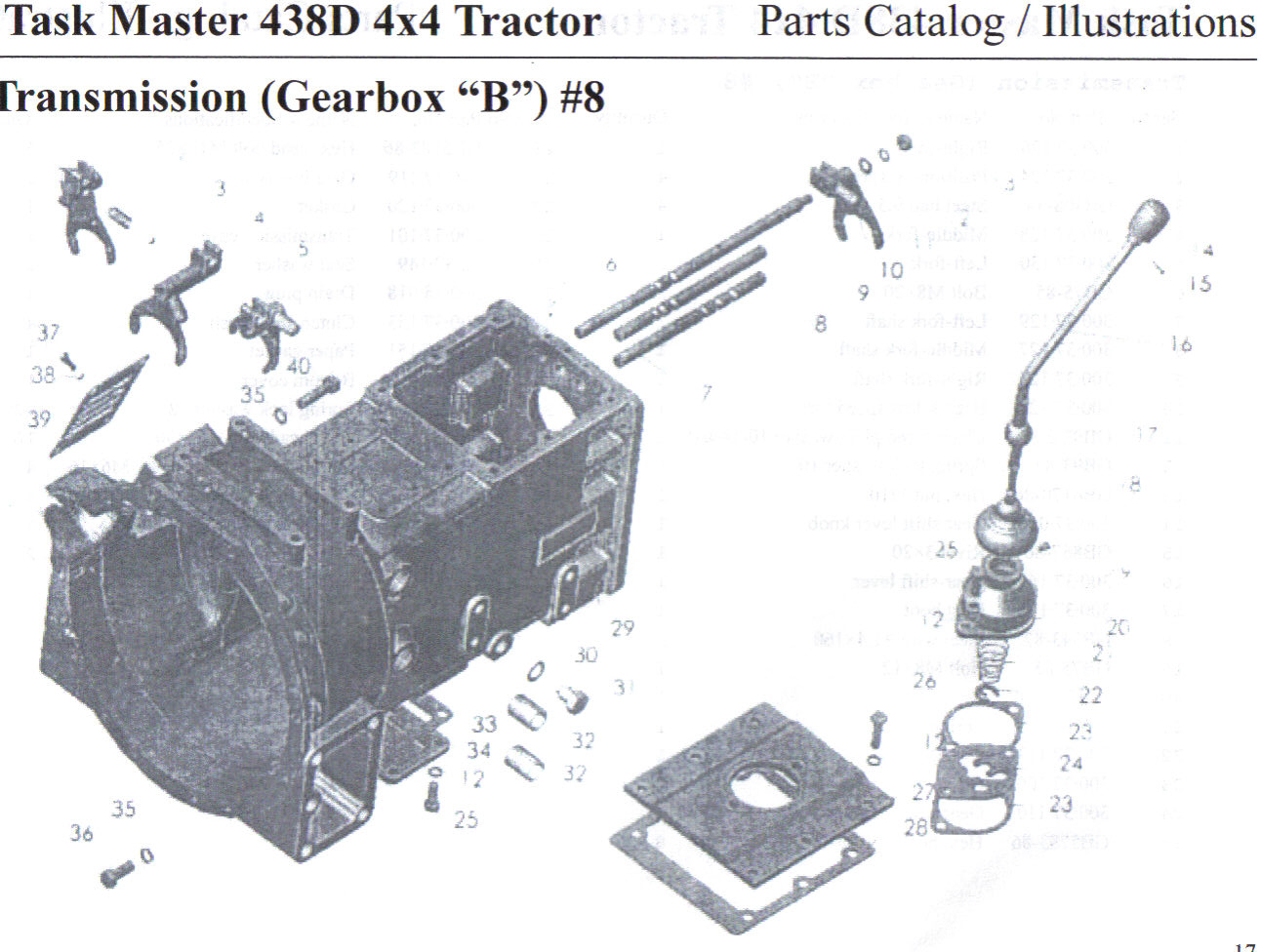

I am still trying to get this thing apart; best i can tell parts 7-17 come out together; i can get it to move about 1/8" but that is it; i guess part number 10 has a grove cut in it and gear number 43 is holding it in; this gear runs up in a hole you can see gearbox b ; the cover for the hole is number 34; if my guess is right; does anybody now how to get gear 34 out? thanks

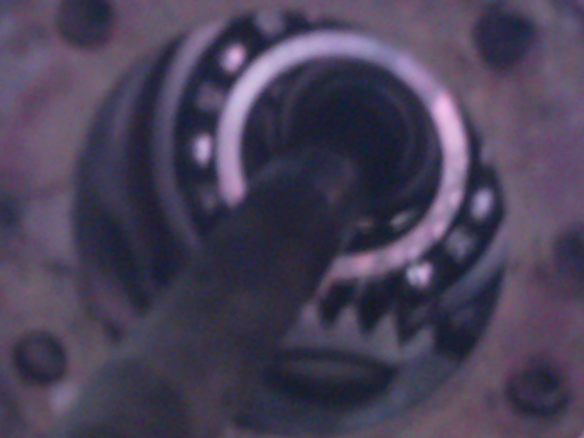

Hi i got this fixed i will give a little info for the next person that has this problem this should help them .You do not have to pull out parts 7-17 to change seal gear 43 would have to be pulled to get it out you would have to disable the transmission to do that.I took a muffler clamp put it around shaft 8 used a gear puller to get it off part 7 and 8 came out part 9 that i need to change stayed in but i got a hook behind it and got it out now i am shore this is where my leak was coming from the seal was 1 mm smaller then the bore in shaft 8 i hope it shows in the pic where it has been turning in the bore where it should have been turning on the shaft. Hope this helps some one else it they have to do this .
