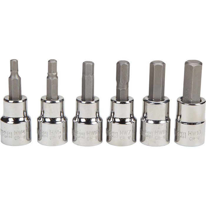

It sounds like you need a set of these Gary.

Hello Gary....
Good writeup! :)
I am about to do this on my parents Ferris.
D you remember the size of the hex plug by chance?
Thanks.........
