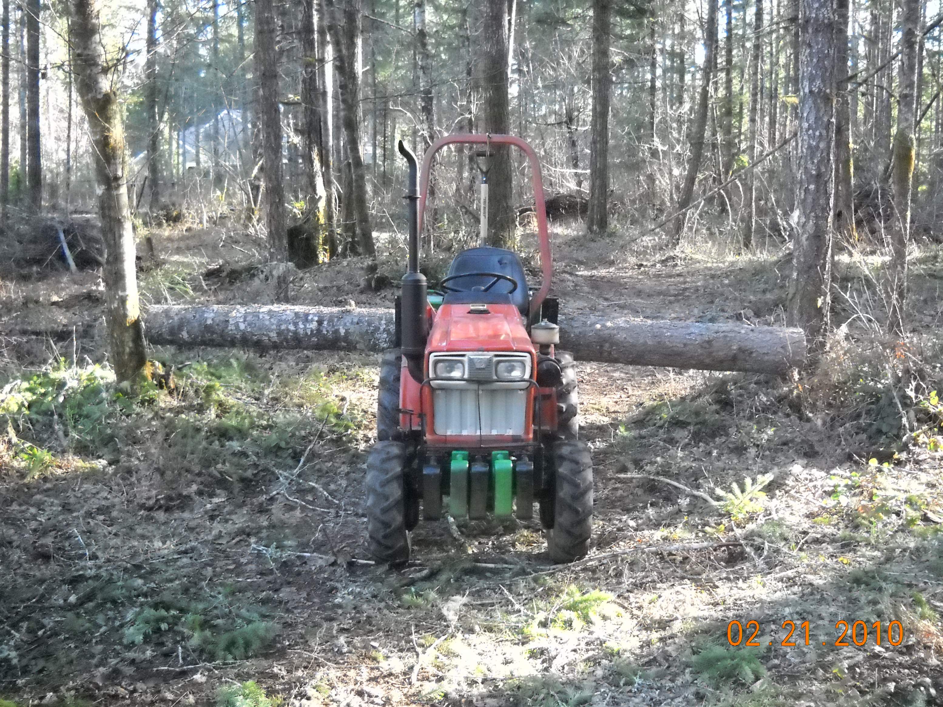

My yanny does that too. but when I cold start it and that small amont of coasting when you let off the clutch in a little mound of dirt or something. It stops when I push in the clutch so it makes sence it is in the tranny. Its nice to know that is is normal. It did it just last night too when i used it in my small logging operation. I was impressed with some of the logs that little tractor could lift.
