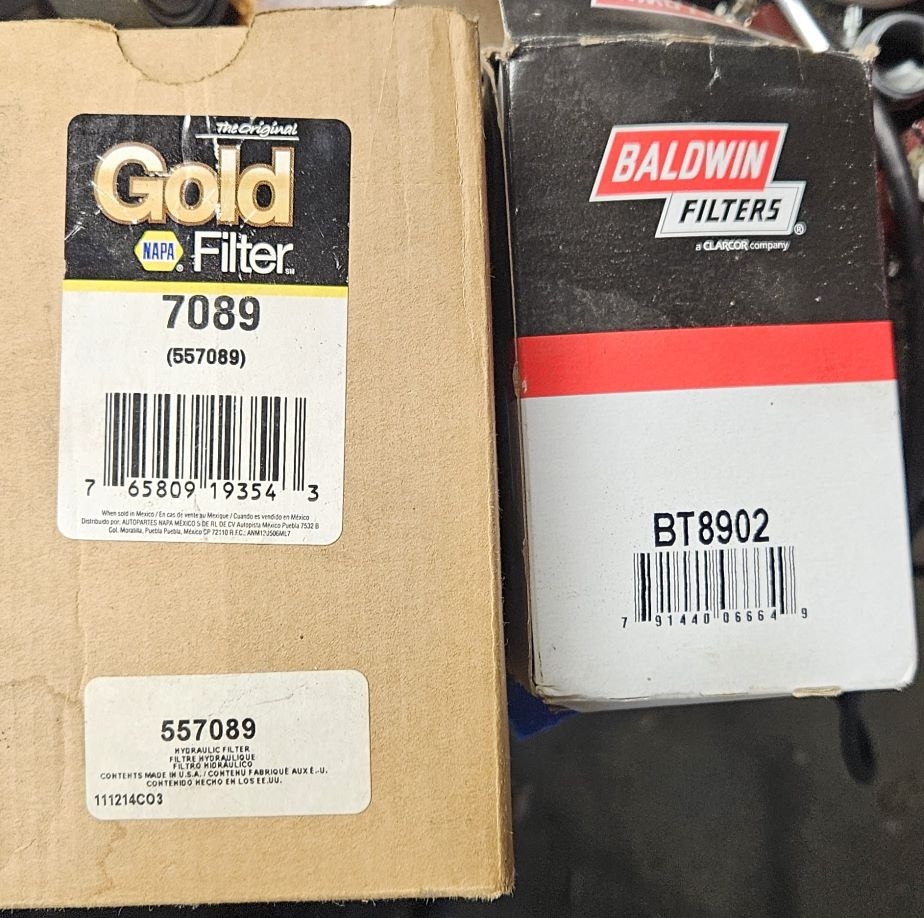

I'm not sure anyone ever found a direct after-market replacement for the transmission filter -- best bet is probably a dealer. Dealer prices on parts for these things tend to be exorbitant generally -- OTOH, you won't need to change transmission fluid that often.
   / transmission/hydraulic filter gc2310 circa 2006 #3
Amazon now shows some "compatible" Chinese filters, if saving $12 means a lot to you.
As Irving said, there are no officially cross referenced filters.
Some people use the Kubota BX aftermarket filters, which are not exactly the same. But, do fit, and may be close enough.
   / transmission/hydraulic filter gc2310 circa 2006 #4
I have used the filter from the boxes in the picture in my GC2300 over the years.

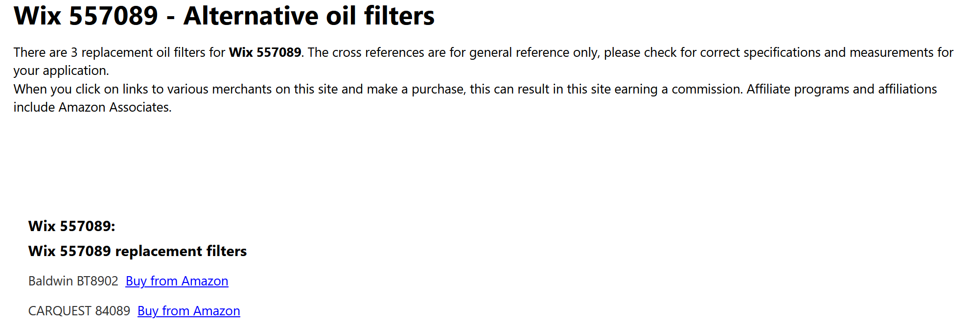

Ray after your post, I did some searching to compare and unfortunately not many list detailed specs. I have been using the filters in the boxes I showed after doing this GC2300 broken hydraulic oil filter flange because the threads were closer to the top of the filter and I preferred that. One of the those I showed was actually purchased from my Massey dealer when I purchased an extra filter (Unfortunately I don't recall which one) when he showed me the threads were the way I wanted.
I did run across this though Oil filter cross reference which provides more info on cross reference than my original post.
And this 4265229M92 Hydraulic Filter - Maple Lane Farm Service.
Hope it helps.
Lou

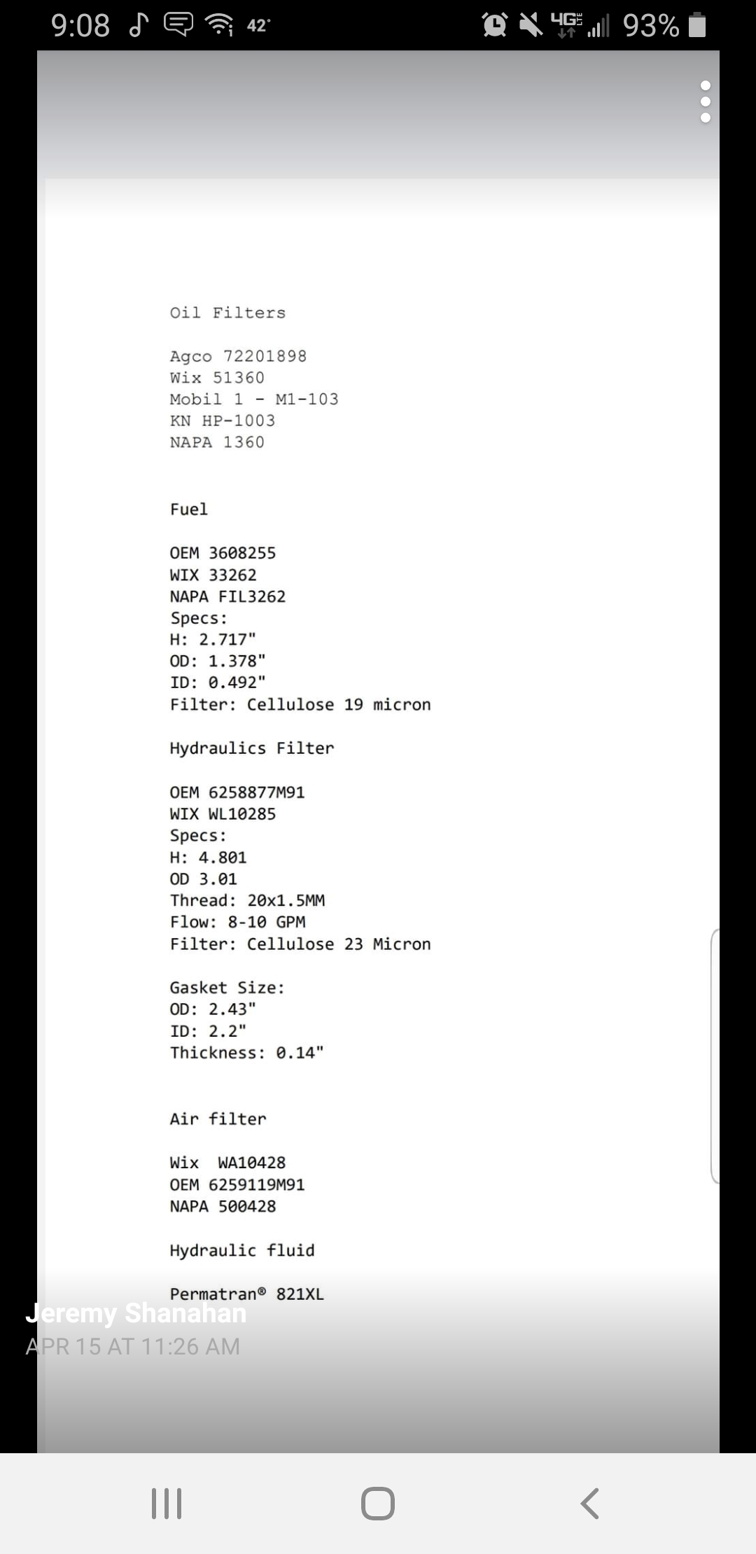

Do not go by "Oil Filter Cross Reference". They have been proven unreliable.
As an example, they once listed several Fram engine oil filters as crossing over to the MF filter, for the GC.
I asked Fram, to check them, and determine which is the best oil filter for a GC. They bought a MF filter, and tested it. They concluded there is NO oil filter in their inventory, that meets their criteria, to cross be referenced for use on a GC.
They said sometimes it's just a overall size issue, and they won't speculate if it's okay. But, they never gave me any specific details.
They also said, they would not consider making a filter for us.
   / transmission/hydraulic filter gc2310 circa 2006 #9
I have had this saved for years now. Is the info on this not accurate?
