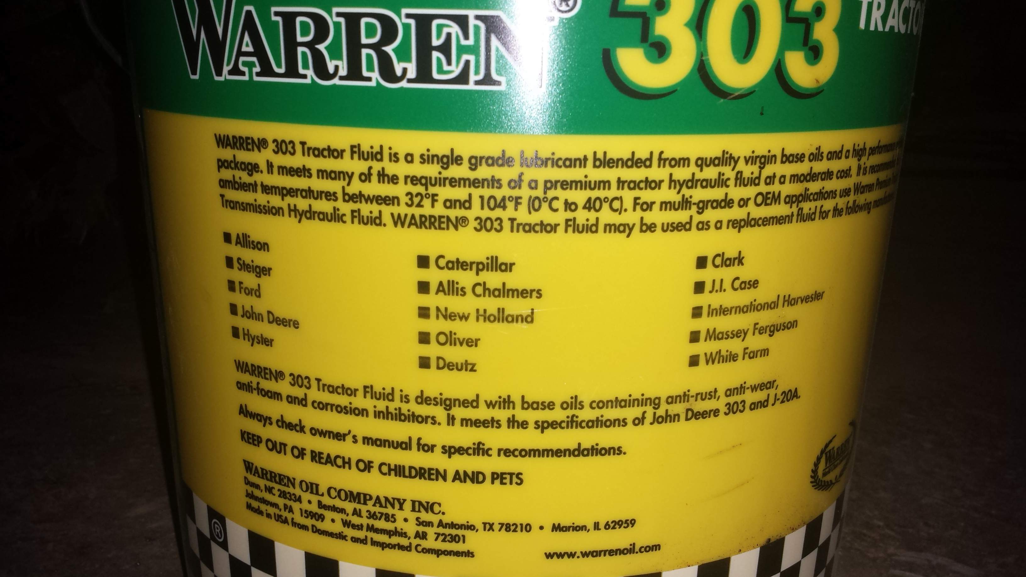

   / Transmission fluid for Massey Ferguson 1030? #4
