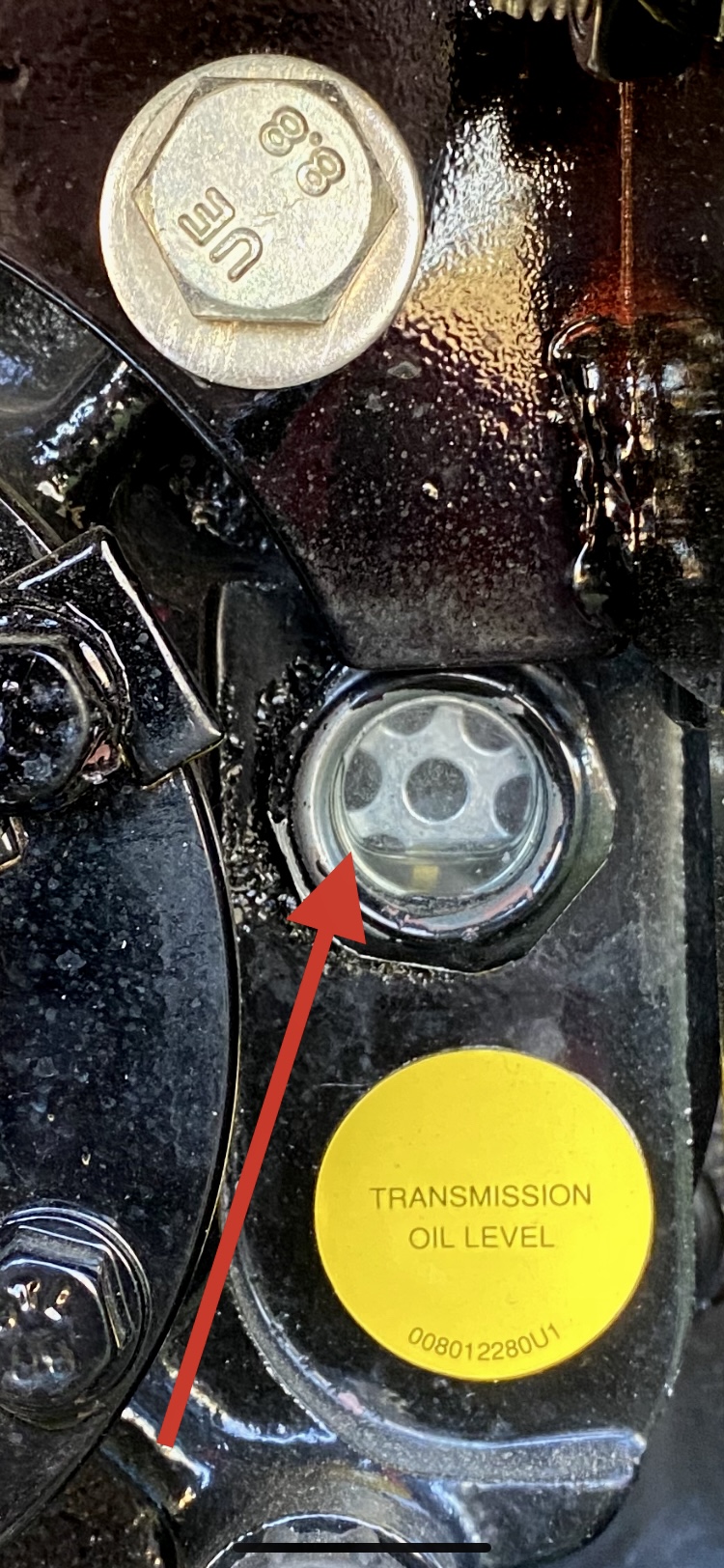

Just got this tractor and I'm going over it just seeing where and what everything is. I came across the round glass window next to the PTO that states transmission oil level. The engine has been off for twenty four hours so can someone tell me if this is the correct level cold and off? Thanks so much!

If it’s similar to the Branson, it should be at the halfway level. Your owners manual should give you specific answers.
   / Transmission Fluid Check on a Mahindra 6065 #3
Make sure the tractor is on a level surface. Since the sight glass is at the very end of the tank, a small tilt up or down can make a big difference in the reading. Lower the FEL and 3pt so the oil in those cylinders is in the tank. There's enough to make a difference.
