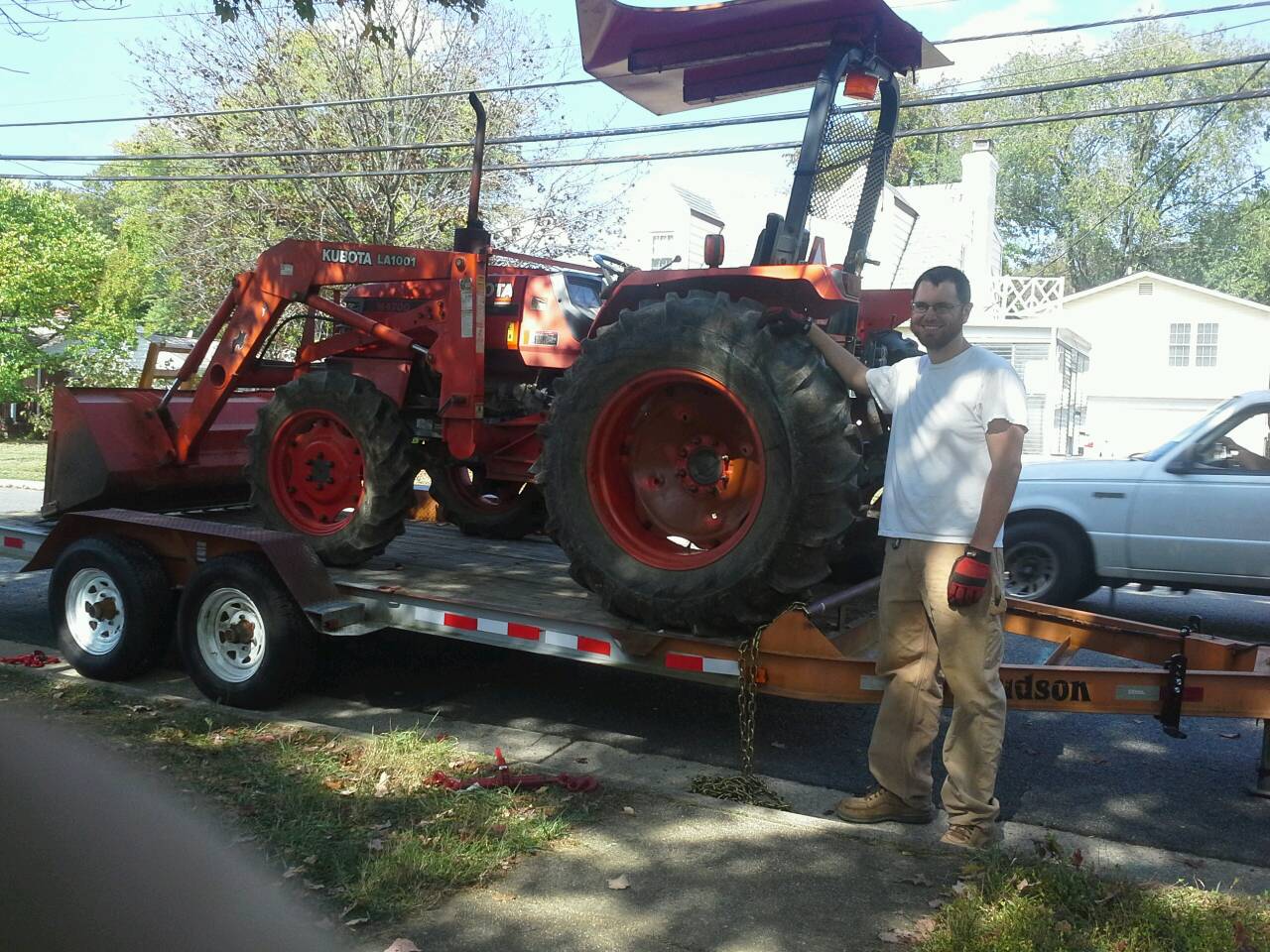

I know there was a thread on this last year but I CAN'T find it.
Tractor/trailer:
Tractor (4K lbs) w/ FEL (1.6K lbs) and loaded rears (1.3L lbs) I'm guessing at about 7.5K to 8K lbs, with a little fuel, chains etc.
Trailer 12K Hudson, w/ wd hitch
Tow vehicle 2002 F350 7.3 dually, w/ only about a 2K lb payload.
I've taken the canopy off for travel.
It fits either way.

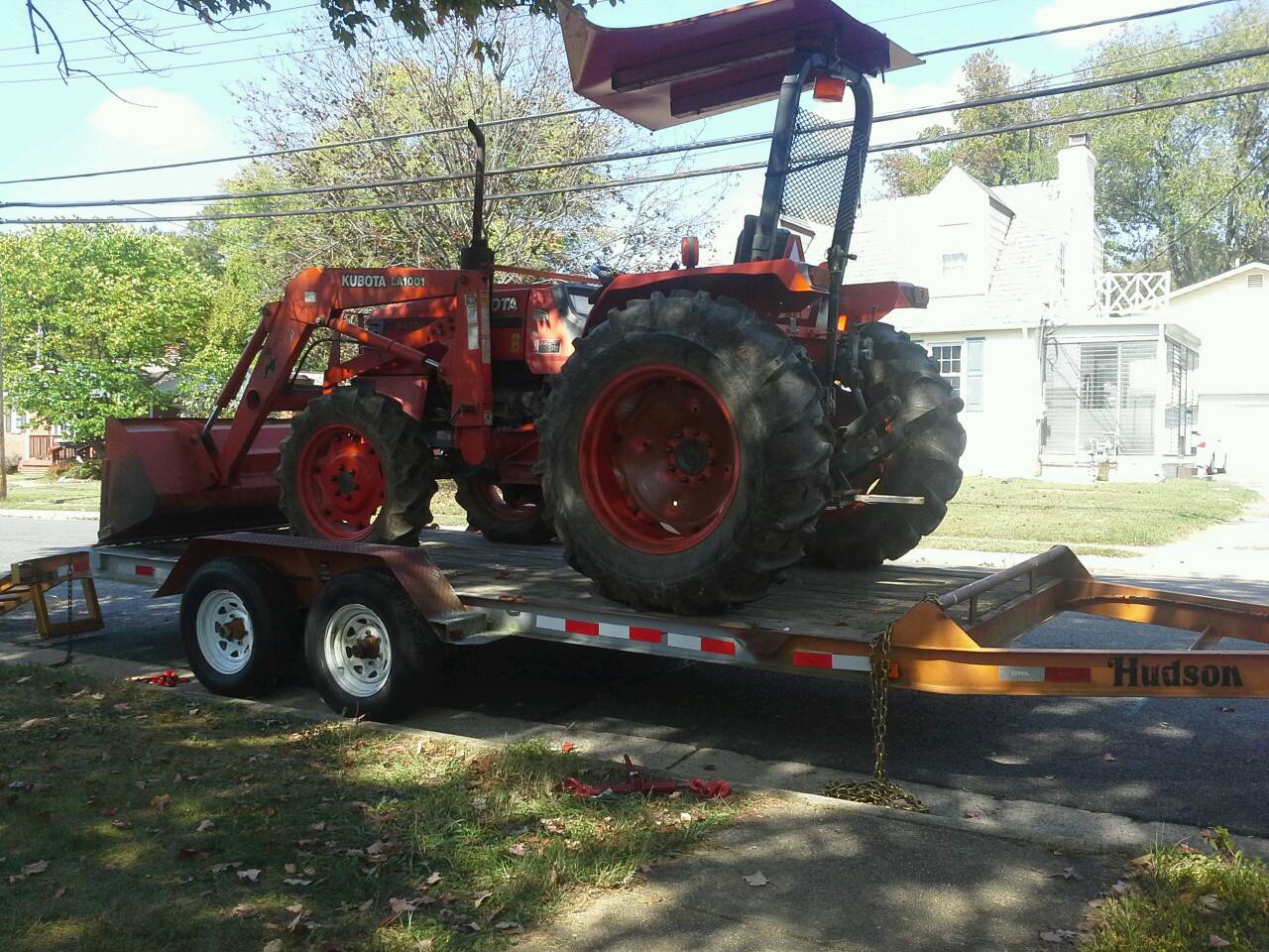

The butt of my dually sinks 2.25" with the tractor backed on all the way
This is the "heaviest tongue weight" and I suspect about 15% based on my other playing around w/ tongue weights.
It sinks 1.25" with it backed on
And with it pulled all the way forward, as in the first pic, w/ bucket over the frame it sinks about 1.75".
So I can put it on either way. What does the collective TBN mind think is better? Forward or backward?

My tractor is not as heavy as yours (about 4600) but I tow mine facing fwd. I have a 20' trailer so I can move fwd or back to change tongue weight. Whatever works best for you is ok as Long as you have enough tongue weight.
   / trailering with the Tractor facing forward or backward? #3
I haul on a deckover dually GN. I can place the weight wherever it's best hauled by placing the tractor at different spots on the trailer, just as you can do. For me, it's easier to back "off" the trailer than it is to back "on" the trailer. So I always load facing forward. Nothing to do with weight distribution.

It doesn't matter to me as long as the tongue weight is right. I see a lot of cases where it's obviously way off (and many pictures here on the forum of first time owners bringing home a used tractor where it's real obvious the tongue weight is wrong). I'd rather have part of the tractor hanging off the back, or part dangling over the front of the trailer if that's what it takes to get tongue weight right.
You can buy a tongue weight scale, or rig up a method with a bathroom scale, some bricks, and a board (setup as a lever to limit what the scale reads to it's range). I've never done that myself, but wondered. What I did early on was to eyeball the suspension drop with my empty trailer, and then let it drop a little more with the tractor on (knowing the weights of both situations and aiming for 10% or so). Springs do compress linearly, so it's possible you could calibrate a method based on drop alone, if you have the time.
At a bare minimum, you should see more drop on the loaded trailer than the empty trailer. That's a basic sanity check. Common sense, but I see loaded trailers with too little or negative tongue weight all the time, so obviously folks don't check that.
