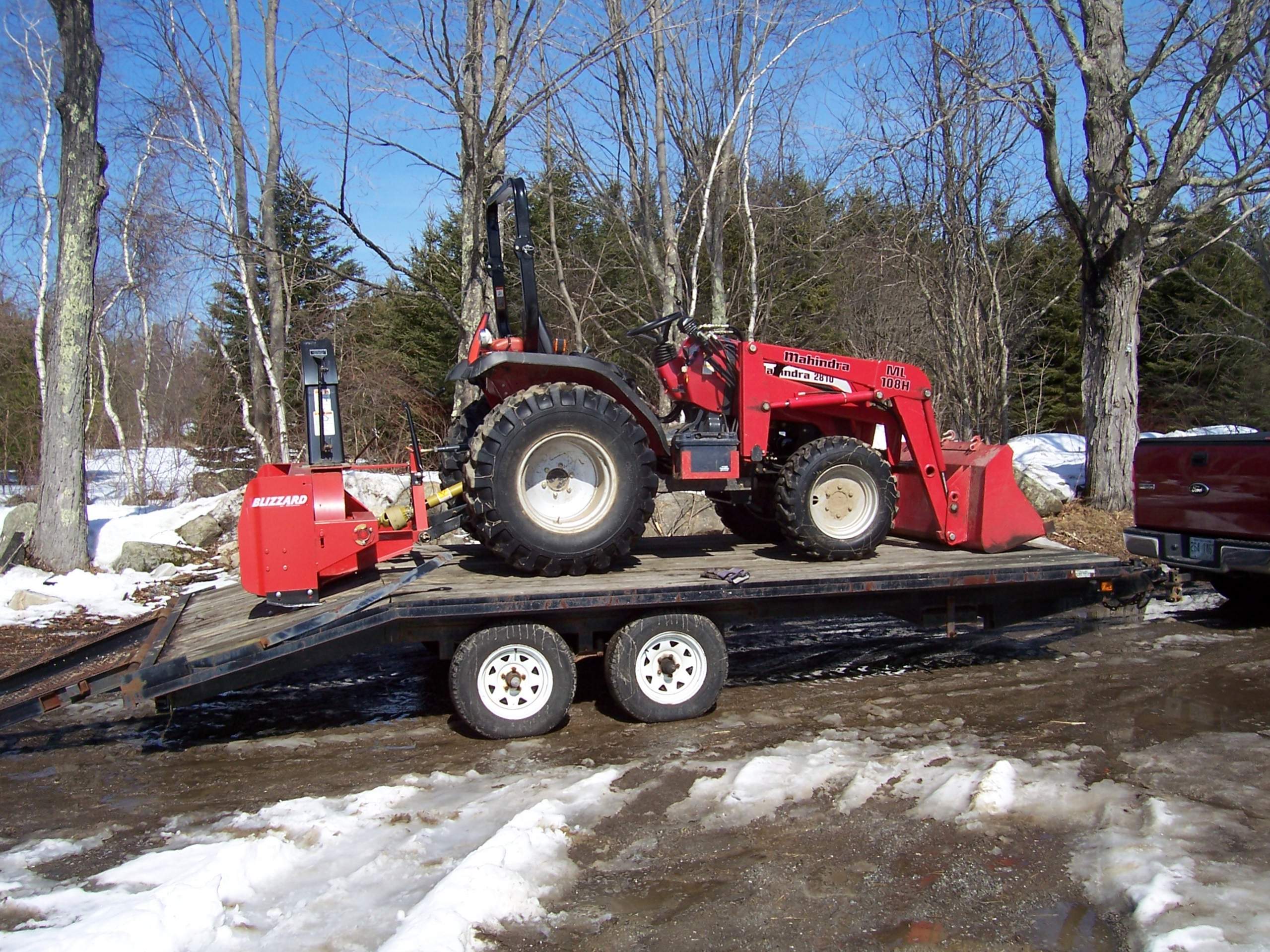

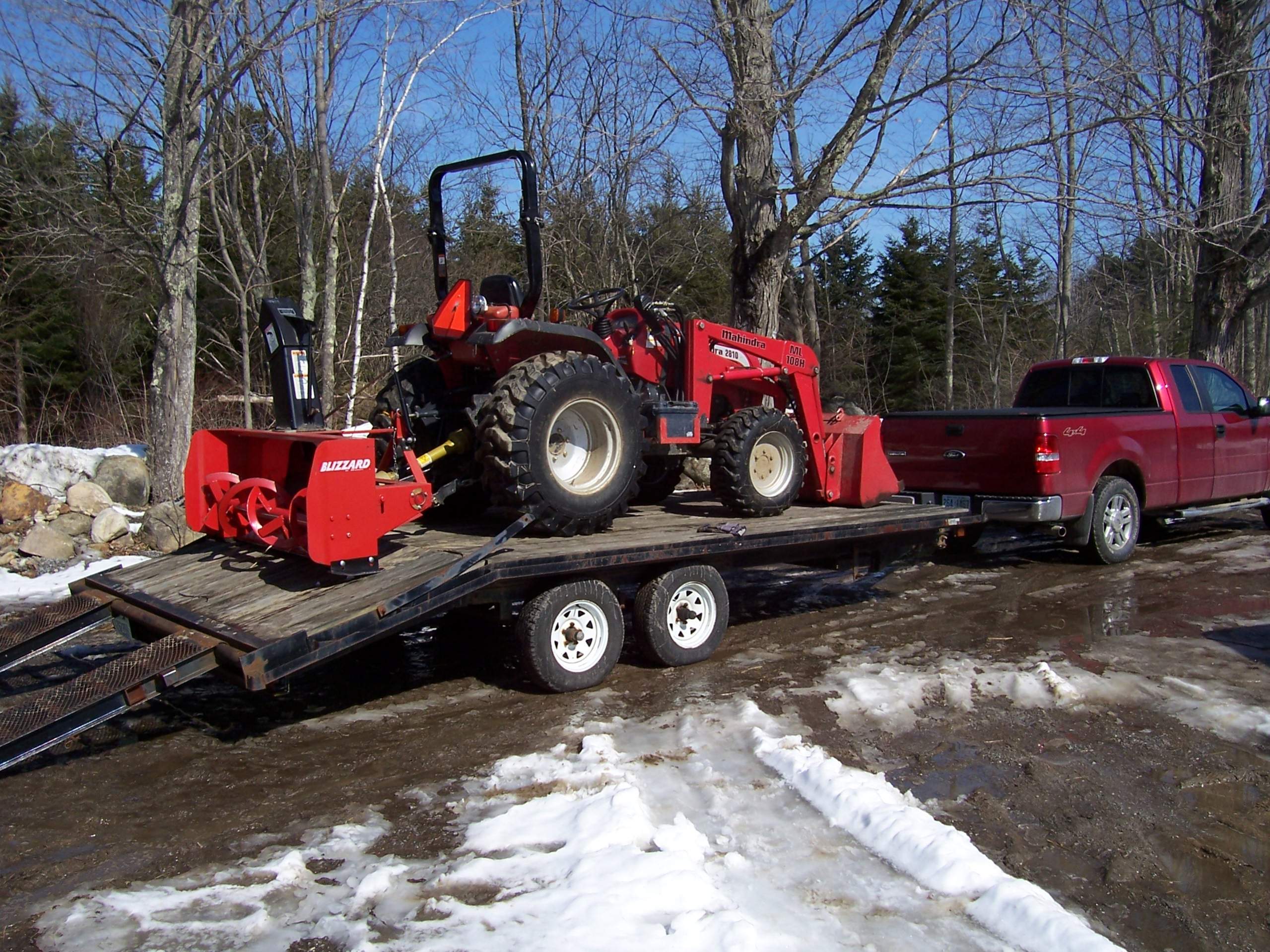

I converted my trailer over from the 6way plug to the 7way RV style to match the truck. Lights and brakes work as they should. The black wire from the truck has power when the truck is running. I think its for the break-away brake battery, but would like confirmation. The trailer does not have the charger for the battery and I assume I'll need that and cannot hook the black wire directly to the battery. Please steer me in the right direction.

Im reading from my BIG TEX TRAILER book.It showspics of 4,7semi,6,7rv wiring hookups.It states locates wires by functiononly.Color coding is not standard among all manufacterers.
Ithink you would be exactly right on your blackwire being the correct one,if all your lights are off.

Thanks Willman. I still wonder what to do with the extra hot lead. Do I have to buy a new break-away kit with a charger to hook it to?

You do not need to hook it to any special charger, just hook it to the positive of the trailers battery. It is just like the wire going to your trucks battery but much smaller. As the alternator turns it sends a small charge to the battery keeping it topped off.

Excellent! Thanks Chris.
