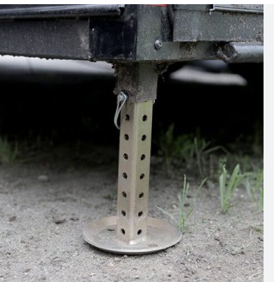

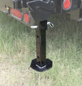

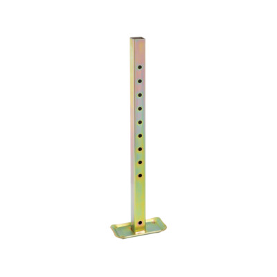

I have a Sure-Trac dump trailer that has square receivers welded on both sides at the rear. There are drop-legs that can be dropped down and pinned in-place to help when using ramps to load equipment. Keeps the front from pulling up on the tow vehicle or can be used without being hitched to a tow vehicle -- as you're wanting to do.
It's a good plan. If you don't want to make your own, there are plenty available. I did a quick search. Here's a couple. On the Sure-Trac site, they're called "Rear Trailer Support Jacks" and show as an option on most of their dump trailers.
Just weld square tubing to accept the drop-legs and you're ready to load it. Chock the tires good!

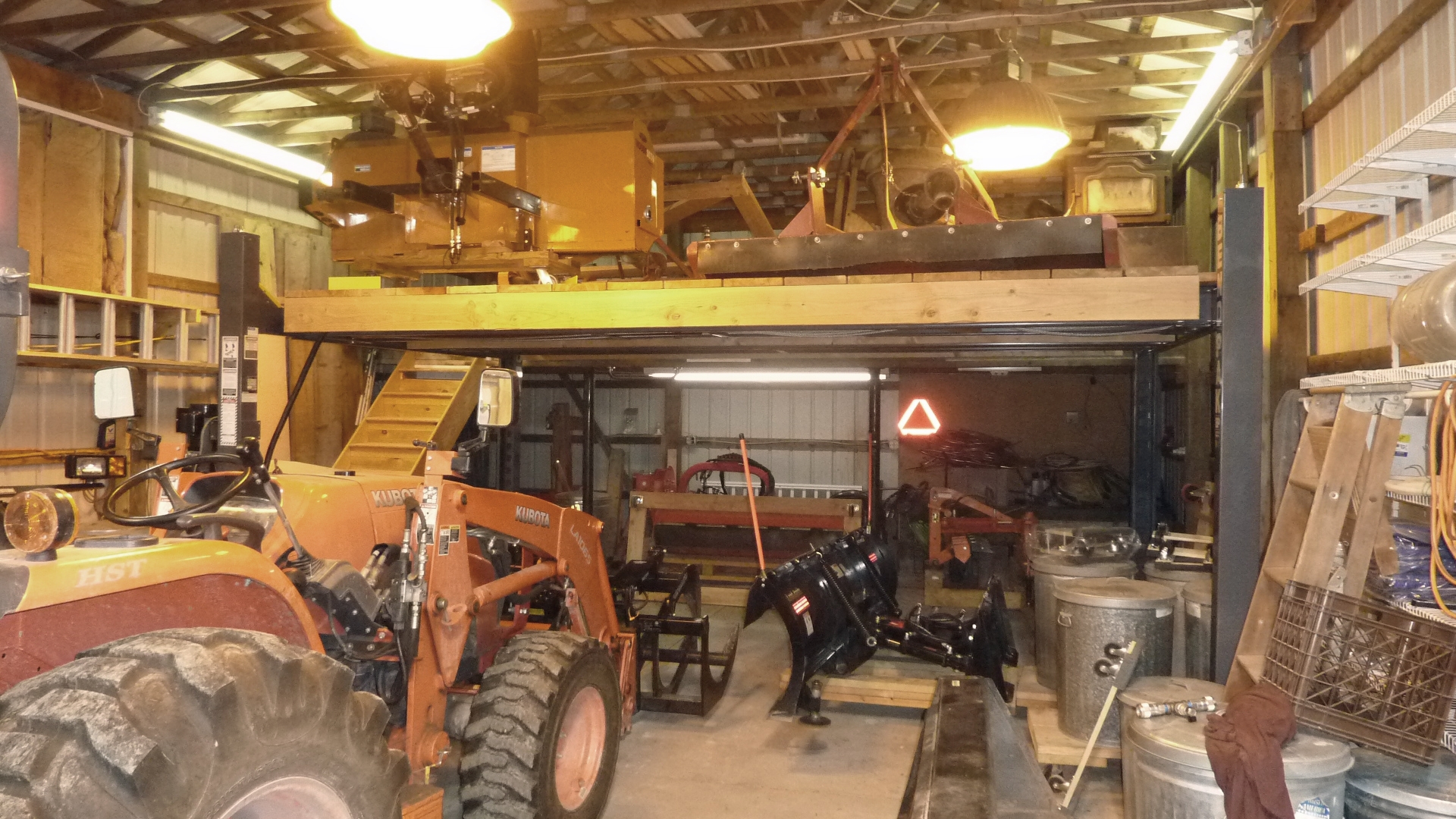

What is the ceiling height of you shop? Could you use a 4 post lift to store implements off the floor and park the tractor underneath?
Not cheap by any means, but the lift can be used for other purposes as well. I have 3 of them which wound up being cheaper than putting up a new building.
