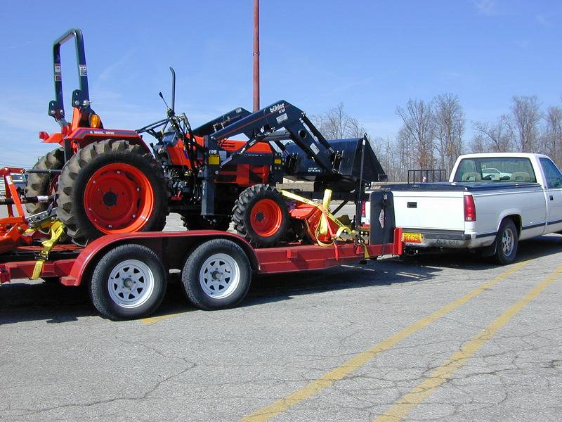

   / Trailer to transport a CK30HST ? #8
Heres a picture of mine. Its a LK3054. Everything that is on the trailer is a 6' Buhler finish mower attached to the tractor, and a 56" tiller, 72" box blade in the front under the loader. The tires on the tractor are filled. Its a 16' trailer with 1 axle brake. Pulling it is the mighty 1/2 Chevy 2wd with 5 speed and 350 engine. The photo was taken when we bought the tractor on the 700 mile journey home. Got 13 mpg on the interstate. Not too shabby for a $3000 truck.
thx
Jim

   / Trailer to transport a CK30HST ? #9
That's a big tiller. /forums/images/graemlins/grin.gif
