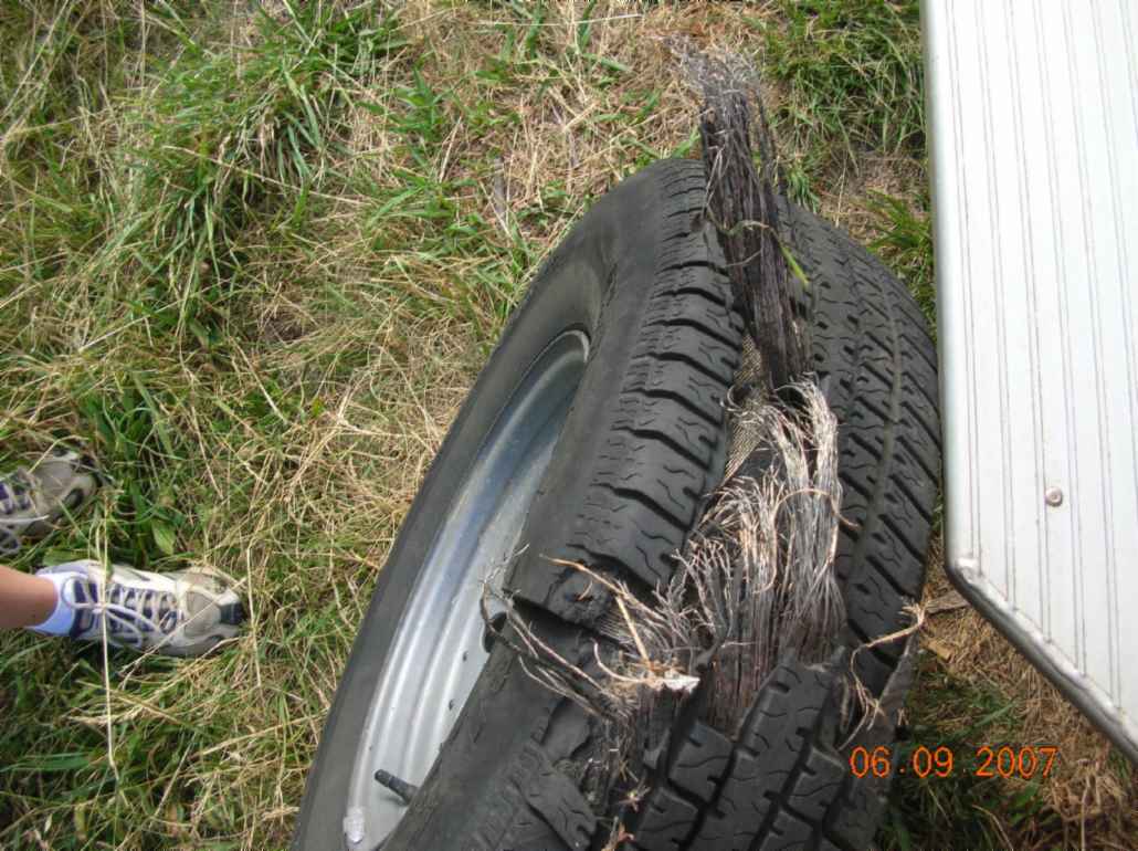

I had a horse trailer that had about 120m on a set of perfect looking tires.. they were unfortunately 5ys old.

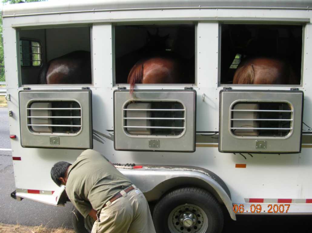

as i was hauling a sick horse to the hospital.. i had a blowout getting on the interstate. was a tad difficult changing the tire on a trailer loaded with equine...

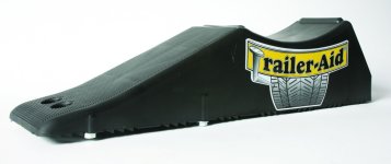

Soundguy ... From personal experience. Get a "trailer-aid" or make a reasonable copy. I've changed tires on a loaded horse trailer in 10 minutes at the side of the road. Much safer than unloading and chancing a loose horse.

i've considered buying one.. but the weight ratings i have seen were way too low to be usefull to me. I could make one i guess though..

Those three big butts are only supported by a plastic "trailer-aid" under the good tire. A bunch of staggered 2x6's stacked together are a cheap and sturdy substitute. Heavy though. The plastic version is light weight & easily handled.
