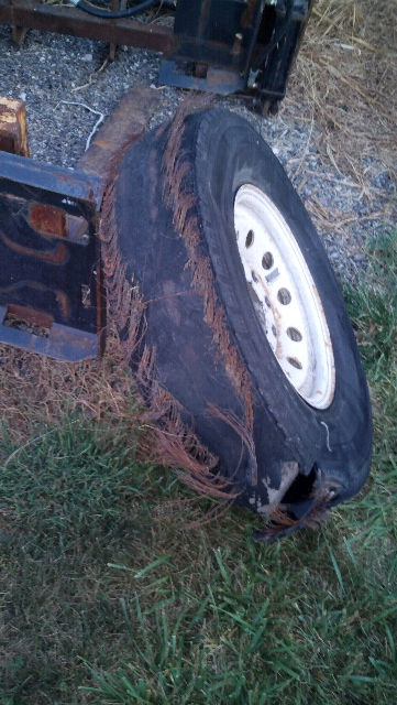

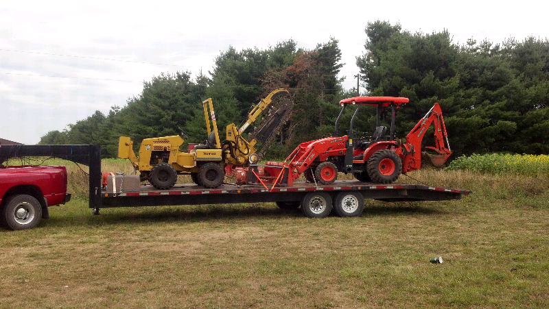

I have a gooseneck with single 8K axles that I have been using goodyear load range G tires on that are rated for 3750 @ 110psi but they are about $325 each :eek:
The local tire shop pointed me to some Hercules load range F 12 ply tires that are rated for 3960 @ 95psi. for about $150 each.
Most of the time I am running about 7 ton on the trailer and some on the gooseneck but have gone up to 12ton on trailer, with the goodyears I have never had an issue with heat or blowouts tried a set of 10plys and planned on running the trailer a little lighter but they didn't make it 2 pulls with bout blowing out.
Any thoughts or comments? Anyone use the Hercules tires???? I don't like spending double if I don't have to but don't want to blow out the cheap tires then buy the goodyears like last time.
Only issue with the current goodyears is that they are 5 years old.
picture of everyday load which puts about 13,800 on the trailer axles per scales
second photo is of what a 10ply does when overloaded

What size trailer is this? As heavy duty and well built as it looks to be , seems like it would have 3 axles, giving the ability to better distribute the load, as well as having only to run 10 ply tires,

Goodyear did have issues with the G614 LT235/85-16 G load range which is a 14 ply rated tire. Sometime in the late '08/'09 era they gave them a re do and seems to have fixed their issues. Tires on a trailer need to be ran at max pressures so whatever tire you choose keep them pumped to the max.
Trailer wheels are narrow so match the tires tread width to the wheels width for best load carrying performance.

The trailer was a custom build I put extra heavy axle tubes that were rated 10,000 with 8,000 oil bath dexter hubs and the springs were 10K. The frame is all tubing design for commercial use all is over built. If I build/buy another I think I would go with 17.5 or 19.5s I had a tri axle trailer and never again bent the axles several times.

Ran across this on Discount Tires web site:
Trailer Tire Applications
謬railer tires are designed for use on trailer axle positions only. They are not built to handle the loads applied to, or the traction required by, drive or steering axles.
Inflation
柊lways inflate trailer tires to the maximum inflation indicated on the sidewall.
匹heck inflation when the tires are cool and have not been exposed to the sun.
肘f the tires are hot to the touch from operation, add three psi to the max inflation.
俵nderinflation is the number one cause of trailer tire failure.
Load Carrying Capacity
柊ll tires must be identical in size for the tires to properly manage the weight of the trailer.
謬he combined capacity of the tires must equal or exceed the Gross Vehicle Weight (GVW) of the axle.
謬he combined capacity of all of the tires should exceed the loaded trailer weight by 20 percent.
肘f the actual weight is not available, use the trailer GVW. If a tire fails on a tandem axle trailer, you should replace both tires on that side. The remaining tire is likely to have been subjected to excessive loading.

Are those 16" tires?
I kept blowing mine with a similar load so I bought 17.5" wheels. They were around $100 a wheel and I can get 17.5 tires rated for 4800lb for $200. Similar price to your good years but a lot stouter and should last a lot longer. Also after you buy the wheels the tires are cheaper. I like having the safety margin.
