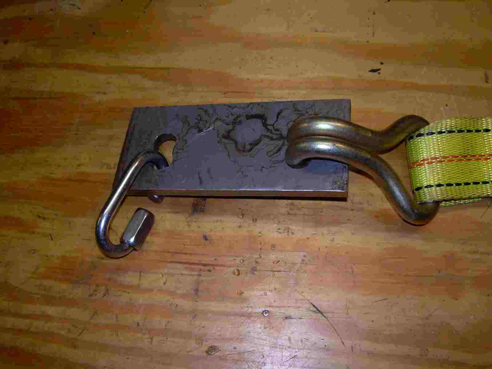

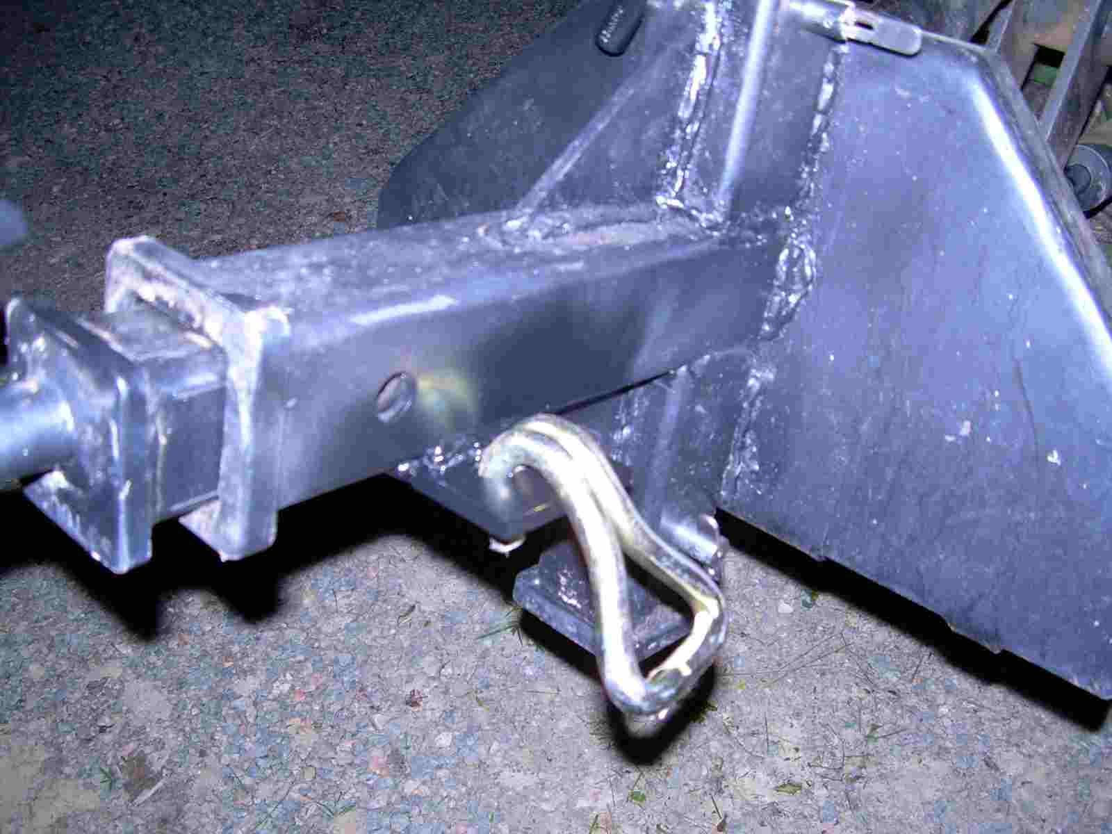

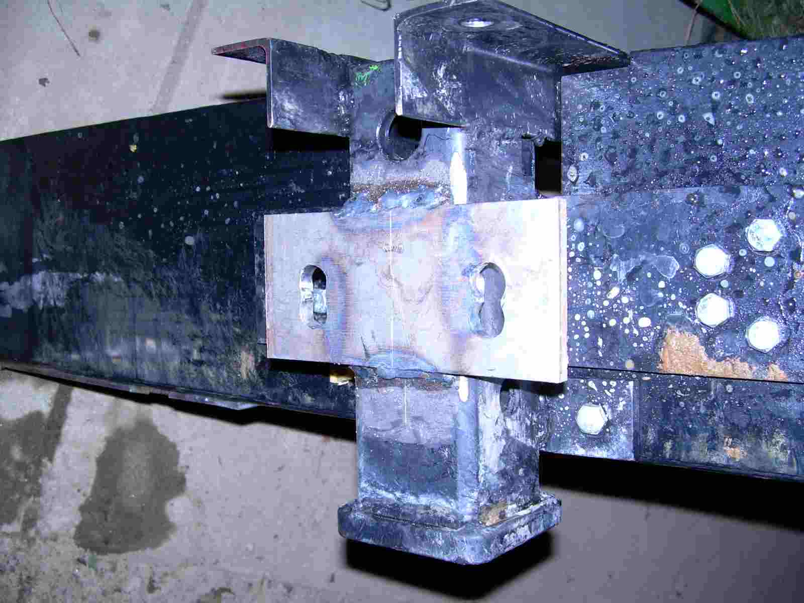

My thanks to everyone for their comments. I decided to use the axle straps around the ROPS supports (thanks Trac Doc) for the front. I made a tie down bracket which I mounted to my rear 2 inch receiver. Basically this allows me to use straps with hooks or chain link. When pulling a trailer I will be able hook up it's chains as well.
