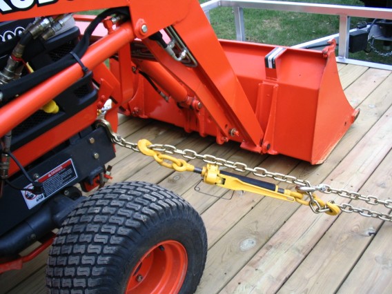

If your looking for new binders, I just bought a set of these Quikbinders by SCC SCC Quikbinder
I bought mine on EBAY from the seller Cargosupply out of Oregon. I bought 4 for $96+ shipping. Cargosupply Auction on Ebay
They are very nice being able to free spin them to take up slack quickly or loosen quickly. The handle also folds over so you can put a lock on to help detour theft as well as lock the latch in the tighten position.
Here's a picture of one of mine.

</font><font color="blue" class="small">( If your looking for new binders, I just bought a set of these Quikbinders by SCC )</font>
Those are nice binders. I don't have the fold over on mine, but it's not a problem. I can free spin them though for quick tightening/loosening.
John
   / trailer specs for my new ck30 #9
Yeah I have just gotten them, so I don't have experience with them yet other than tying down this 1st time. Hopefully they will hold up well. I really like the free spinning as the black part of the handle is textured and easy to grip.
I will be using them pretty much every weekend this Summer though as I will be towing about 180 miles a week to mow the lake property as well /forums/images/graemlins/grin.gif Selling my old Cub and already sold my old Snapper so it's just the Kubota for yard duties soon!
