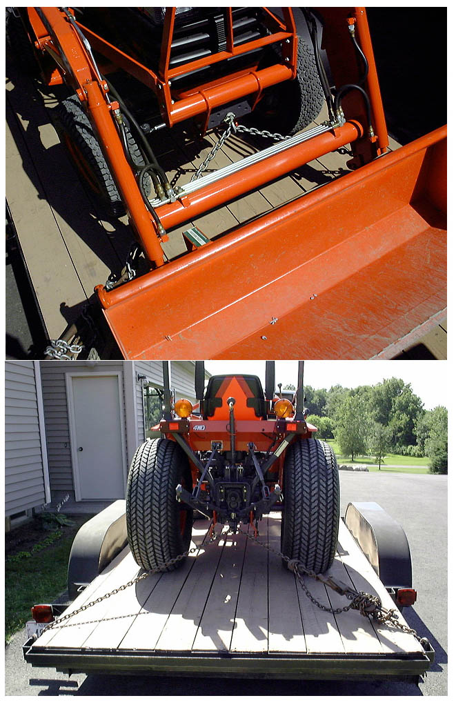

I to use a 16 ft. trailer rated at 7000 lbs. brakes on one axle, to tow my B2710. I have just enough room when I have the FEL and brush hog on. and I use the wife's Jeep Grand Cherokee with 6 cyl. to tow it. I use it about once a month and go about 24 miles round trip. (I have attached a photo, but it does not show the whole trailer). I think you will not need anything bigger than a 16 ft. trailer for a B2910, unless you have a backhoe and what to carry some other implements at the same time.
