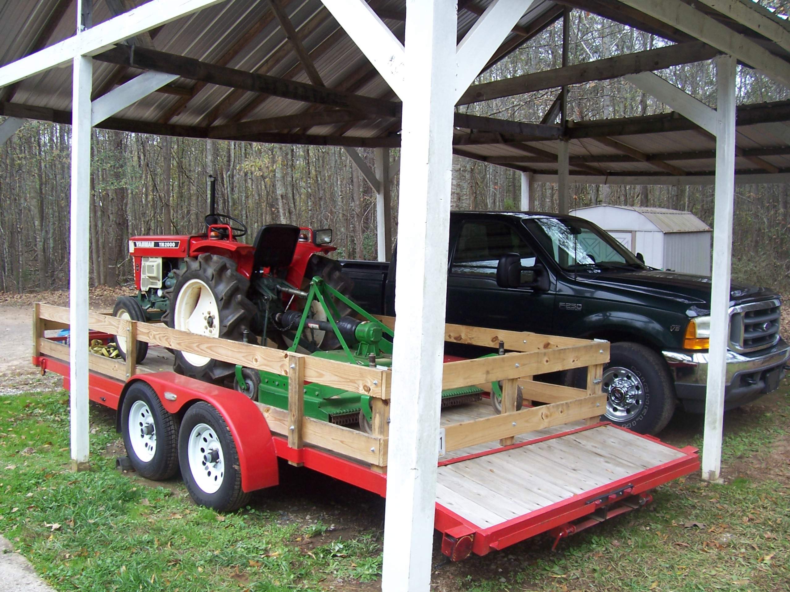

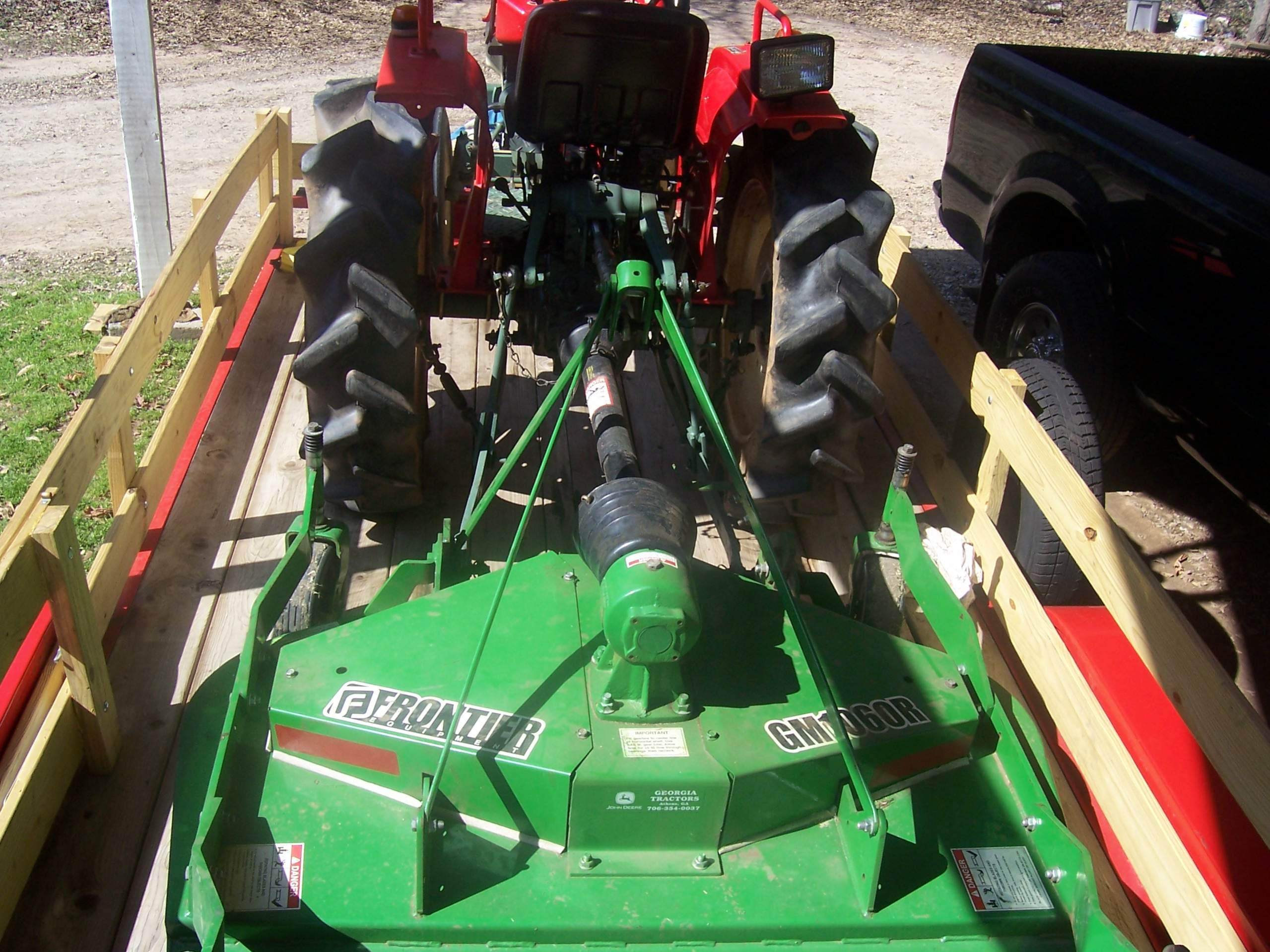

If you plan to add a FEL. IMO. 18' would be a good size. Here is a pic. of a 20' dove tail, 2' is the size of the dove tail so 18' deck. Pulls and hauls great. I have one other trailer 10' but not a DT. I use for around the property or I'm just to lazy to pick it up and put it in the back of the truck. The DT. is the way to go for loading Vehicles.The ramps on my 10' are a PITA. my thrill seeking wheelie days are over:rolleyes: Kidding. Just need to be more careful of the deck height loading on flat beds with implements or weight attached on the back of the tractor .
What is loaded is a YM 2000 and a 5' Finishing mower.If I would add a FEL. and mower attached to the tractor it will still fit easy. I also use it for a 8n with a FEL. that is removed though and is now parked, and a YM 2500 with a 6' bush hog. I would have to remove the back gate if it had a FEL. on the 2500. That doesn't bother me as much as if something was hanging off the trailer:confused: I see your location and you Know as well as I do the way people drive around here and Esp. if I was going towards in Atlanta.

Carey, That is a really nice setup! The 2000 is about 5 inches longer than the 1500. I think I am going to look at 18' long trailers with brakes. I have a 5x10 that will hold the tractor and maybe an implement or two if I stand them up and stack them. But they are heavy and who wants to wrestle with it. I just want to load it and go.
