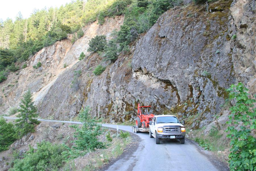

F-250 maybe crew sounds good. Don't ya think? NO you cannot tow that with a Tundra (safely)You need at least a 3/4 ton for all that weight for safty and ease. My good budy went to rent a Bota and they refused to let him because he would have been towing with a tundra.Nothing against Yota's they last ut not long if ya tow and haul heavy loads.
