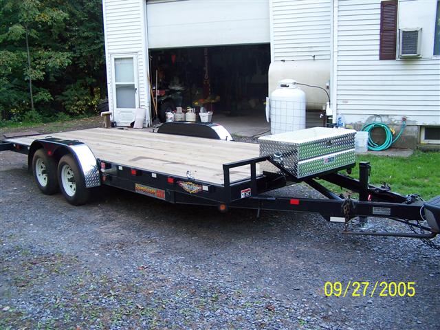

Jim,
I also have the 2500HD w/ Duramax. I bought a 20' H&H tilt bed trailer (attached pic, more in photo section). (H&Htrailers.com) I don't know if you have a dealer in your area, I drove down to PA. to pick mine up. I only got the 7K rated one since it was all I needed. You can haul up to 12K bumper pull or 15.5K fifth wheel so what you get will depend on how much weight you want to haul. Price for mine was around $3400. It has brakes on both, removable fenders, &7k drop leg jack, 14 stake pockets. I added the box with 8000lb. winch inside.
George
