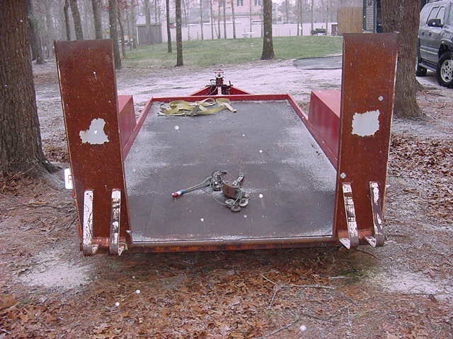

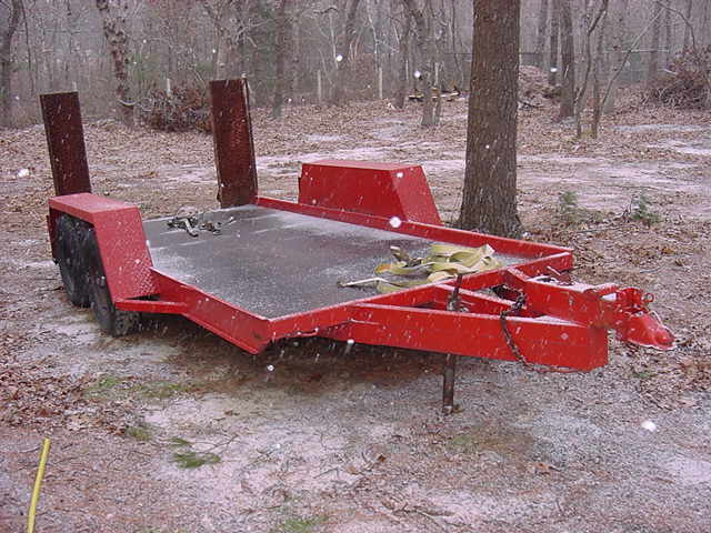

This is a trailer I happened upon. I figured I'd buy it, use it then trade it for the one I want. It is a skid steer trailer that is 13' x 6' 7,500 lb GVW. When I put my CK30TLB the loader bucket has to sit up on the tounge and I have to swing the backhoe all the way to one side. If I have the mower on, it has to sit on the tounge and the bucket beyond the ramps. If I were to put a car on the trailer I wouldn't be able to open the doors. Those are the down sides. The up-sides are, because it is small it is easy to tow and manueverable plus it was only $500! I was in the right place at the right time /forums/images/graemlins/smile.gif

yes..............it is snowing /forums/images/graemlins/frown.gif

anyways............I'm guessing your Kubota is about the same size as the CK30. If I had to go buy a trailer it most likely would have some of these features. Oh yea, another thing, it is a "low boy" style in a sense. The deck is only 1 foot off the ground
