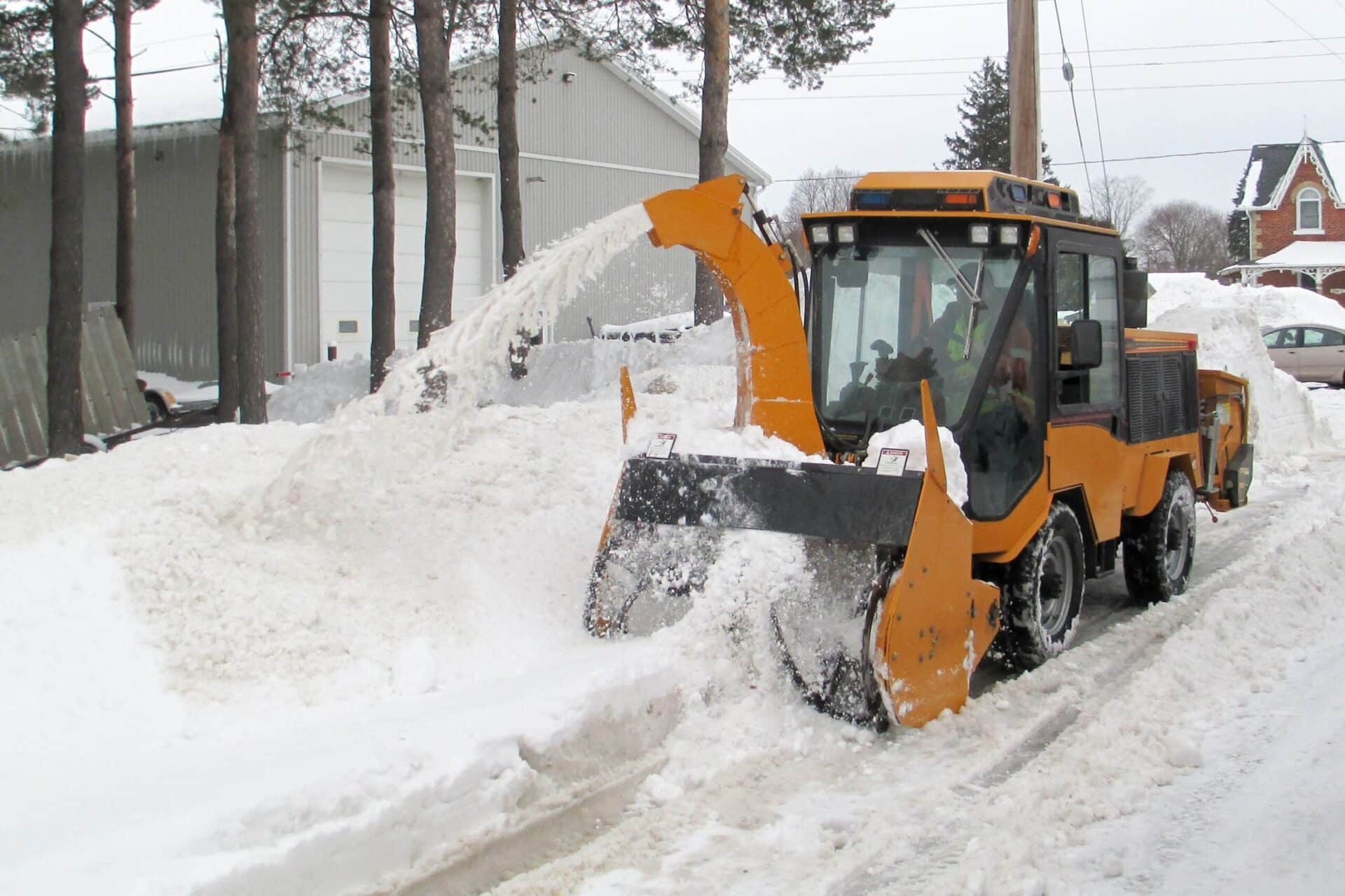

They are snow blower tractors, the blower only lifts about 10 inches off the ground.
The brand is Trackless we run them with 8 foot wide blowers

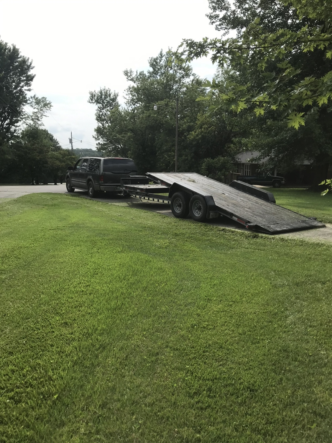

I’d buy a low profile tilt trailer to haul those and a second trailer for the larger tractor. I’ve had no issues loading rollers, lawnmowers or cars on the tilt deck without scraping. The approach angle of that is probably half what my mega ramp GN is. The other option that’s probably cheaper than a landoll is a paver trailer.

The Trackless Mt6s with the snowblower weigh about 7500 lbs
My issue is the load angle for the Trackless Mt6s the snowblower hits the ramps.
Im not sure if the gooseneck hydraulic tilt 12 foot ramps would allow me to load the snowblower tractors or if I have to go into semi trailer territory.
A lowboy doesn't work well for the Mt6s because they are only 4 feet wide. The tractors are too narrow to utilize the flip down ramps.

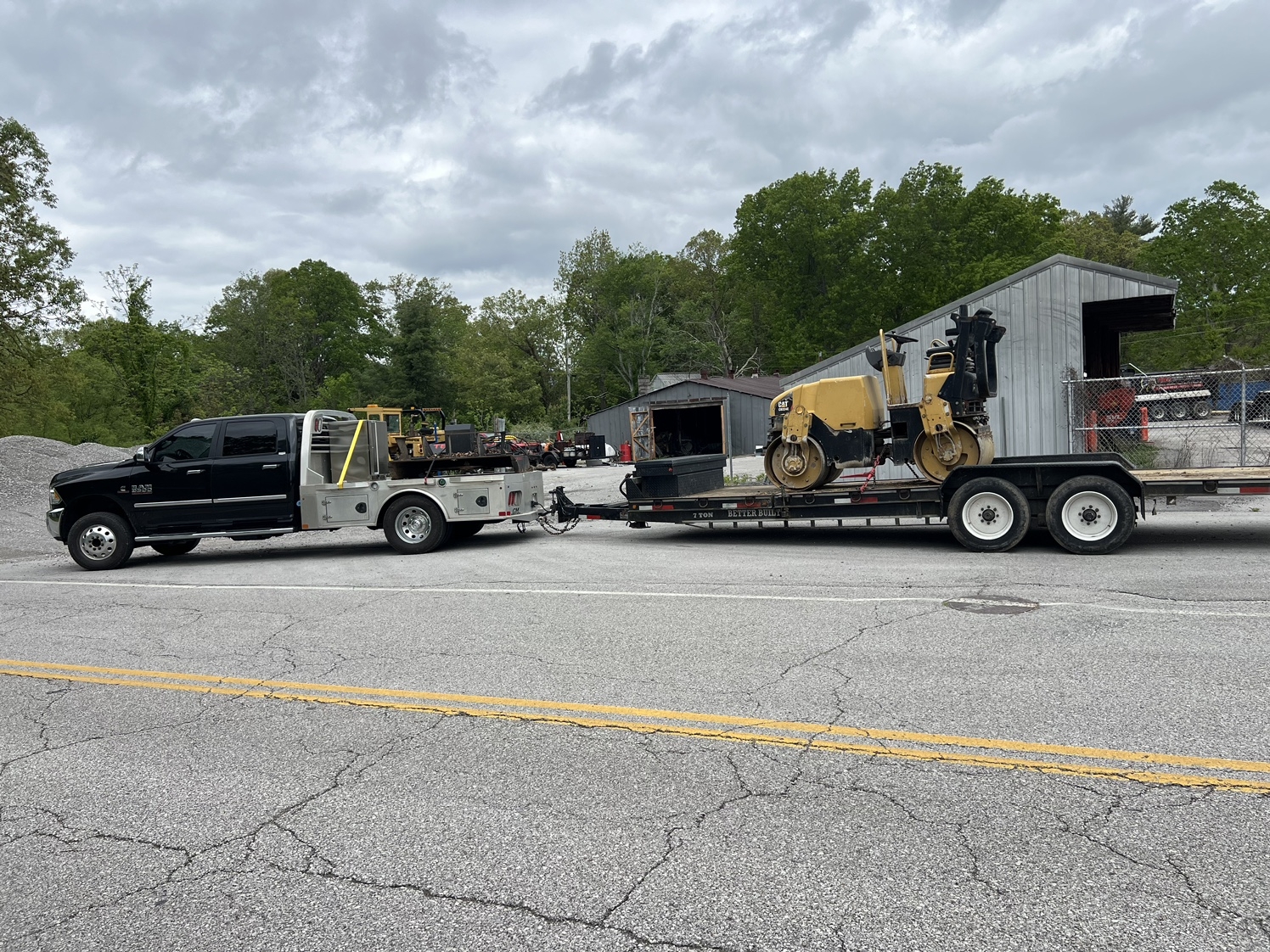

I use a 32' PJ low pro hydraulic dovetail to haul my antique fire truck. The load angle is less steep than ramps and if needed you can put the machine on the ramp and then raise the loaded ramp to get the machine onto the main part of the trailer.
I love the trailer and it is much easier to load/unload than other trailers I owned that used ramps.
