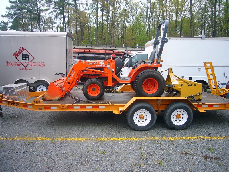

$1,000 is bottom of the barrel. Make sure you get something that will handle your tractor AND implements. And best if it's with implements hooked up.
attachment.php
My ride is sitting on my 18' trailer, and gives me room for expansion.
