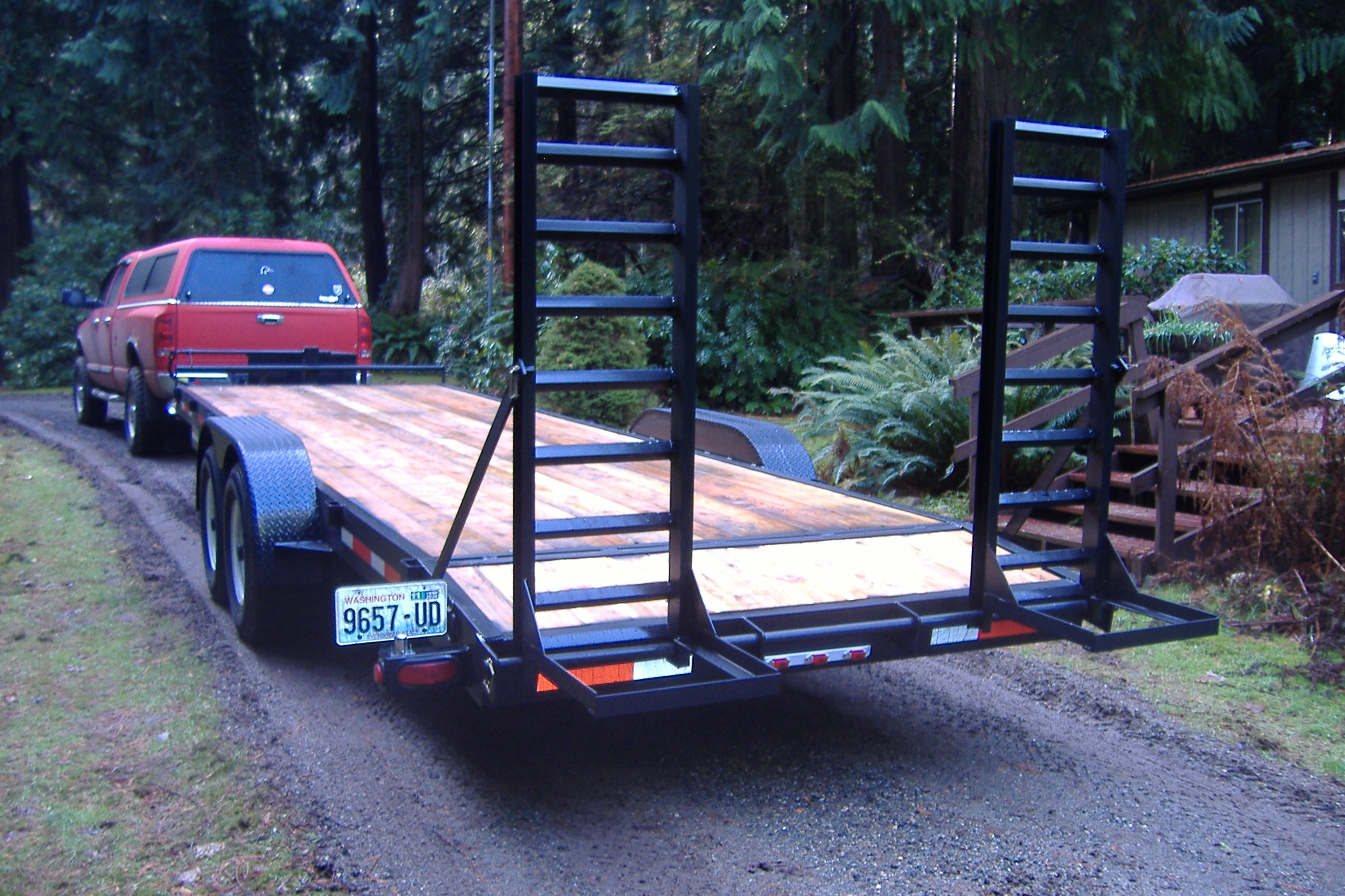

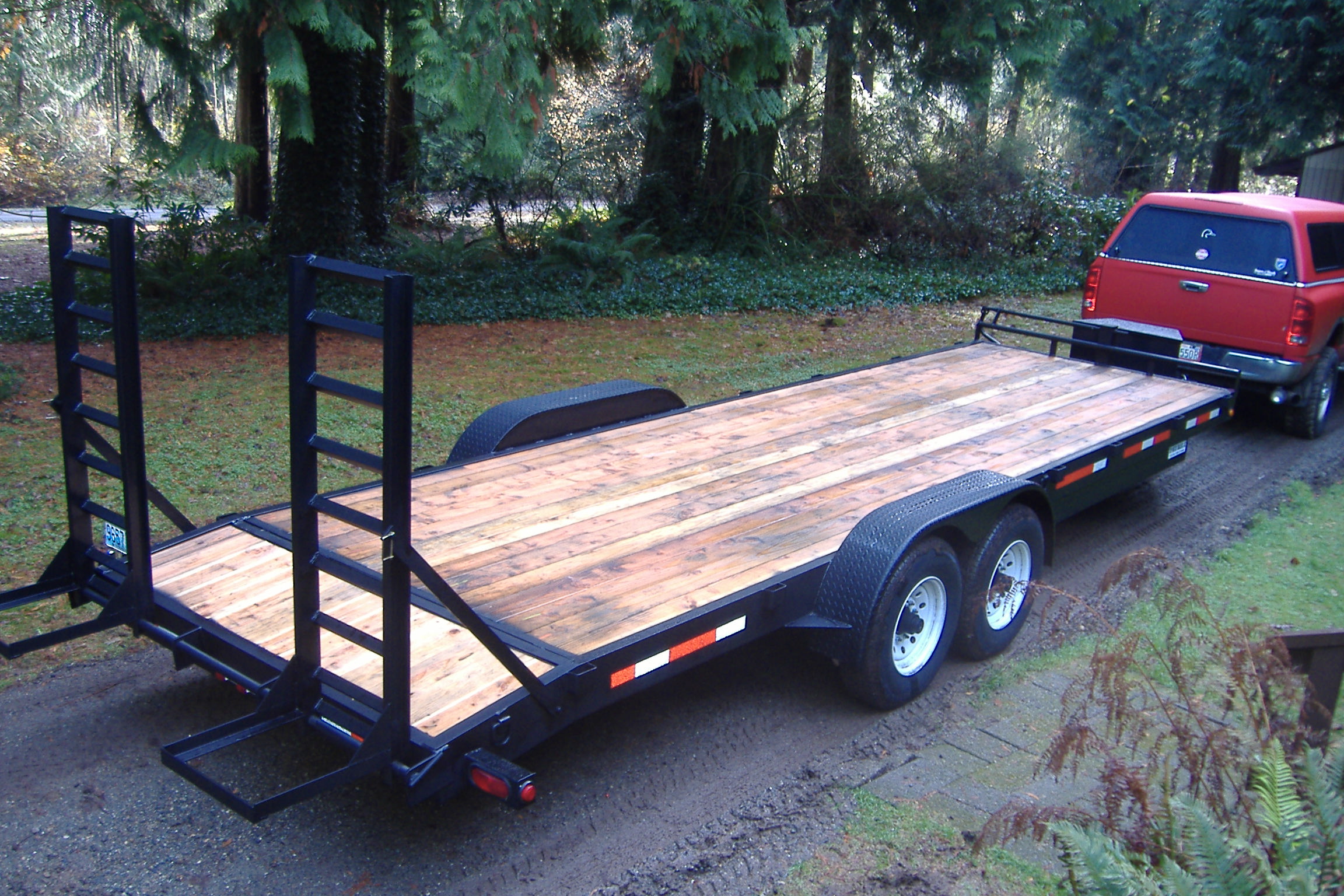

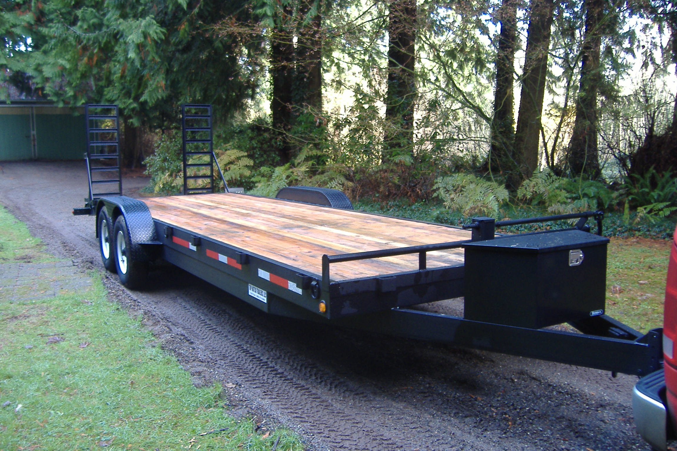

Here's that 24' bumper pull. I would think this would work for everything you have. The trailer as pictured weighs just a few pounds over 3000. That leaves me with 11,000 more pounds to throw on it. I haven't actually put the tractor on it, but will in the morning.
It is a Top Notch Trailer. They custom built it in 4 days flat, including running it through the state patrol inspection. $4700 + tax, but depending on where you are, it may be more. They are 120 miles from me and are down the street from a buddy that I don't see much (he's 120 miles in a direction I would not have any other reason to go) so I killed two birds.

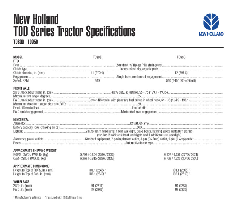

When I looked at the weight you it looked very light. So I looked at the weights for that model on the Tractor Data Site (tractordata.com) and this is what I found:
Weight: 6,107 (2WD ROPS shipping) lbs [2770 kg]
6,659 (4WD ROPS) lbs [3020 kg]
6,768 (2WD cab) lbs [3069 kg]
7,320 (4WD cab) lbs [3320 kg]
You need to be sure you get the trailer that has the right capablities for what you are going to haul. Also, make sure it is log enough for your needs.

Those are the same weights that NH shows on their website specifications for the TD series. I think he is way low at 4550lbs. A TN could weigh that much or more and it is smaller wheelbase and weight; even the larger TC's can go over 4200 lb. Then you have to add for wheel weights, loaded tires, etc.
I would double check the weight on the TD and get enough trailer.
