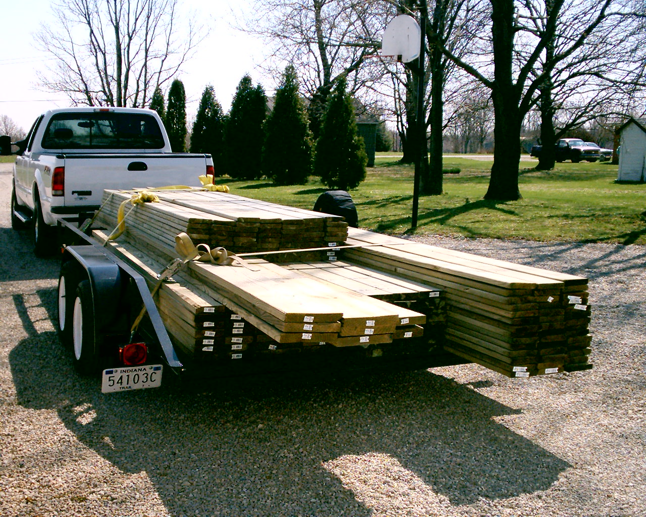

Baucom hit the nail on the head. I can buy and sell 16' 7K dual axle trailers all day long for under $1,800. Back when I bought mine in 2004 I paid $865 brand new but it had no brakes and used tires. Its 18' x 82" wide and came with a spare tire and mount and 5' ramps. I replace the tires just last year and put brakes on one axle myself shortly after getting it. It can carry 5,750# and is a well built trailer. Here is a pic.
Call these folks. I would not get a mesh gate, too much trouble in my opinion. I like ramps for situations like loading cars and trucks plus you would not be able to haul long lumber like my picture below.
http://www.gatormade.com/
Here is the 16' trailer http://www.gatormade.com/trailers/trailerpages/16ftdualaxelutil.php
Chris
