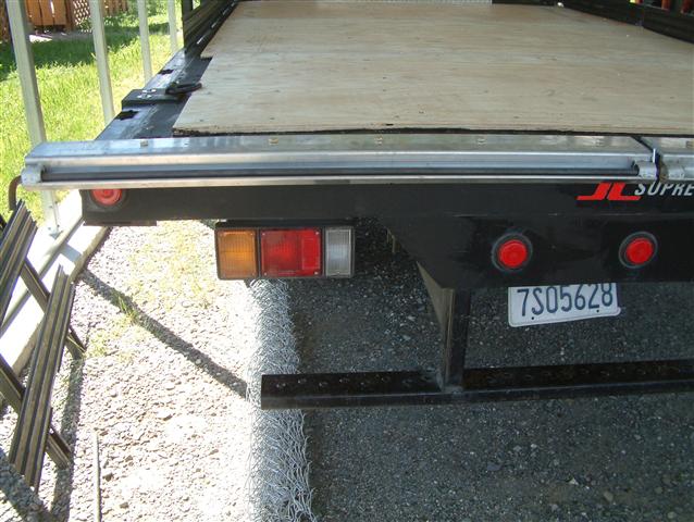

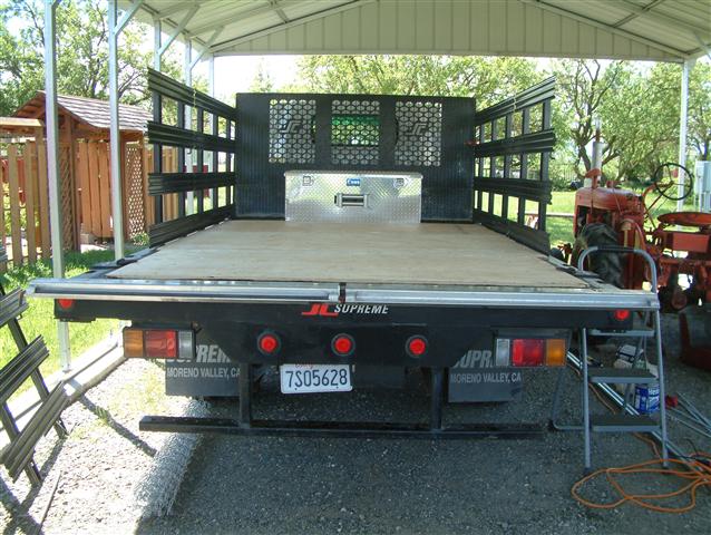

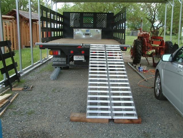

I went down this path recently--aluminum ramps: buy or build?
My conclusion--buy- you're not going to save as much as you would think building them yourself and you'll probably screw up to the point where you'll have weak welds where you can least afford them--in the main members.
Here are the ramps I use on my Isuzu NPR 14-ft stakebed.
16" wide x 10 ft long, weight: 48lb, 5000 lb load rating on the ramps.
Discount Ramps-$550 plus shipping.
5,000 lb Per Axle Truck Trailer Ramps
