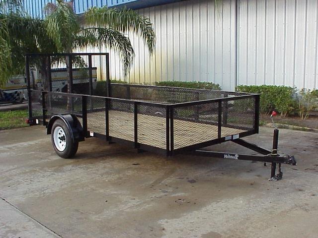

Looks like you're looking at a 7,000 lb. landscape trailer. We sell several brands and most are 16' long. First you need to check the length of you tractor and attachments to be sure they fit. Then there is one more thing to be concerned about. Most landscape trailers are rated to hold 7,000 lbs. but not one large tractor. You may find that the ramp is not heavy enough to hold your 5500 lb. tractor. Check the ramp. If it's made from angle iron and has only 3-5 angle braces in it, running front to rear, and then covered in screen mesh (3/4 #9 Expanded Metal) then you may find the ramp will bend or at least the screen will start to sag....
Just remember a landscape trailer is built much different that a equipment trailer....
Attached is a typical landscape trailer.
Thanks
