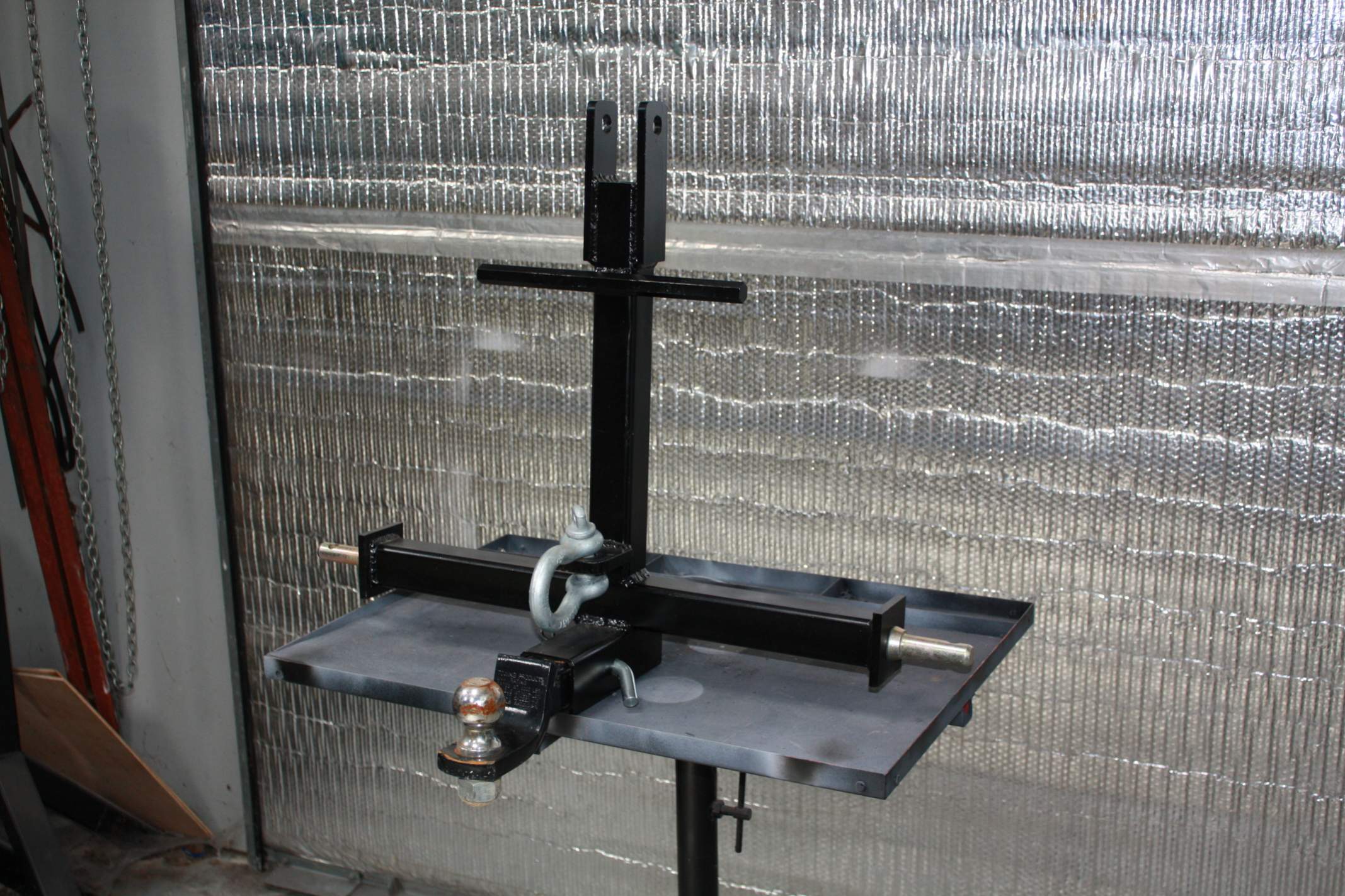

Here's the 3-point trailer mover i made. It has a receiver hitch for future projects. It was easy to make, and cheap (made it from scrap). I have a bunch of trailers, including a dump-trailer, and light-weight uility trailers. It works great on all of them. I kinda copied the idea from you guys, but put my own ideas into it to. Bud approved.
   / Trailer mover with receiver hitch #2
Looks like a nice job. What's the upper horizontal bar for?

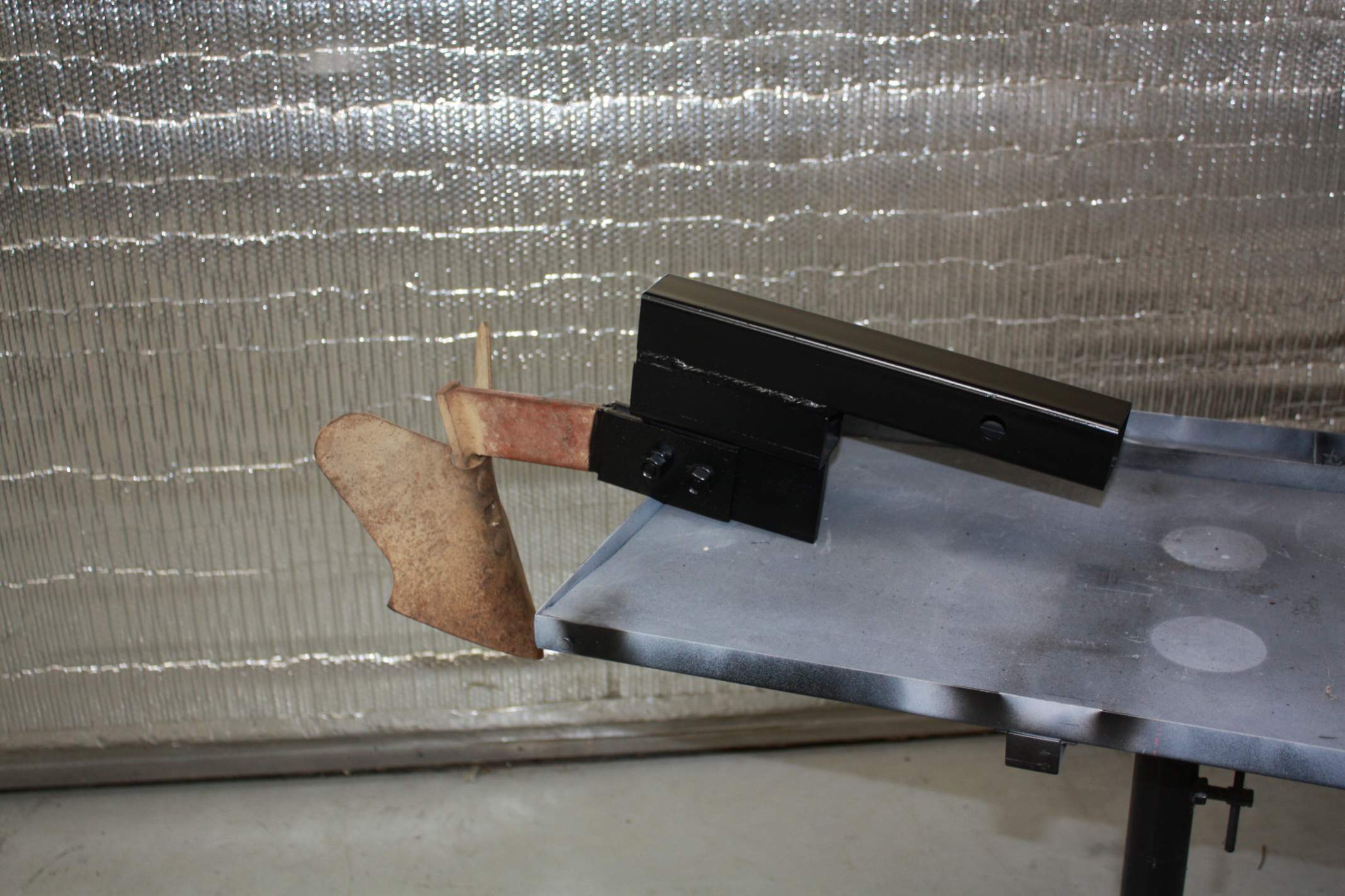

I made this to lay-off rows in my garden. It fits right in the reciever, hope it works. I made it with cut-offs also, except for the plow. The hitch has endless uses.
Something to wrap chains, straps around. Handles to move, and put it on.
