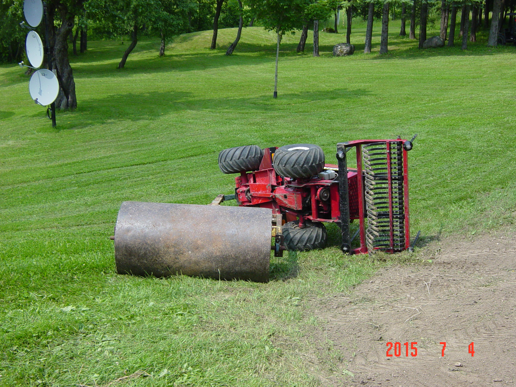

I had a roller push over my Steiner on a hillside. I was not using duals which probably would have prevented the roll over. The Steiner/Ventrac are a good sturdy machine, but not that heavy, and will easily pull something bigger than the tractor.
   / Trailer mover vs rear hitch on Ventrac #9
I would guess you lost it going down hill right? and started to slide in the grass?.... jim
   / Trailer mover vs rear hitch on Ventrac #10
EXACTLY. I have pulled this roller, which maybe is a little large (filled with stone) on a number of occasions. I was rolling seed, not paying enough attention to the dynamics, and maybe in a little too much of a hurry. Basically, I attempted a turn without having come to a dead crawl.
