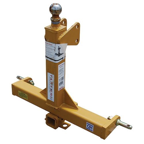

   / Trailer Mover that fits quick hitch? #2

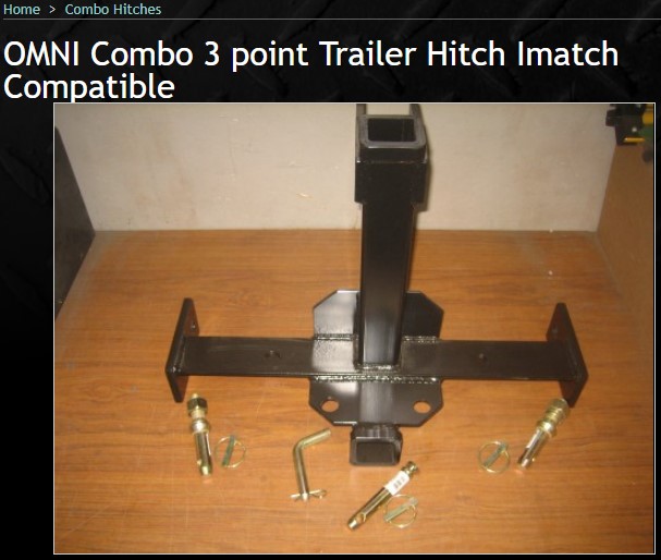

   / Trailer Mover that fits quick hitch? #6
I'm finding varying widths for trailer movers. I'm looking for one that has the receiver on the bottom and the goose neck on the top, and is the correct width to fit a class 1 quick hitch. It may not exist, and I can modify one if needed, but would rather just buy one and be done.
Let me know if you are aware of anything which will work. Thanks!

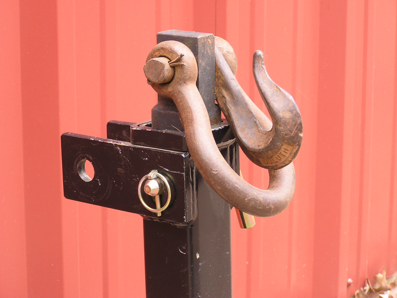

Here is one that will work and has many options for the top receiver: OMNI Combo 3 point Trailer Hitch Imatch Compatible - OMNI Mfg LLC
Some of my options for the top receiver:
   / Trailer Mover that fits quick hitch? #7
This should be your quick hitch numbers...
B1 and C1 are your critical numbers... General your pins (A1) are replaceable or if to small can be sleeved....
Dale
   / Trailer Mover that fits quick hitch? #8
I have one of those Omni units and I use easily with my PAT's Quick Hitch. Sure like both Pat's and the Omni. Both are well made.
