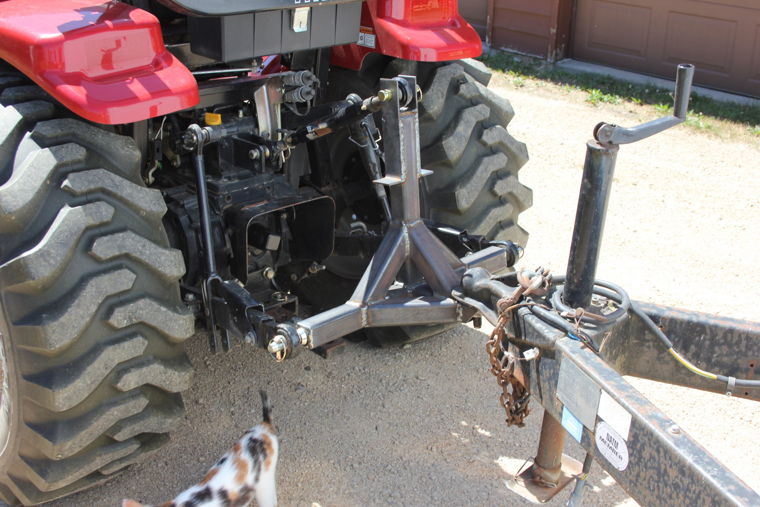

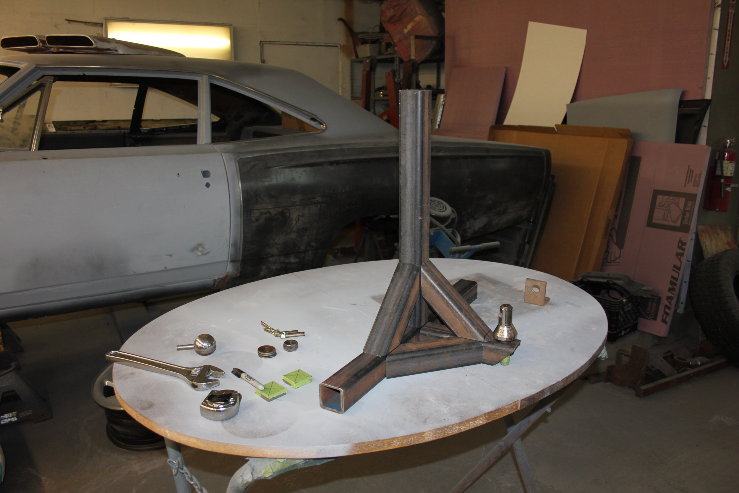

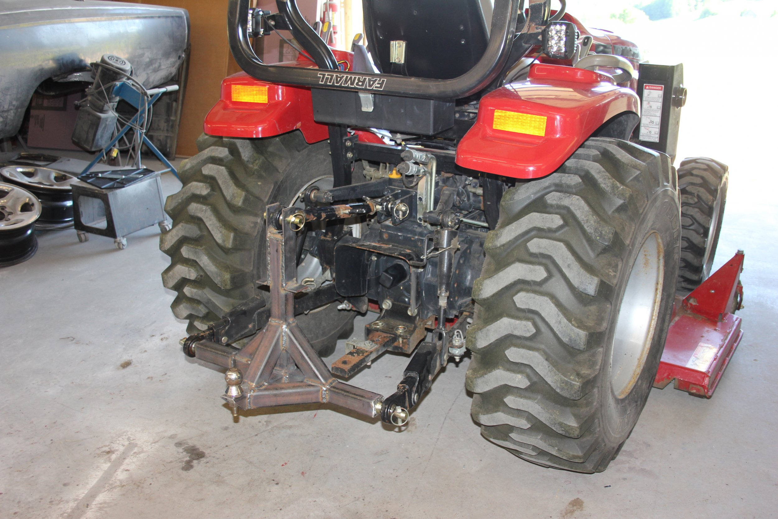

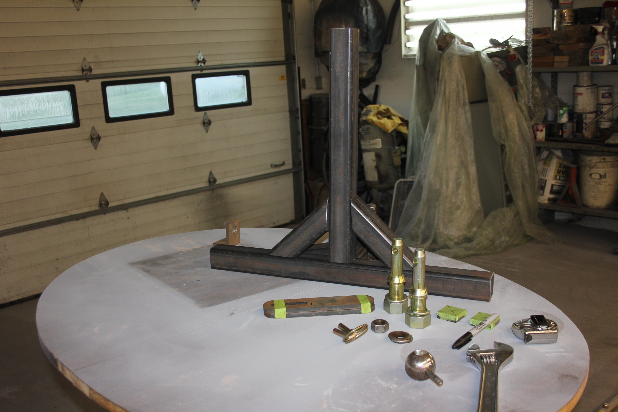

I have wanted to finish this trailer mover and now I have almost all the pieces to finish this. should be done this week end. want it to move my car trailer when mowing. built by inventory. but with new pins.

Nice...
Required finish product pictures...

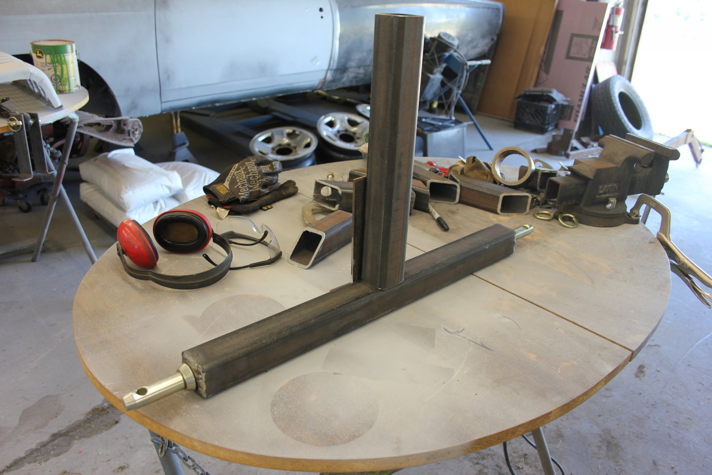

as promised. thou not painted yet. I really like it. took a bit to decide on how I wanted the lower pins. and welded the cat3 pin nuts right in the lower tubbing. just had to grind 2 of the points down on the hex nut. worked nice! I have to [paint it. but I wanted to add chain hooks to the 90 deg tabs on the upper arm. ran out of time to finish.

Looks great! Good and stout for sure.

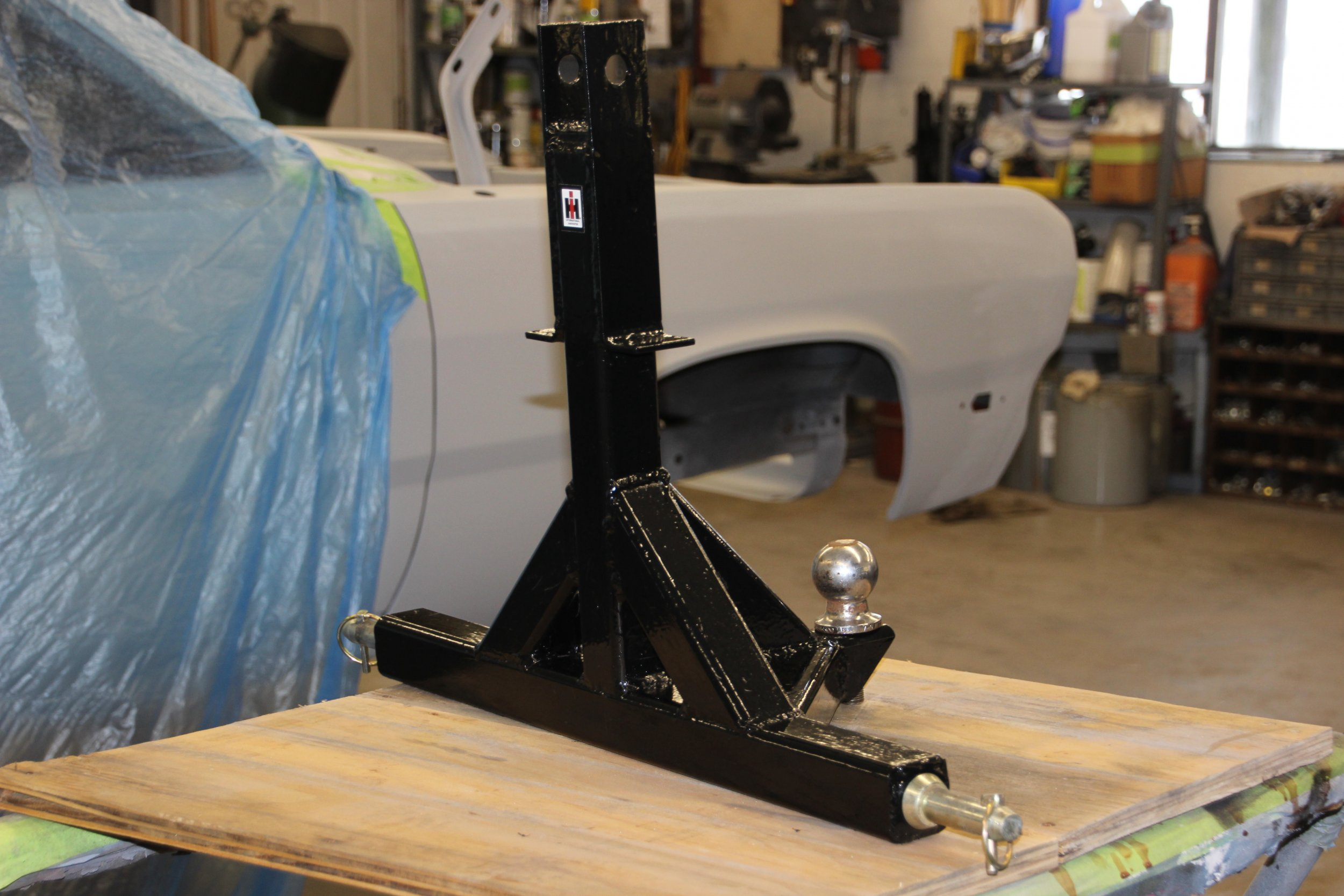

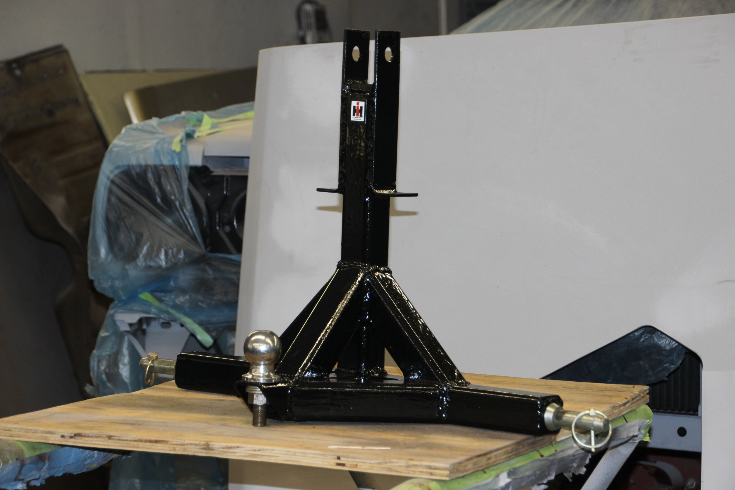

I was able to get it painted on Christmas vacation.

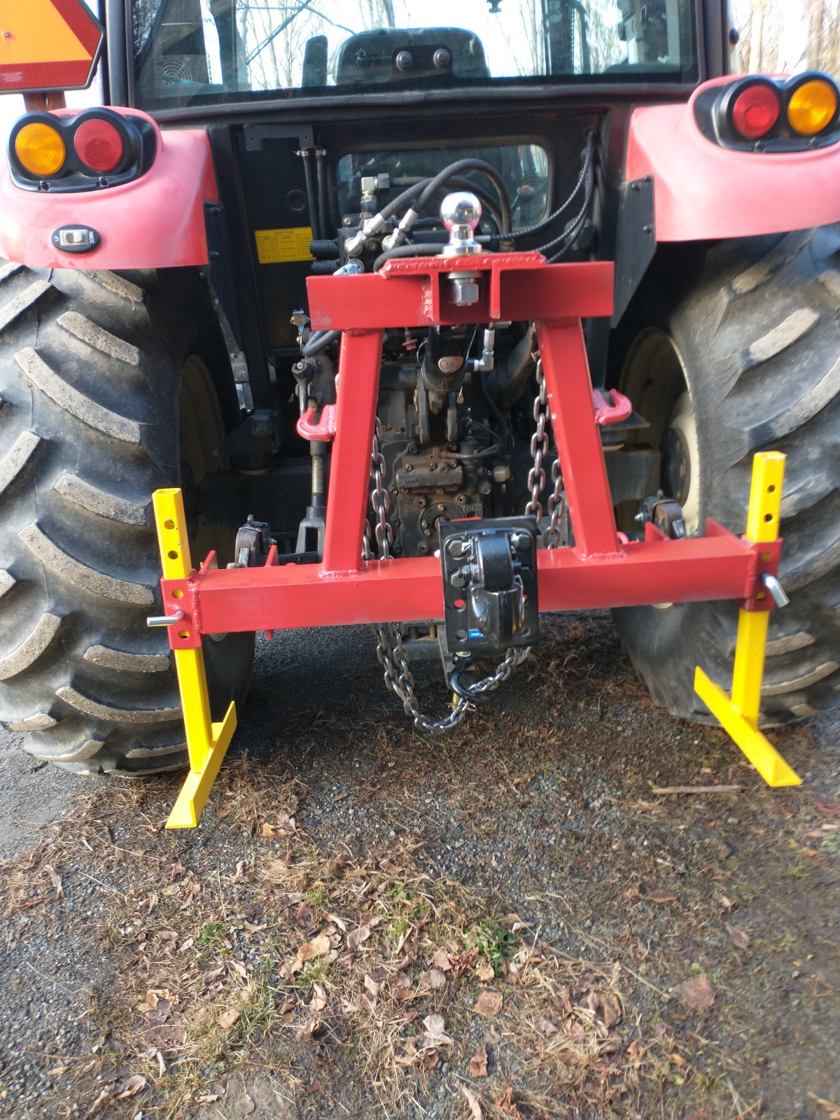

Looks good, when I did mine I made it so it could handle a gooseneck also.

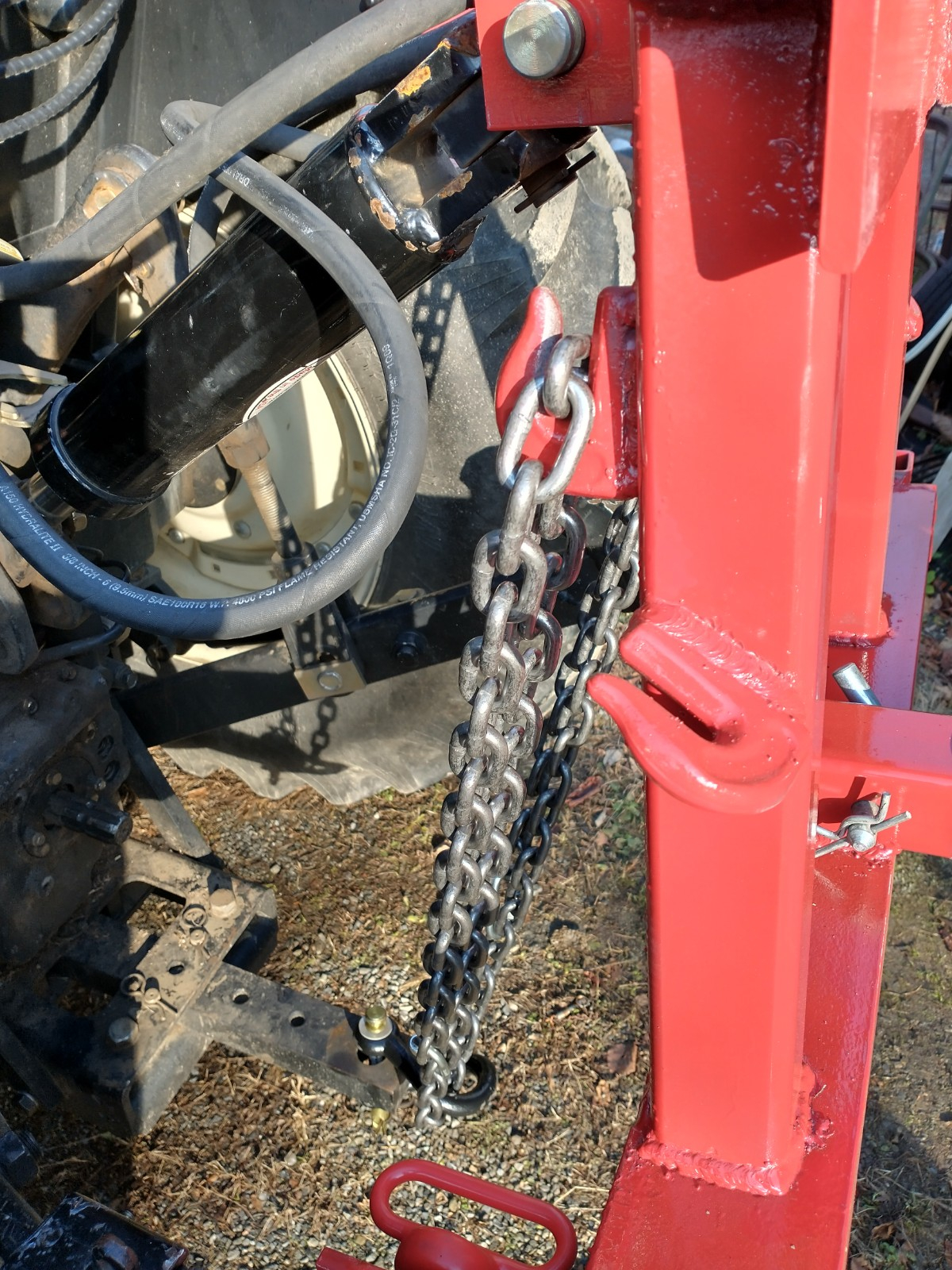

You mentioned chains, are they safety chains for the trailer, or chains to prevent to much upward undesired movement.
The yellow legs are stands for when not in use.
These chains are to stop any upward travel before damage occurs.
