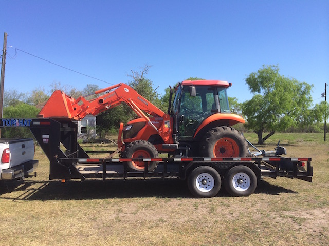

Hi,
I have a 2009 20' Top Hat Gooseneck Trailer that recently started locking up all four tires anytime I apply my trucks brakes -- even if I just barely tap the trucks brake pedal or have my brake switch turned down to zero it still locks them up instantly. It will keep the trailer brakes locked up until the truck's brakes are released even if I've come to a complete stop.
If I operate the manual override on the switch the brakes do not apply at all and after a few seconds the truck's info center will say "Trailer Disconnected". Seems to be when the brake lights turn on, the brakes lock up, otherwise they don't work. I haven't had time to go over all the wiring yet.
Can anyone offer some help or suggestions on where to check first?
Thanks!
