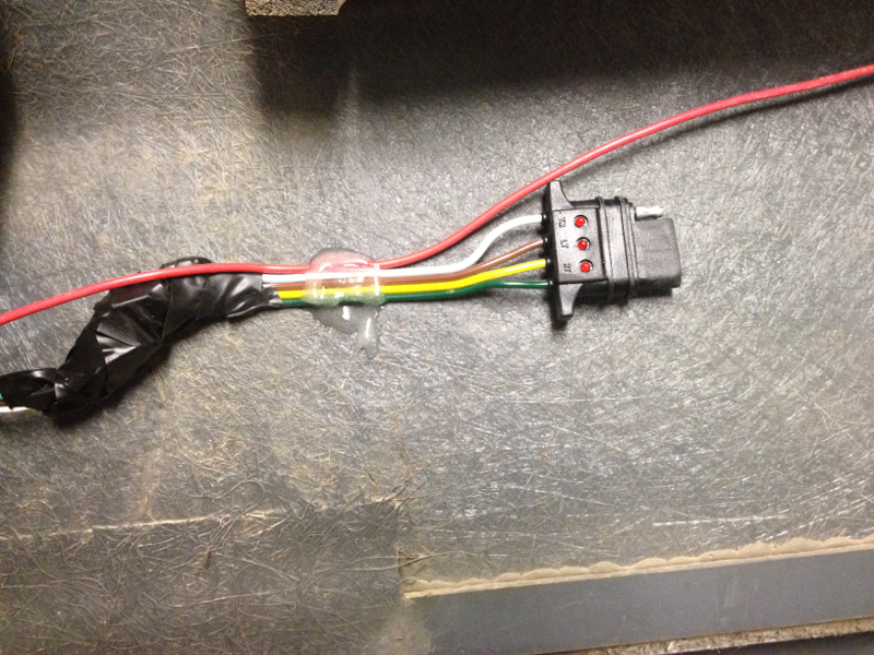

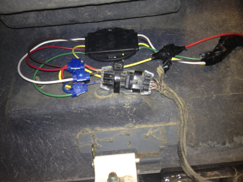

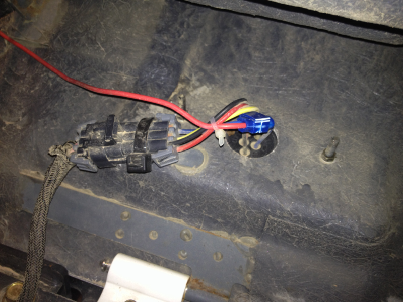

Going to pull trailer in parade and needed trailer lights so I could drive it safely to town. Entire light assembly is attached to cover on back of machine and it will still come off without interfering with anything.
FYI. Blue is blinker yellow tail light and red is brake. Black ground. Used converter from Oreillys and when towing will use extension to run back to trailer. Should work well.
Also permanently installed power inverter behind passenger seat with 200 amp fuse that has been great.
