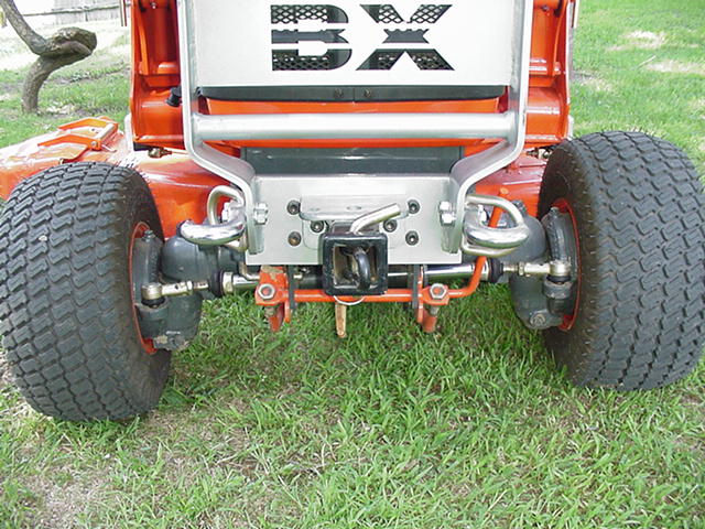

I also put the receiver in the front. much easier to operate.
