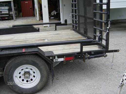

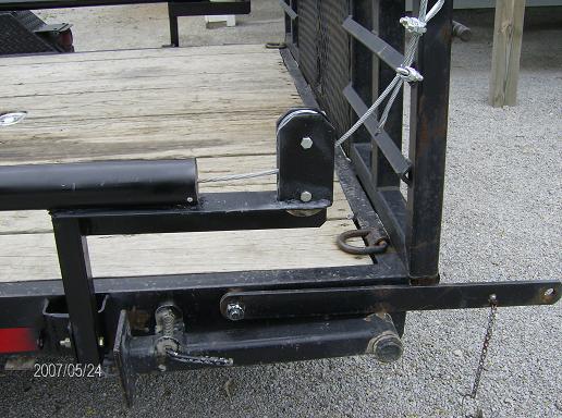

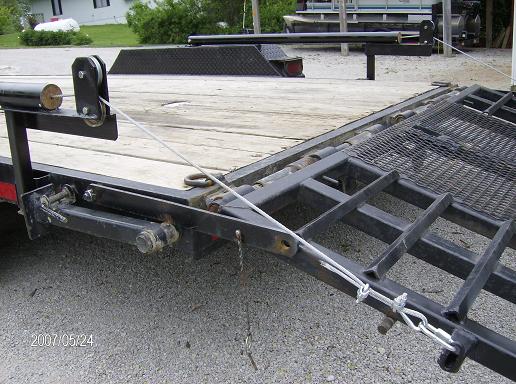

Personally, I don't like the exposed springs. I made mine with heavy garage door springs inside steel exhaust pipe, with the saftey cable through the springs. I think I spent around $70 plus labor.

Get the heaviest springs you can find, Lowes, Home Depot, lumberyards, etc. I used garage door pulleys, & exhaust pipe from a local muffler shop, just big enough for the springs to fit into. Cable goes between pulleys (red arrows), lower pulley is recessed down. My gate is very heavy to accommodate a 7500# tractor, it also has two torrsion spings on the hinges. These are all the pictures have at this time. Any questions, I will try to answer them. ~~ grnspot110
