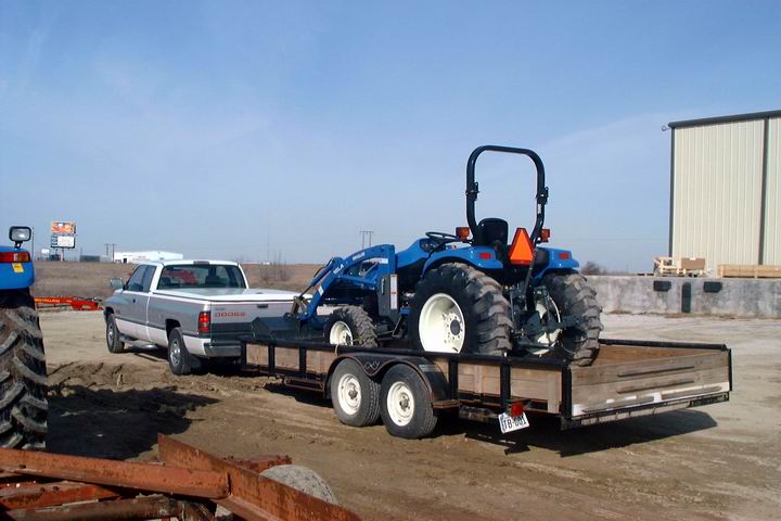

Looking at tractors; a couple New Hollands have caught my eye. Would a TC30/33/35 or 1510/1520 fit my 7000lb trailer? It is only 16'; those might get a little long. Wondering about weight though. One place has some 1510 and 1520 harvest returns.

That should be more than enough trailer.
   / trailer for TC33/35 or 1510 #3
I have a TC33D with Loader and Backhoe w/subframe and it fit on my 7000lb GVW car carrier trailer. It fit fine with the backhoe swung to the side.

I too have a TC33D with a loader and backhoe sub frame mount and it easily fits on my 16 beaver tail 10,000lb GVW equipment trailer. I would think yours should fit also.

Robert, the bare TC35 without a loader or filled tires will weigh around 3350 lb. The loader will add another 1100 lb. The addition of a boxblade puts you at the limit of a 7000 lb trailer. Here is a picture of my TC45D when I took delivery. My trailer is 18' long. I've hauled mine with a 5' cutter on the rear and it hangs off the trailer. I think the TC35 and loader would fit just fine on a 16' trailer, but anything much more than a boxblade in the rear will make it too long and too heavy. If the rear tires are loaded, you'll be overweight without the boxblade.
EDIT: My comments relate to the Class III TC35. The Class II tractors will be lighter and shorter. I don't have definitive info for them.

I have a TC 34 which is a class II (same as TC33) that I haul on a 16 foot tandem axle trailer, rated at 7000 lbs. With the FEL bucket resting flat on the trailer floor the rear wheels are parked in the space between the two axles. There would be room for a rear or box blade behind tractor but if you had a bush hog mounted it would overhang the rear of the trailer probably by about 3 feet. As far as weight the trailer easily carries my tractor (tractor, FEL and loaded rear tires), probably about 4000 lbs.
I have a 4 foot loading ramp made from 2x2 tubing that makes it real handy too load. As a suggestion I put a 3 ton jack stand under rear edge of trailer when I load and unload tractor. This keeps the rear wheels of my Dodge 1500 firmly on the ground.
