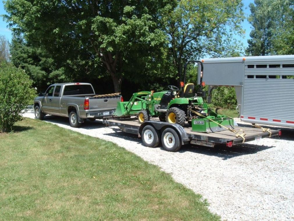

Even a little J.D. 2305 takes up a lot of space. With the rotory cutter on it, it has to be all the way to the front to balance the load properly. If you don't get the tongue weight right, they don't pull well and can be dangerous. Plus it is nice to have a little extra room for strapping down another attachment.
This one is 18'
