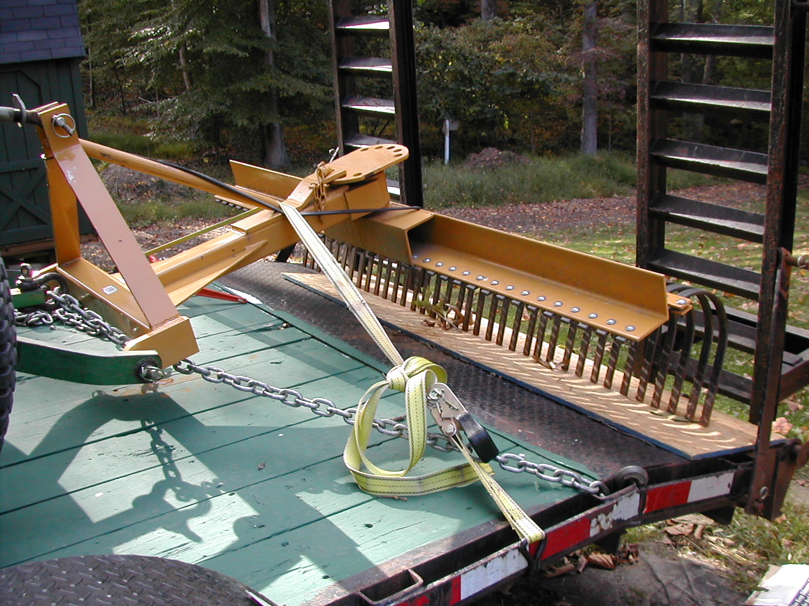

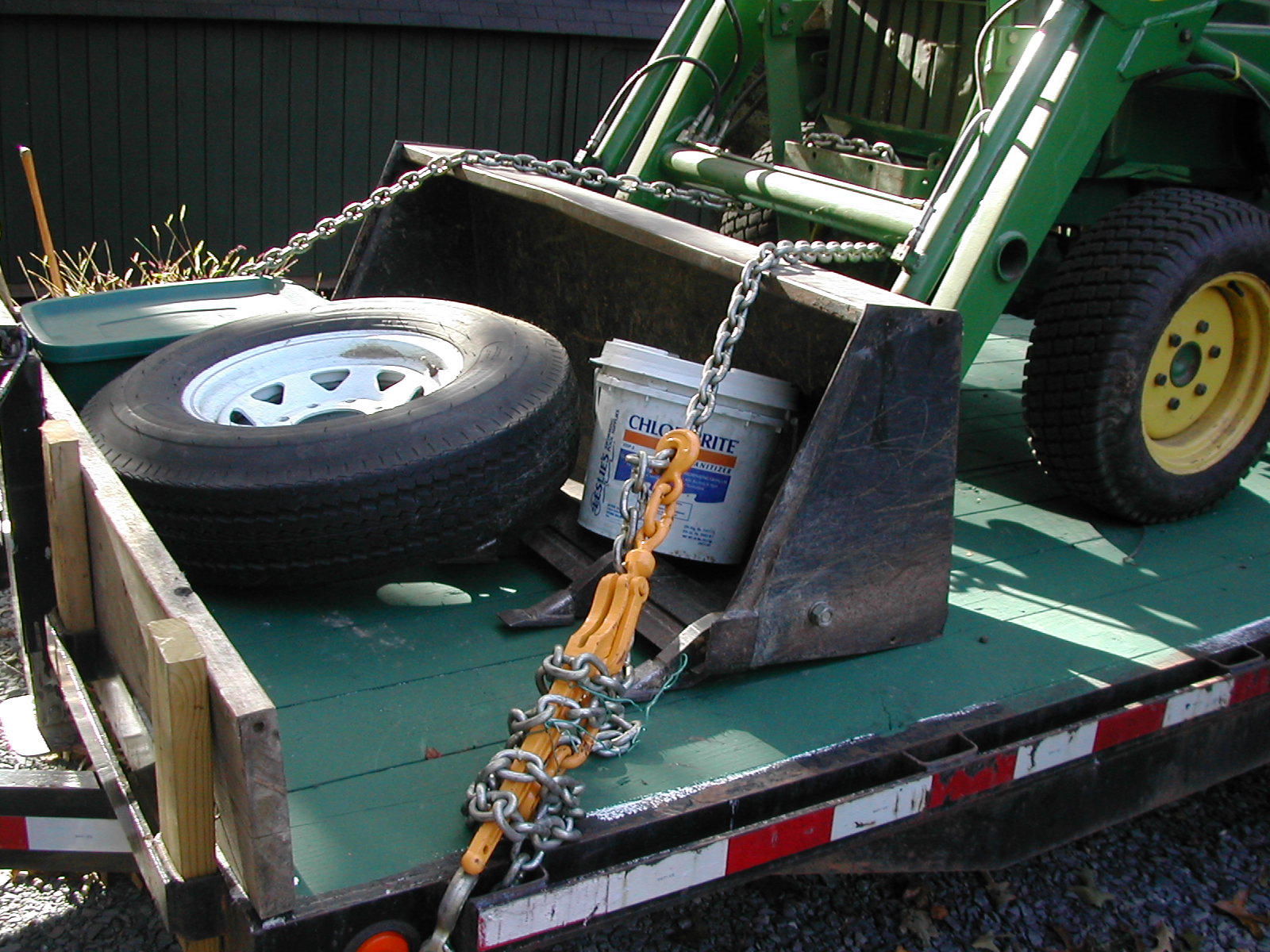

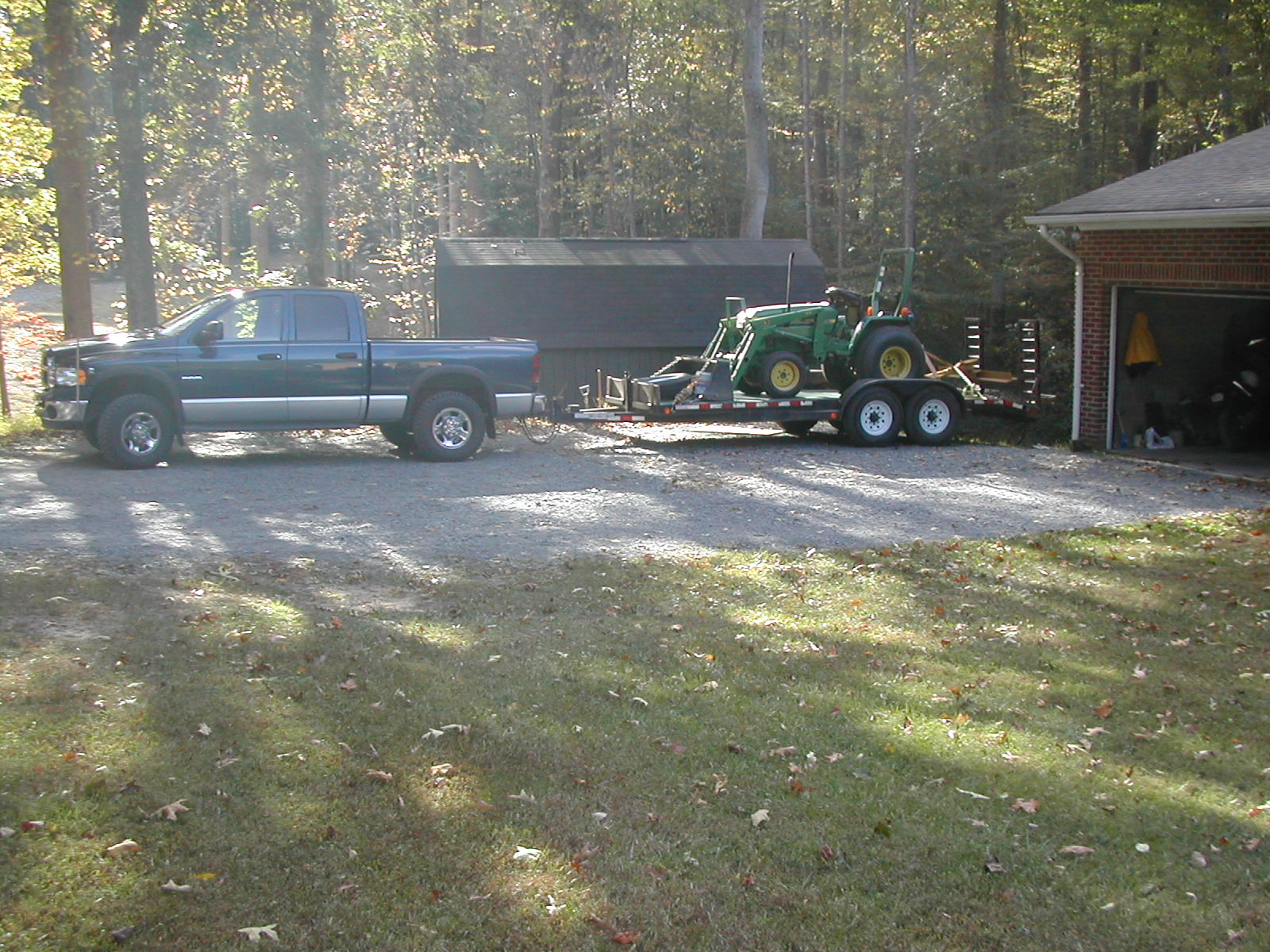

I may have posted this before. My tractor on my 12k 16+2.5 trailer. Note how long things are. I also had too little tongue wt in these pics so made adjustments. Bottom line is get a long fender trailer with a beaver tail and you won't regret it. Need a deckover?? Borrow one :)
