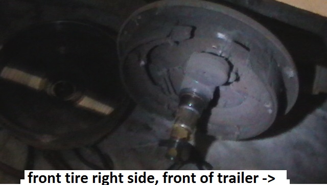

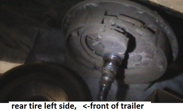

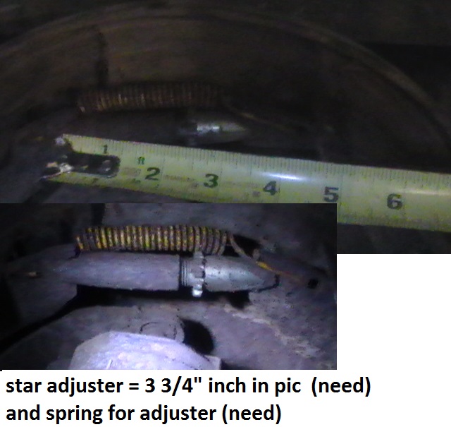

heard some dragging, pulled wheel. and found out the spring and the star adjuster broke and came off and both got mangled pretty good.
went to see what i could find and have different measurements for star adjusters.
how determined what length i need? 7", 10" 12"
never realizing it before, when trying to find above came across below video. and who ever built the trailer, put the magnet on top. and the star adjuster as well on top, and the lever for the magnet is facing backwards not forwards, and the short pad of the 2 drum pads is facing rear ward.
will be pulling all 4 tires and brakes and swapping them side for side.

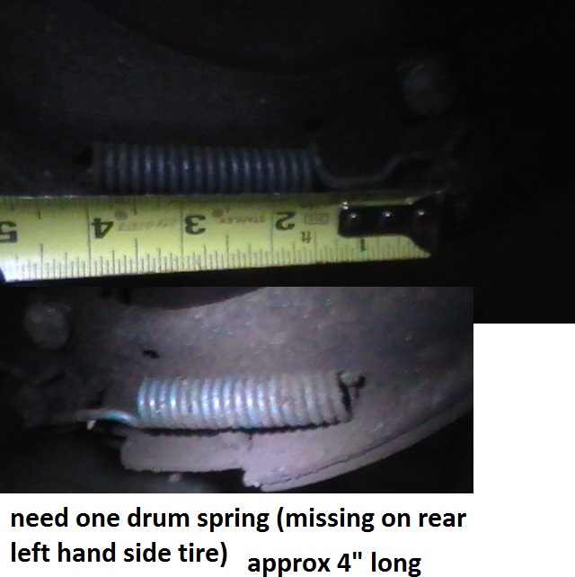

glad i decided to take other side off tonight, need another spring as well *doh*
trailer front tire right side.jpg trailer rear tire left side.jpg trailer drum spring 4 inch.jpg trailer star adjuster.jpg
and to confirm looks like i will need to pull all 4 brakes off the axles and swap everything around.
