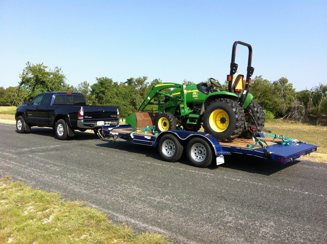

Are 16ft tandom car haulers with brakes on the rear axel safe to move a small tractor ? I would think that one with brakes on both axels got to be better .
Here's my small truck pulling a relatively small tractor on an 18' car hauler with brakes on one axle. I'm well within the max. tow capacity of the truck and have a good brake controller, a weight distributing hitch, and everything works well for my setup.
You'll need to run the numbers for your setup to answer your question. :)
