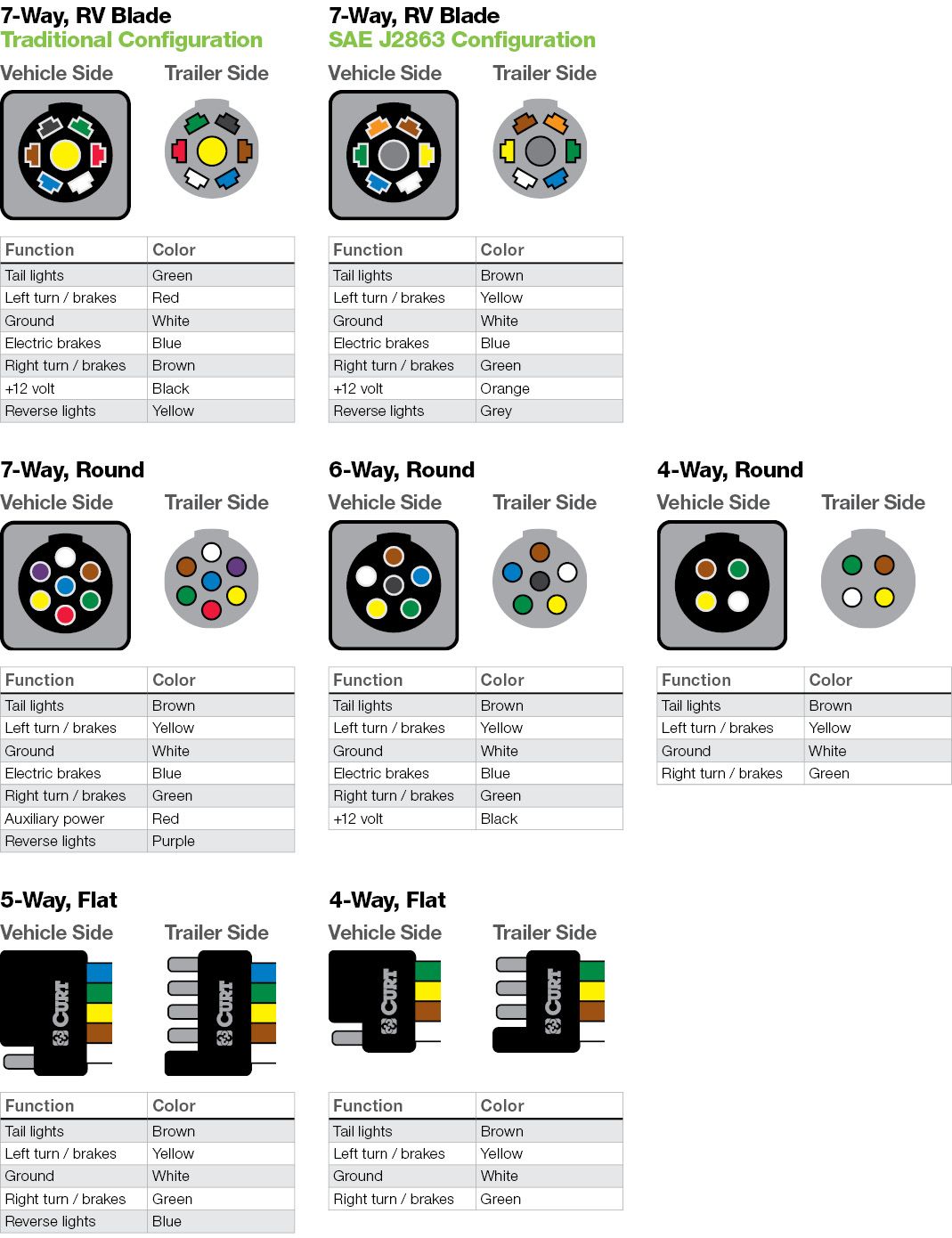

Most everything for the general public has transitioned to the 7 way flats,
that said there are still lots of applications with 6 or 7 pin rounds and some different configurations.
this page has many of them it does not show the two different configurations for the 6 and 7 pin rounds.

If you mess with the wiring at all on a trailer or tug, convert it to the 7 pin flat RV style. Maybe a 4 pin for a small trailer. It's easy to get an adapter for 7 pin & more compatible with everything in the long run.
I converted my old used 14k tilting deck from a 6 pin to 7 pin as soon as I got it. When I inherited a 1k 13' Boler RV trailer I converted it from 4 pin to 7 pin. It never had brakes, but 12v constant power was nice & it was more standard.
