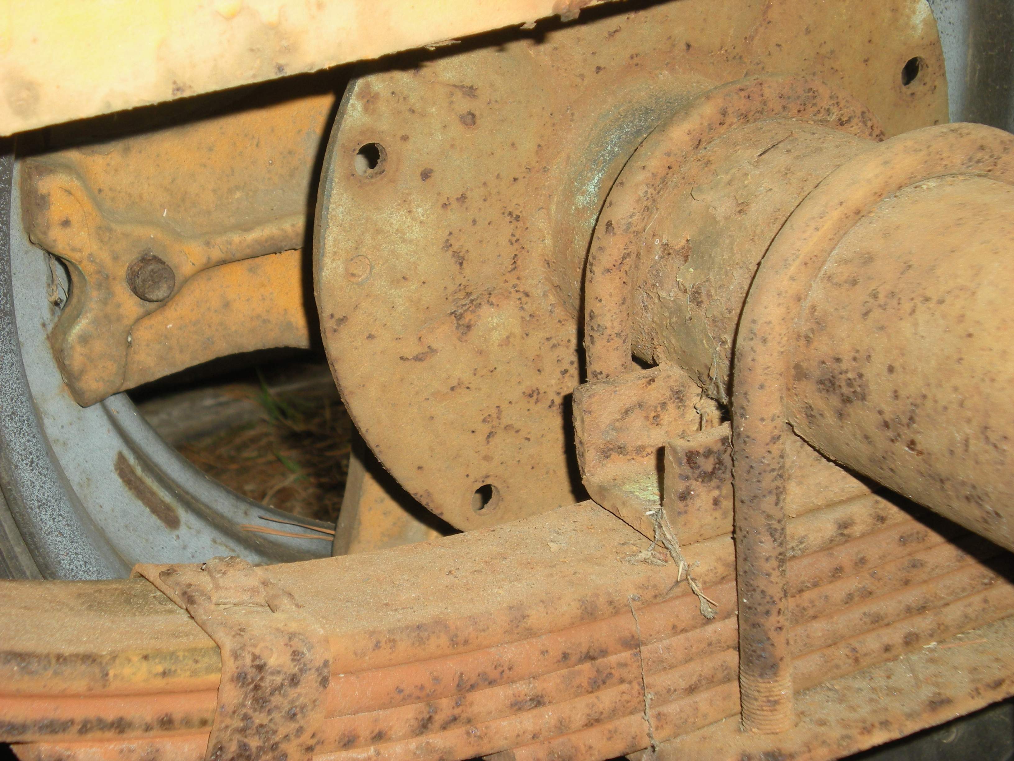

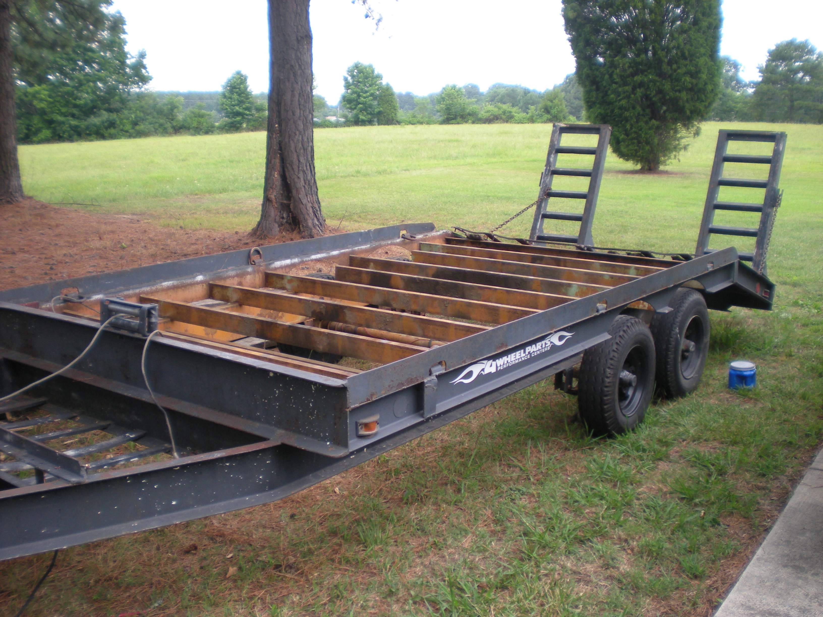

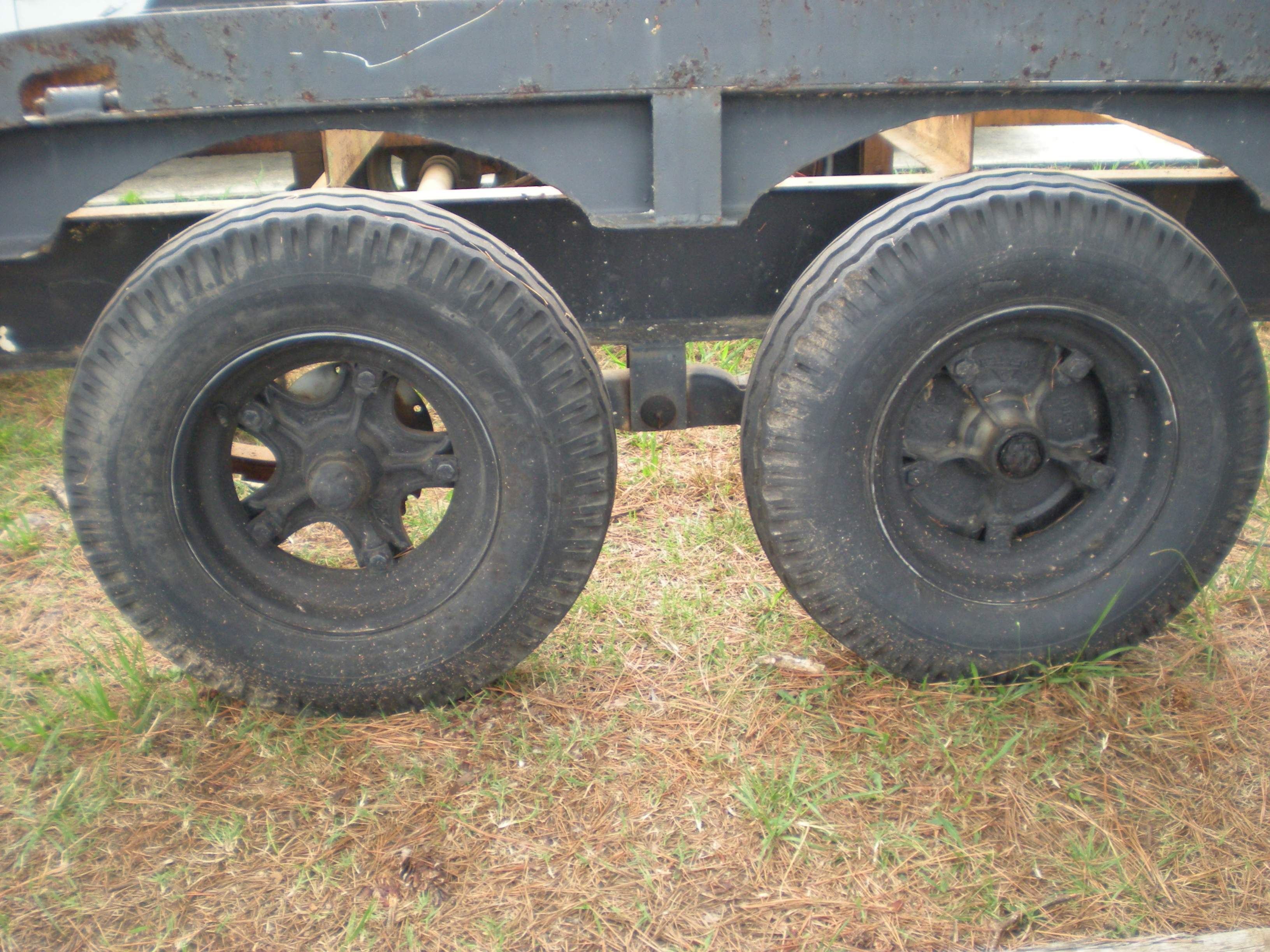

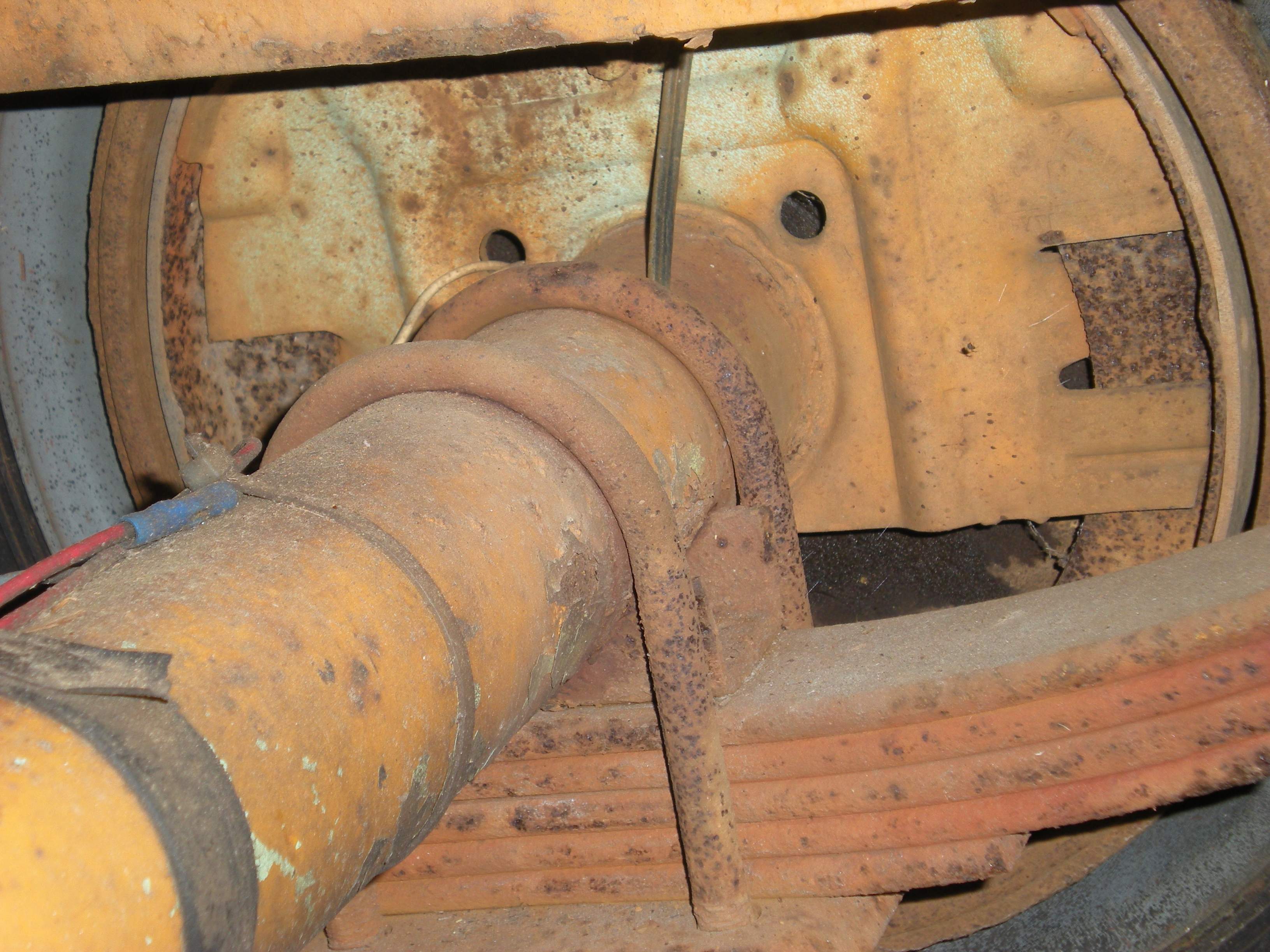

I just bought an older deck-over trailer to haul my tractor and other heavy stuff. The trailer was made by Hudson in 1978, but it seems well built and actually heavier built than what I致e seen new at the dealers. I removed the old wood deck and figured now is the time to rewire the lights and brakes. It has brake hubs on the front axel only and I would like to add brakes to both, if it痴 not going to be too much trouble or expensive. The trailer has mobile home style axels and wheels, which I don稚 like but probably won稚 spend the money to convert all four to standard style wheels. My question is what do I need to get working brakes on both axels? The one with a brake hub may be repairable, but it looks like it痴 been disconnected for some time. The rear axel has a flange that the front axel doesn稚 have, but it doesn稚 look like a normal four-hole flange you see on most axels. Can brakes be installed on both axels and what would it take. I've attached some pictures that hopefully will help to see what I'm working with. Thanks in advance for any help.

Thanks Radio Man. I stumbled on this one. Looks like a nice old trailer and man, that thing is built like a _________ brick house. Good find. As for the axles it looks like they welded the backing plates on the front axle and the rear axle still has some kind of odd ball flange. I would bite the bullet and put new axles with regular wheels and tires. But money can be a problem so If you want to use what is there I would first jack up the axle with the brakes on it. Apply 12 volts to the brakes, wires do not matter which is positive or negative, and see if they even work. If so, take apart, clean and inspect, then put them back together and use it with one brake axle. It will probably cost too much to convert the other axle to brake so when its time to upgrade tires, bearings/races, or something else bite the bullet at that time and change it over to modern axles.
